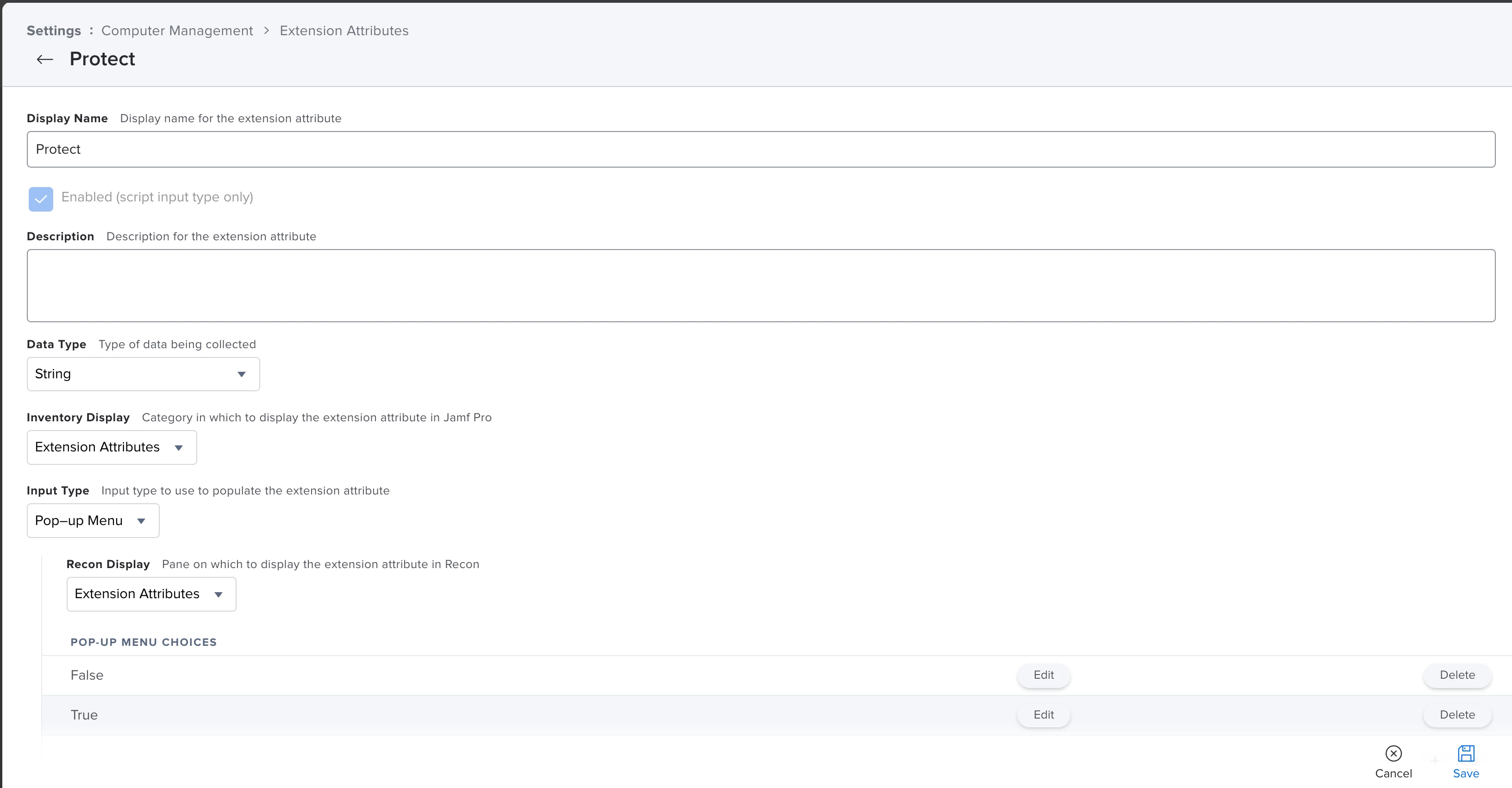

Step 1. Create an Extension Attribute Exactly as it is Depicted Below.
Display Name "Protect", Data Type "String", Inventory Display (Wherever you Want), Input Type "Pop-up Menu", Recon Display (Whatever you want), Pop-up Menu Choices "True" & "False".

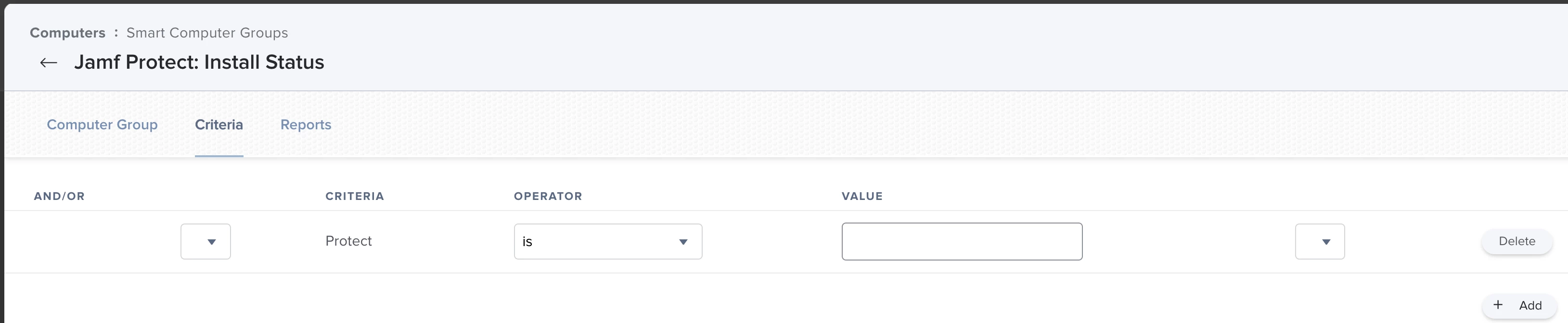

Step 2. Create two Smart Computer Groups Exactly as Depicted Below. 
Smart Computer Group 1: Criteria: "Protect" (The Extension Attribute you just made), Operator "is", Value "False" 
Smart Computer Group 2: Criteria: "Protect" (The Extension Attribute you just made), Operator "is", Value "        " (EMPTY)

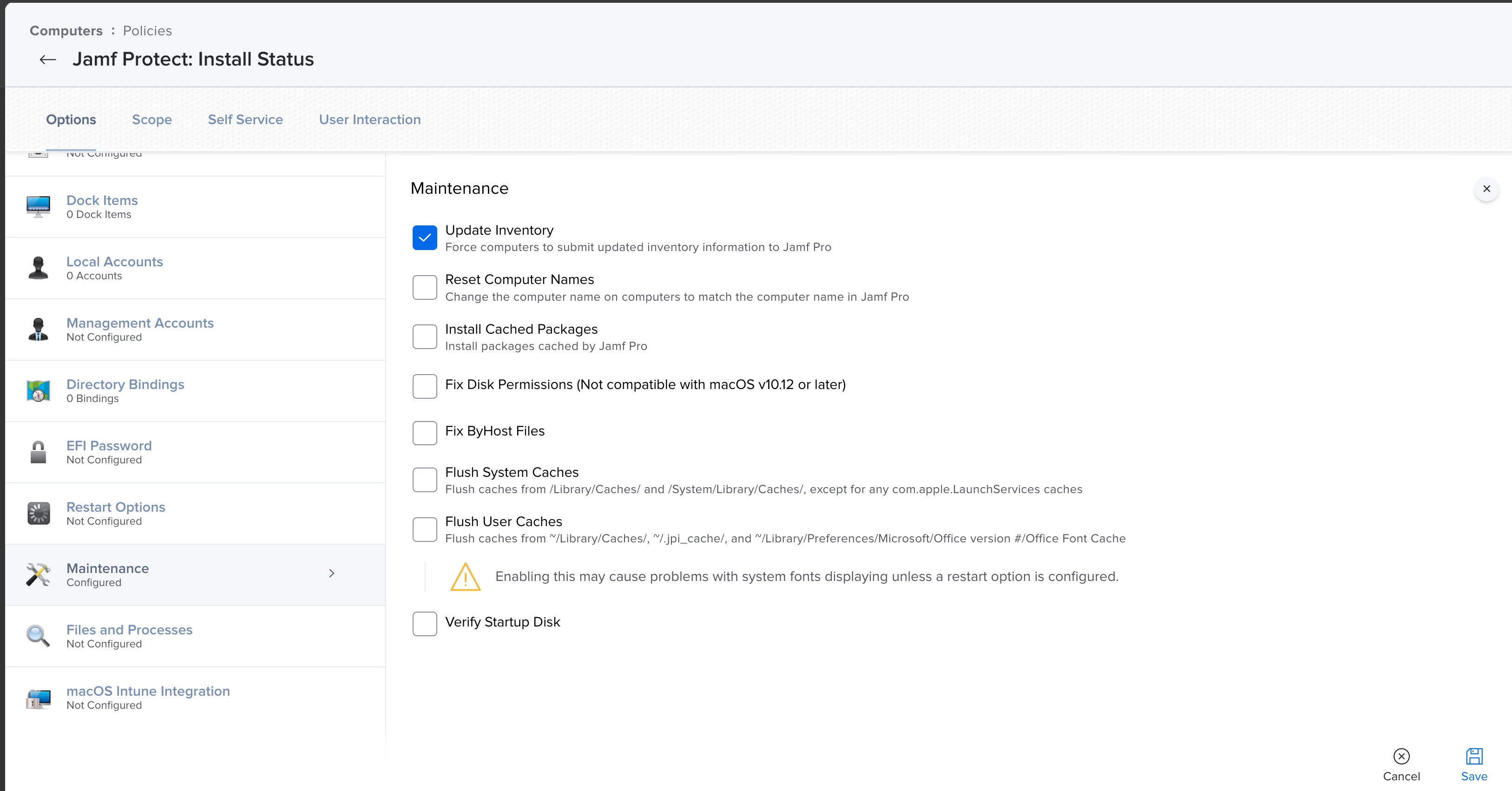

- Configure the "Maintenance" payload & Check Update Inventory.

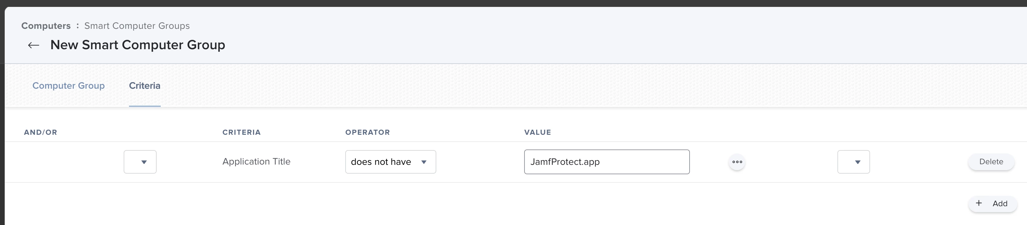

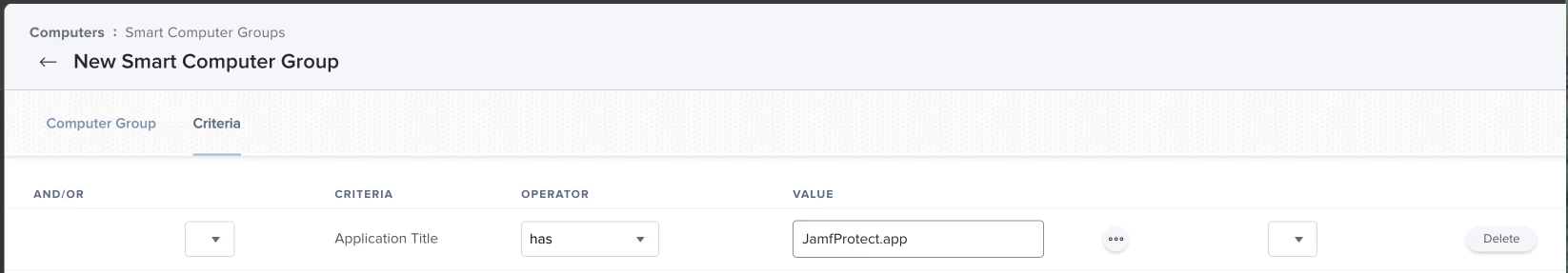

@dm8v
Create a Smart Computer Group targeting computers that do not have Jamf Protect installed. Scope your re-install policy to that. This is predicated upon last inventory update results.
Home Grown Solution (If Jamf Inventory Update isn't consistent or if you have an issue with what above smart group is reporting)

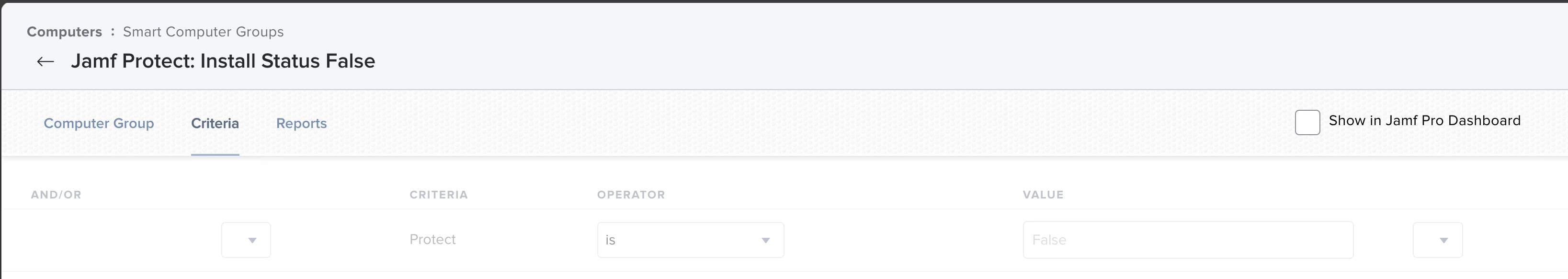

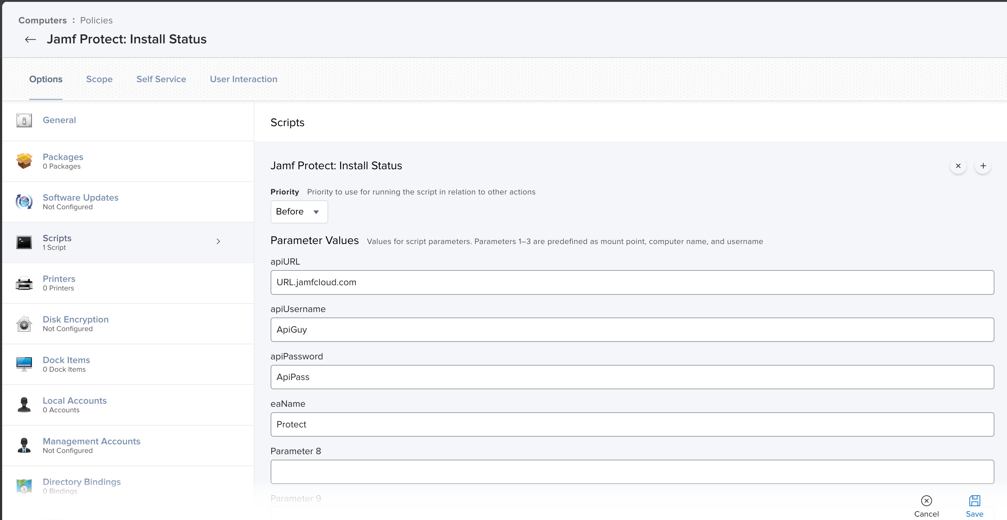

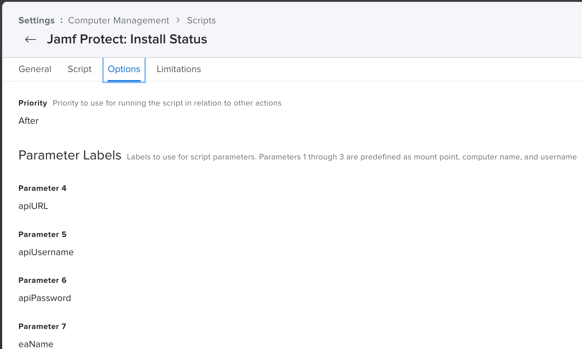

Step 3. Add the Following Script to your Jamf Pro Scripts Library & Modify the Parameter Values as Depicted Below.
This Script Runs a Check to see if the JamfProtect.app file exists, if it does, it writes True to the Extension attribute & is not included in the Smart Computer Group. If the JamfProtect.app file does not exist, it writes False to the Extension attribute & places the computer without Jamf Protect into the Smart Computer Group.
Script:
#!/bin/bash # ██████╗ ██████╗ ██████╗██╗ ██╗███████╗████████╗███╗ ███╗ █████╗ ███╗ ██╗ # ██╔══██╗██╔═══██╗██╔════╝██║ ██╔╝██╔════╝╚══██╔══╝████╗ ████║██╔══██╗████╗ ██║ # ██████╔╝██║ ██║██║ █████╔╝ █████╗ ██║ ██╔████╔██║███████║██╔██╗ ██║ # ██╔══██╗██║ ██║██║ ██╔═██╗ ██╔══╝ ██║ ██║╚██╔╝██║██╔══██║██║╚██╗██║ # ██║ ██║╚██████╔╝╚██████╗██║ ██╗███████╗ ██║ ██║ ╚═╝ ██║██║ ██║██║ ╚████║ # ╚═╝ ╚═╝ ╚═════╝ ╚═════╝╚═╝ ╚═╝╚══════╝ ╚═╝ ╚═╝ ╚═╝╚═╝ ╚═╝╚═╝ ╚═══╝ # Created by Hugonaut # Script Parameters are set within the Policy this Script is Assigned to & are to be configured as follows # Parameter 4: jss.example.org:8443·································(apiURL) # Parameter 5: API Administrator Account····························(apiUsername) # Parameter 6: API Administrator Password···························(apiPassword) # Parameter 7: Display Name of Extension Attribute ·················(eaName) ########################## Jamf Policy -> Script Parameters ############################ apiURL=$4 apiUsername=$5 apiPassword=$6 eaName=$7 ###################################### Get UDID ######################################## computerUDID=$(/usr/sbin/system_profiler SPHardwareDataType | /usr/bin/awk '/Hardware UUID:/ { print $3 }') ############################### Get Jamf Protect Value ################################# JamfProtectValue=$(if [ -e "/Applications/JamfProtect.app" ] then echo "True" else echo "False" fi) ########################### Construct & Post Jamf Group EA ############################# apiData="<computer><extension_attributes><extension_attribute><name>${eaName}</name><value>${JamfProtectValue}</value></extension_attribute></extension_attributes></computer>" apiPost=`curl -H "Content-Type: text/xml" -sfu ${apiUsername}:${apiPassword} ${apiURL}/JSSResource/computers/udid/${computerUDID} -d "${apiData}" -X PUT`
 Parameter Values:
Step 4:

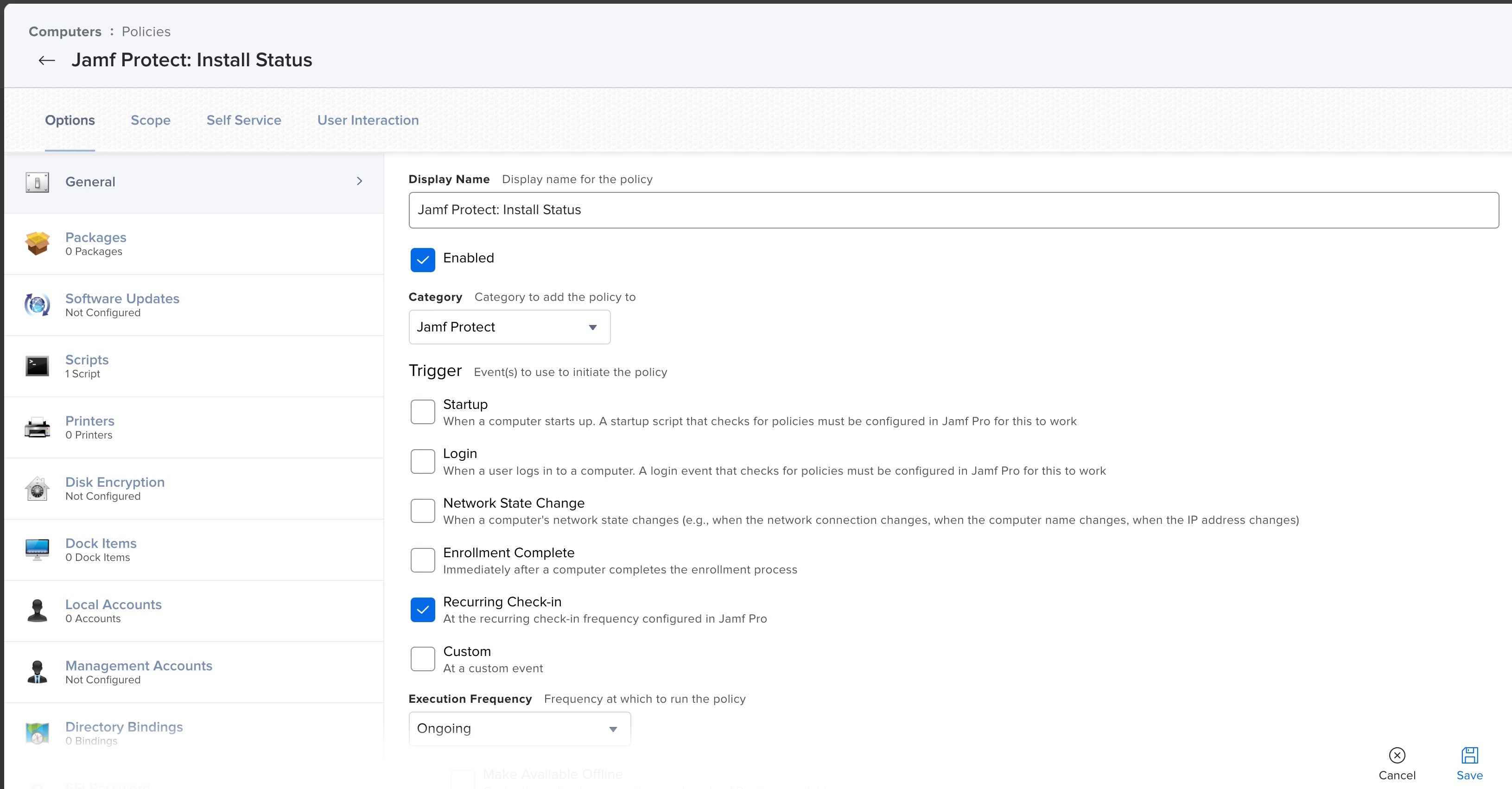

- Create a Policy with a Trigger of Recurring Check-in, an Execution Frequency of Ongoing.
- Add the script from Step 3 to the script payload of the policy, add your Jamf Pro Console URL, an administrator account or api account with access to your jamf pro console, the accounts password, and the name of the Extension Attribute created earlier.

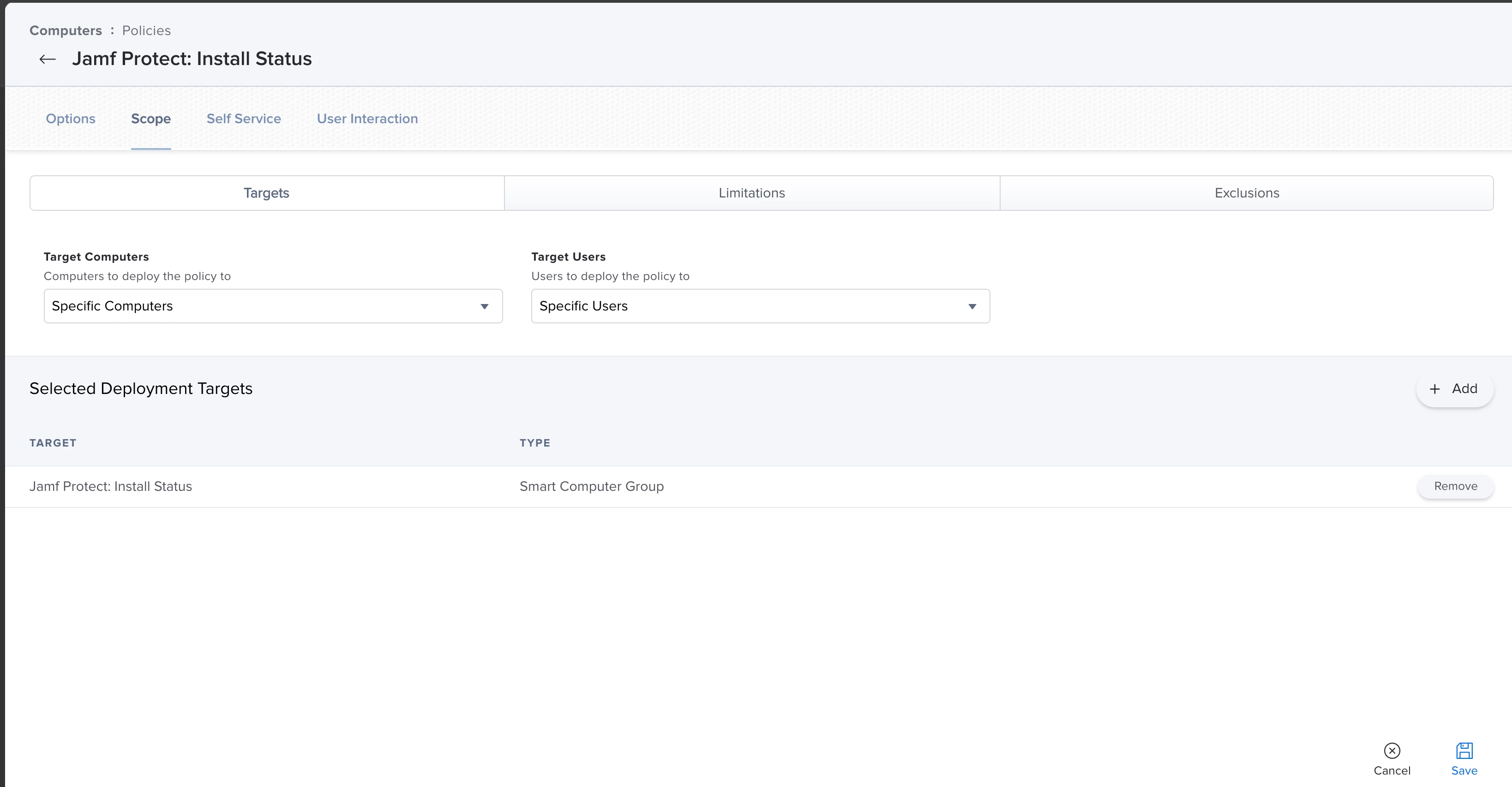

- Scope to Smart Computer Group 2 (Empty Value) created in Step 2.
