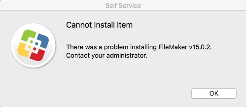

  • May 16, 2017
When using composer the 15.0.2 installer, made a package with composer and when I try to run it from Self Service I get a "Problem installing FileMaker xx contact your admin."
I don't even get a failed log from Casper, any ideas what might be the cause?
