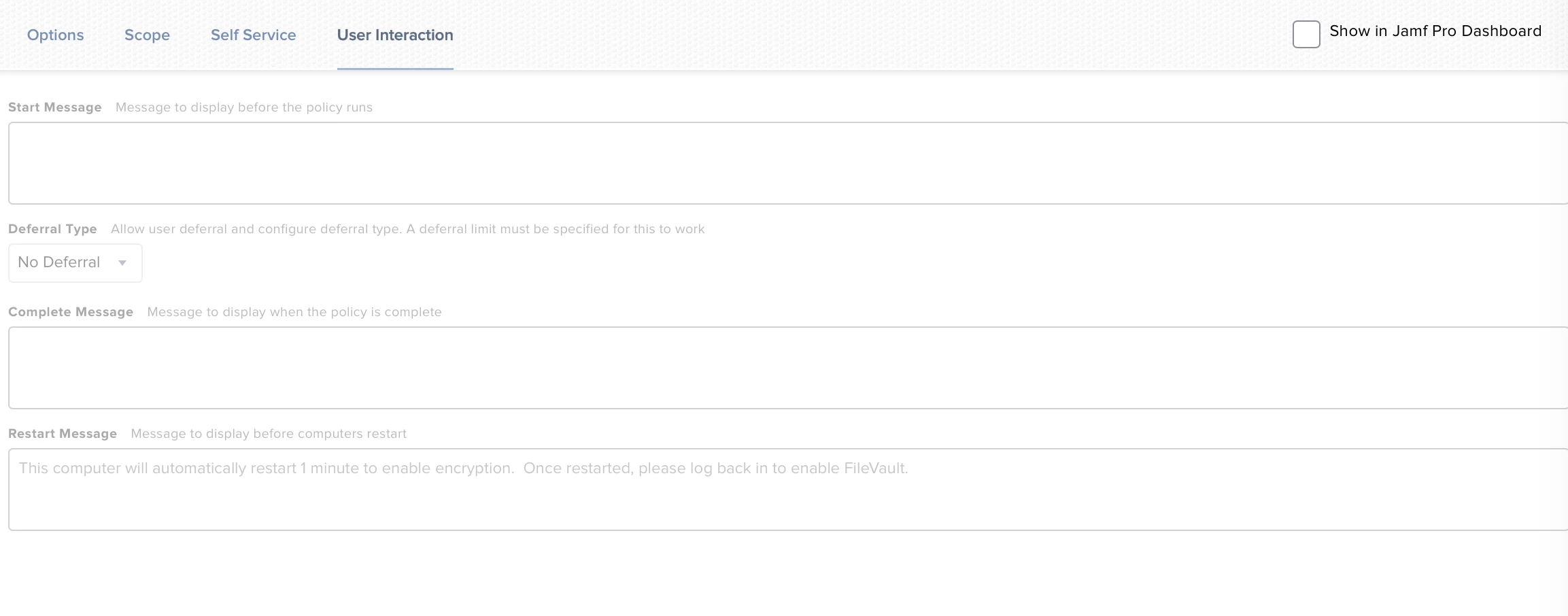

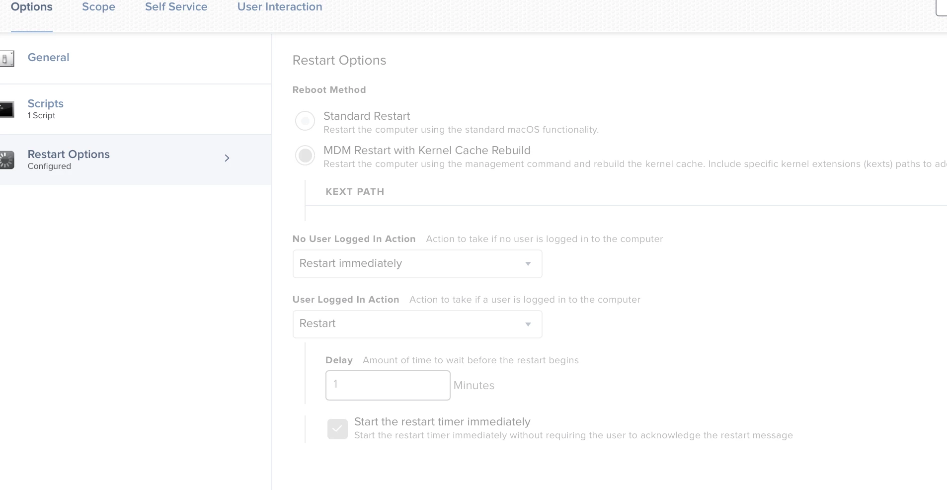

What worked for us in getting FV enabled at user creation (or, actually, right after) was setting up a 'Disk Encryption' payload policy that would
- trigger at 'Enrollment'
- 'Once per Device'
- enable FileVault at next login
- AND set the Restart variables to 'Restart Immediately'
This ensued that right after _mbsetupuser was done setting up the mac, it would reboot and force the user to enable FileVault before logging in.
