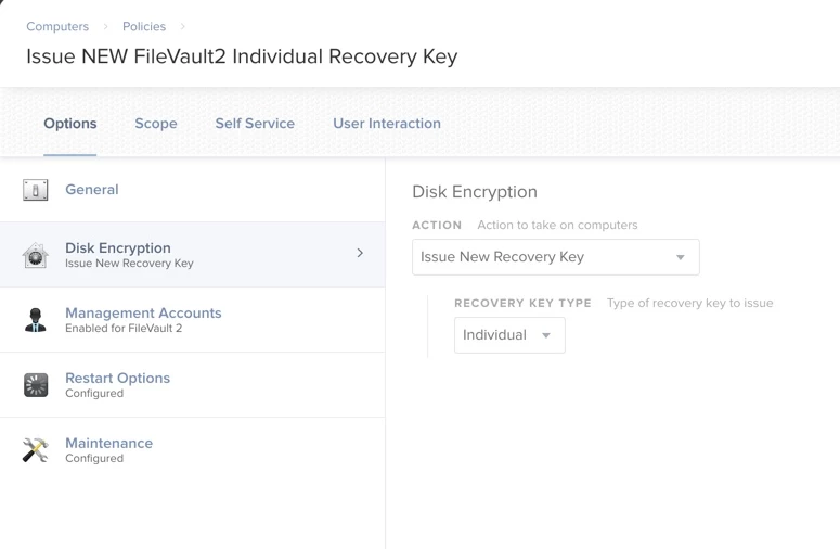

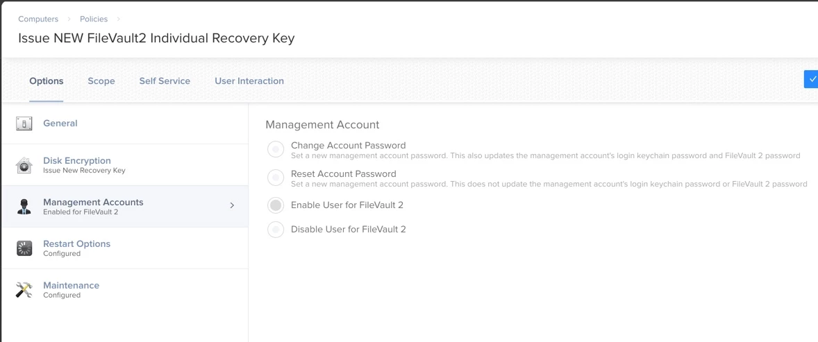

I have a simple policy setup that when used, use to issue out a new recovery key when the old was was used I would add a specific computer to that policy that would need a new recovery key and JAMF use to take care the rest. This is no longer working, I tried some of the scripts out there and could not get anything to work properly or would take a very long time to end up failing in the end. A while back ago, when I first set this up it was working without a problem.
My Current setup:
Error I am getting now:
Executing Policy Issue NEW FileVault2 Individual Recovery Key
Adding user JSSAdmin to filevault
Error: Added users failed error.
Error adding user to FileVault: Added users failed error.
New personal recovery key = '(...)'
Running Recon...
Retrieving inventory preferences from https://mycompnay.jamfcloud.com/...
Locating package receipts...
Locating accounts...
Searching path: /Applications
Locating software updates...
Locating printers...
Locating hardware information (Mac OS X 10.14.5)...
Gathering application usage information...

So out of curiosity, if you pick one to test with and manually add your management account does it still fail? I'm getting issues attempting to reissue keys, but I've manually added them
fdesetup add -usertoadd JAMFAdmin
and then remote call my policy to run it
jamf policy -event fvnewkey

@CorpIT_eB So my thought about the manually adding the account give you some visibility about where that error could be coming from. We use 2 different accounts for different purposes
admin
and
JAMFAdmin
Admin is the one our front line support staff can log into for various issues if need be, and generally has rights to unlock drives with Filevault. We ran into an issue when we migrated from one JSS to our new JSS due to a server rebuilt that the keys didn't migrate so I had to recreate this on most of our fleet. JAMFAdmin does all our JAMF related work. So I used the workflow built by Rich Trouton (I think it was his work) to create a plist to import those credentials to authorize and then recreate the key that way. I think you can still use the plist method to deploy that user for rights to FV2. I just get stuck at the fact that the key still fails to regenerate even when there's authorized rights.
