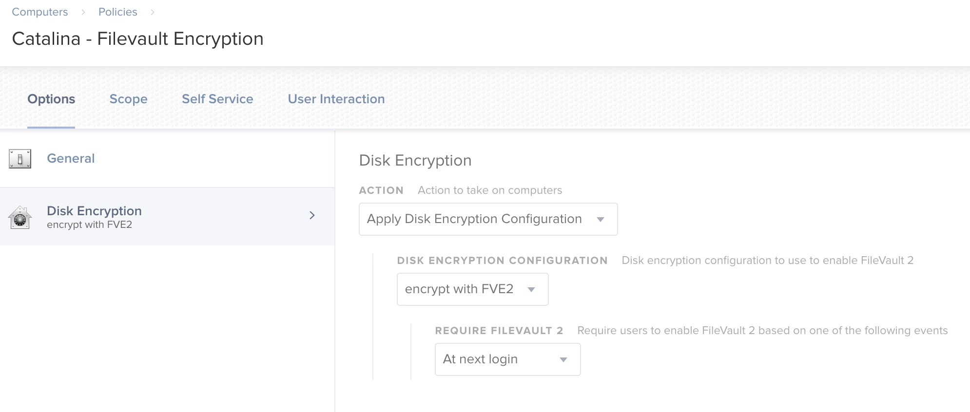

Filevault config profiles on Catalina are weird. they cannot run on logout and needs to run on login. My solution was to set up a policy that forces filevault enabling on login.
for more info see https://www.jamf.com/jamf-nation/discussions/33538/title#responseChild194616
  • December 3, 2019
Thanks for the message @strayer that is exactly how I have my policy set up. Are you using a Profile as well?

Pretty disappointed at Jamf's guidance with this. I hate that their support either ignores issues or just address them at the end of their response. A specific example with 10.15+ FV2 enablement & enforcement. I asked about this and their response was "Our recommendation for macOS 10.13 and above is to use a Configuration Profile to enable FileVault. Here is the workflow that we have used successfully in the past:". Which I was aware of but my question was specifically about 10.15+ so why not address this directly and right away? Enabling and enforcing FV2 is a requirement for many of us, I'm curious if they are addressing this during jumpstarts at this time our just leaving admins to figure it out themselves like seems to be the case. This at the end of their response:
"With Catalina we discovered a new Product Issue that Apple and us are working at getting resolved. Essentially what happens is after logout or reboot FileVault enablement never triggers. What we need to do is create a separate policy with "Disk Encryption" enabled at "Next Login". We can create a Smart Group based on the Operating System using the "Like" operator and specifying the version to be 10.15. We can then use that for our scope".
