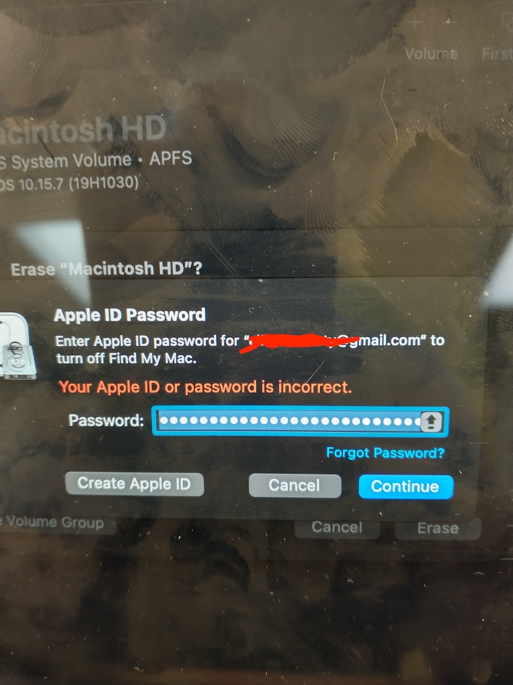

Regarding the two screenshots shared:
I'm interpreting the first in that you attempted to enter the Bypass Code in the Apple ID's password field.  (Mainly because of the length of the password and the CAPS LOCK symbol.)  If this is what was attempted, this is incorrect.  The Bypass Code for Macs are not entered here -- this is where Bypass Codes for iPhone and iPads are entered.
Sources:  Activation Lock on Apple devices (text referenced is highlighted) and Disabling Activation Lock

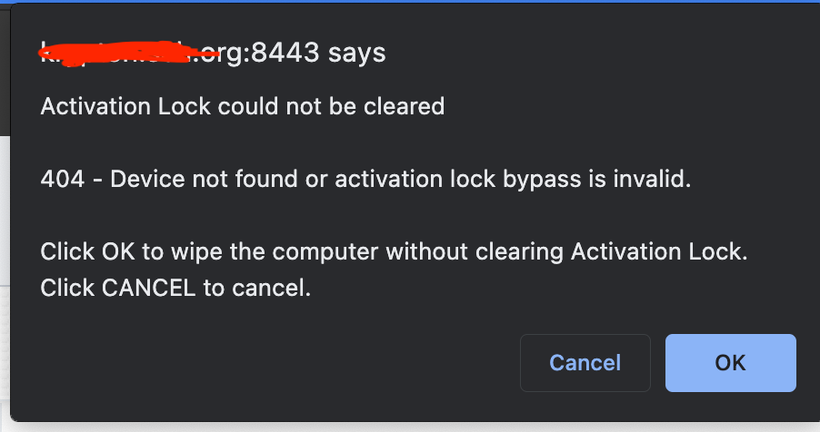

For the second screen shot, the error:
404 - Device not found or activation lock bypass is invalid
Is literally the error from Apple's activation service API used to clear Activation Lock.  Jamf Pro is actually just passing it straight to you (which is awesome and only does for Computers and Shared iPads, other devices Jamf Pro does not tell you when it fails to clear Activation Lock [unless you look in the JamfSoftwareServer.log]).
Source:  Use a Bypass Code to Disable Activation Lock
This is what it means, the Bypass Code was invalid.  Now, the question here is, was this device enrolled via ADE or another method?  With Macs, if enrolled post setup (e.g. not via Automated Device Enrollment) the user can enable Find My, thus Activation Lock is enabled.
Sources:  User-linked Activation Lock on Mac computers  and Allowing Activation Lock on Mac
Bypass Codes are not created unless a device is going through the Setup Assistant and enrolling into MDM at the time time or when an MDM requests a Bypass Code and one was not previously created.
Source:  Get the Bypass Code for Activation Lock
So, if a device is setup, Find My is enabled (which only associates the Apple ID with the "Activation Lock record" on Apple's activation service), then the device is enrolled into MDM, that's when the Bypass Code is created, but the Bypass Code isn't "added" to the "Activation Lock record" that was setup -- those are not "editable."  Find My has to be turned off and turned back on for both the Bypass Code and the users' Apple ID to be associated on the "Activation Lock record."
