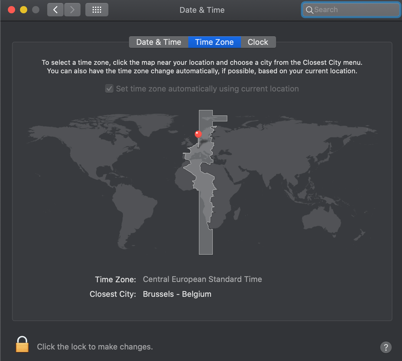

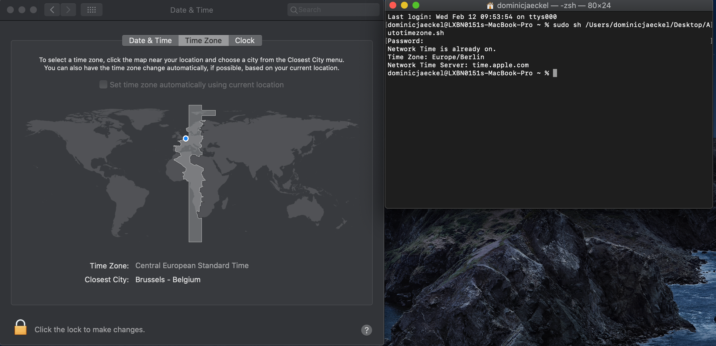

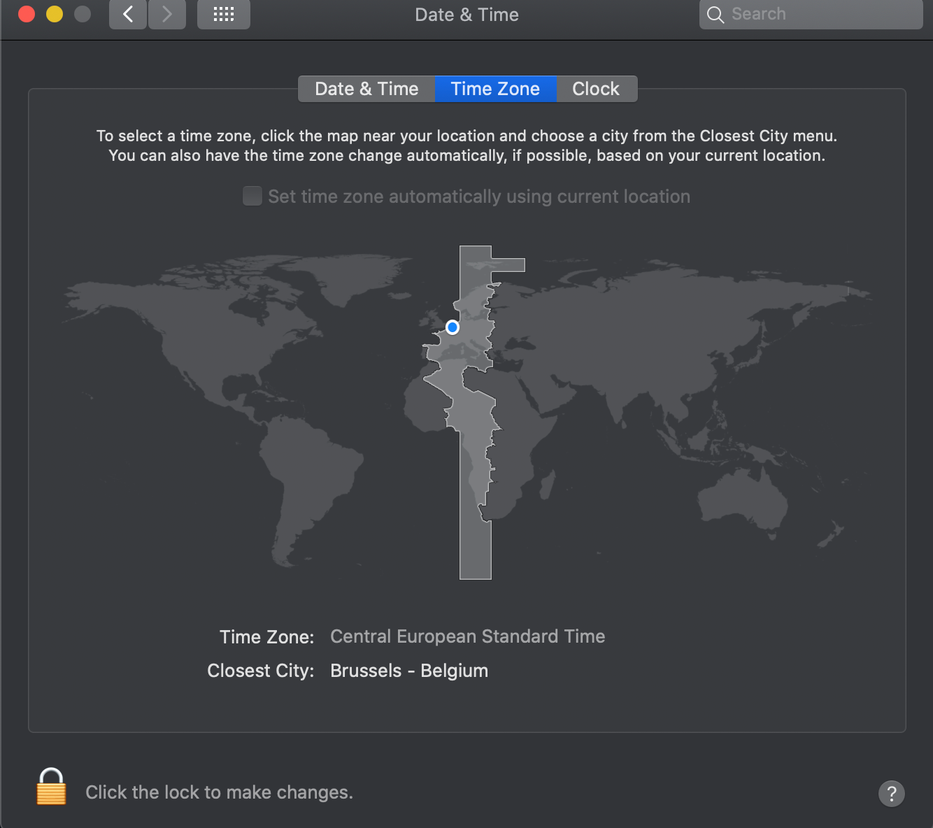

Hi all,
I'm having difficulties to force this check through a terminal command. Attached a screenshot.
In the end I want to push it to all computers through JAMF, but I can't seem to find the right command for it.
I found this one in several articles:
/usr/bin/defaults write /Library/Preferences/com.apple.timezone.auto Active -bool true
But it seems to be deprecated.
After that I found this one and tried it as well, but it doesn't seem to check the mark.
/usr/sbin/systemsetup -setusingnetworktime on
Therefore I'm wondering if there is an option to force it somehow?
I tried on Mojave and Catalina.
Best Regards and thank you,

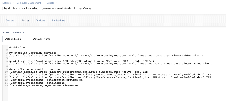

I'm currently using this and seems to be working fine... note WiFi must be active...
## enabling location services
/usr/bin/defaults write /var/db/locationd/Library/Preferences/ByHost/com.apple.locationd LocationServicesEnabled -int 1
uuid=$(/usr/sbin/system_profiler SPHardwareDataType | grep "Hardware UUID" | cut -c22-57)
/usr/bin/defaults write /var/db/locationd/Library/Preferences/ByHost/com.apple.locationd.$uuid LocationServicesEnabled -int 1
## configure automatic timezone
/usr/bin/defaults write /Library/Preferences/com.apple.timezone.auto Active -bool YES
/usr/bin/defaults write /private/var/db/timed/Library/Preferences/com.apple.timed.plist TMAutomaticTimeOnlyEnabled -bool YES
/usr/bin/defaults write /private/var/db/timed/Library/Preferences/com.apple.timed.plist TMAutomaticTimeZoneEnabled -bool YES
/usr/sbin/systemsetup -gettimezone
/usr/sbin/systemsetup -getnetworktimeserver

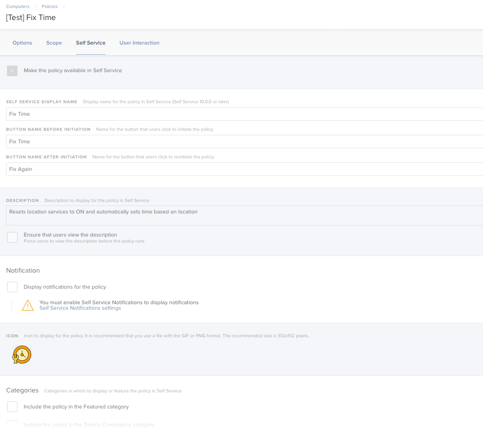

Immediately added this as a Self Service policy. Great stuff guys!

Hi,
I tried it on Catalina and it doesn't work.
Any ideas?

It works in Catalina. You could post the contents of your autotimezone.sh but the above code works just fine with a script and policy. In my example, I made it into a Self Service item, but you should be able to use other triggers. I have not tested on Mojave yet.

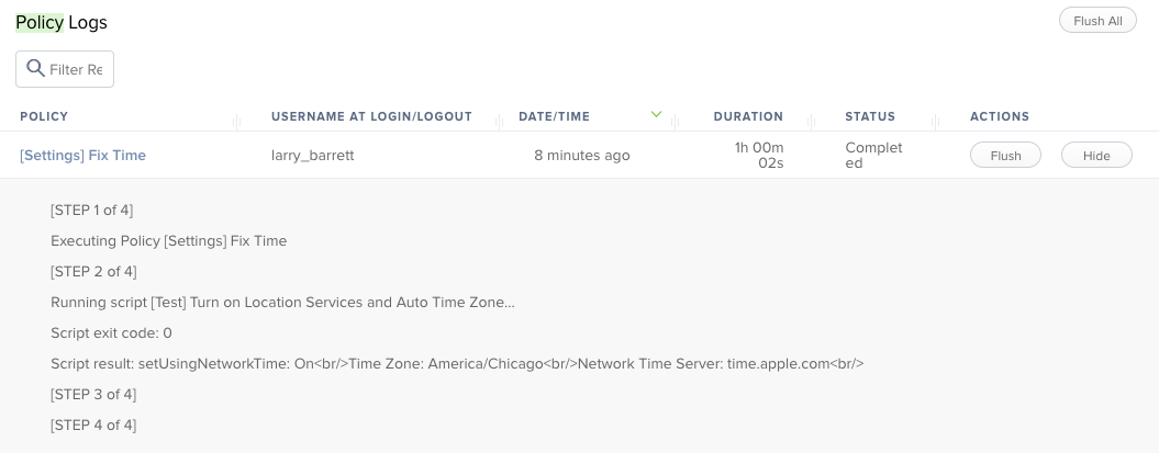

I can confirm this is no longer working in Catalina. It will do everything except for check the box: Set time zone automatically using current location.

@Dominic.Jaeckel In Terminal, if you first elevate to root and then execute your modified version of @larry_barrett's script, do you get different results than using sudo with your account?

@macbrun I just tried running it and that checkbox does indeed become checked after a reboot. Thanks :) This is on a T2 mac.

  • April 29, 2020
Hi,
sorry that I didn't reply anymore, but the script is working you just have to reboot after execution and the box is checked.
Works on Mojave and Catalina.

The timing of your post is quite serendipitous, @mario11
However, I ended up having to use `systemsetup` instead.
timedPrefs="/private/var/db/timed/Library/Preferences/com.apple.timed.plist" defaults read $timedPrefs { NtpUseServicePort = 0; TMAutomaticTimeOnlyEnabled = 1; TMAutomaticTimeZoneEnabled = 1; } dateTimePrefs="/private/var/db/timed/Library/Preferences/com.apple.preferences.datetime.plist" defaults read $dateTimePrefs { timezoneset = 1; } ls -lah $timedPrefs -rw------- 1 _timed _timed 135B May 19 10:25 /private/var/db/timed/Library/Preferences/com.apple.timed.plist ls -lah $dateTimePrefs -rw------- 1 _timed _timed 59B Apr 18 10:43 /private/var/db/timed/Library/Preferences/com.apple.preferences.datetime.plist defaults delete $timedPrefs TMAutomaticTimeZoneEnabled defaults read $timedPrefs { NtpUseServicePort = 0; TMAutomaticTimeOnlyEnabled = 1; } ls -lah $timedPrefs -rw------- 1 root wheel 101B May 19 10:39 /private/var/db/timed/Library/Preferences/com.apple.timed.plist /usr/sbin/chown "_timed:_timed" "$timedPrefs" "$dateTimePrefs" ls -lah $timedPrefs -rw------- 1 _timed _timed 101B May 19 10:39 /private/var/db/timed/Library/Preferences/com.apple.timed.plist
After all of the above, the time was still incorrect (i.e., the Mac had been in PDT and was back in MDT, but still showed as PDT).
systemsetup -gettimezone Time Zone: America/Los_Angeles systemsetup -settimezone 'America/Denver' 2022-05-19 17:43:43.895 systemsetup[10464:153418] ### Error:-99 File:/AppleInternal/Library/BuildRoots/66382bca-8bca-11ec-aade-6613bcf0e2ee/Library/Caches/com.apple.xbs/Sources/Admin/InternetServices.m Line:379 Set TimeZone: America/Denver systemsetup -gettimezone Time Zone: America/Denver date Thu May 19 11:43:59 MDT 2022
With the error, I was surprised this actually worked (and persisted after a reboot).
The Mac is running macOS `12.3.1` and if I observed the error in `12.4`, I would have filed feedback with Apple.
