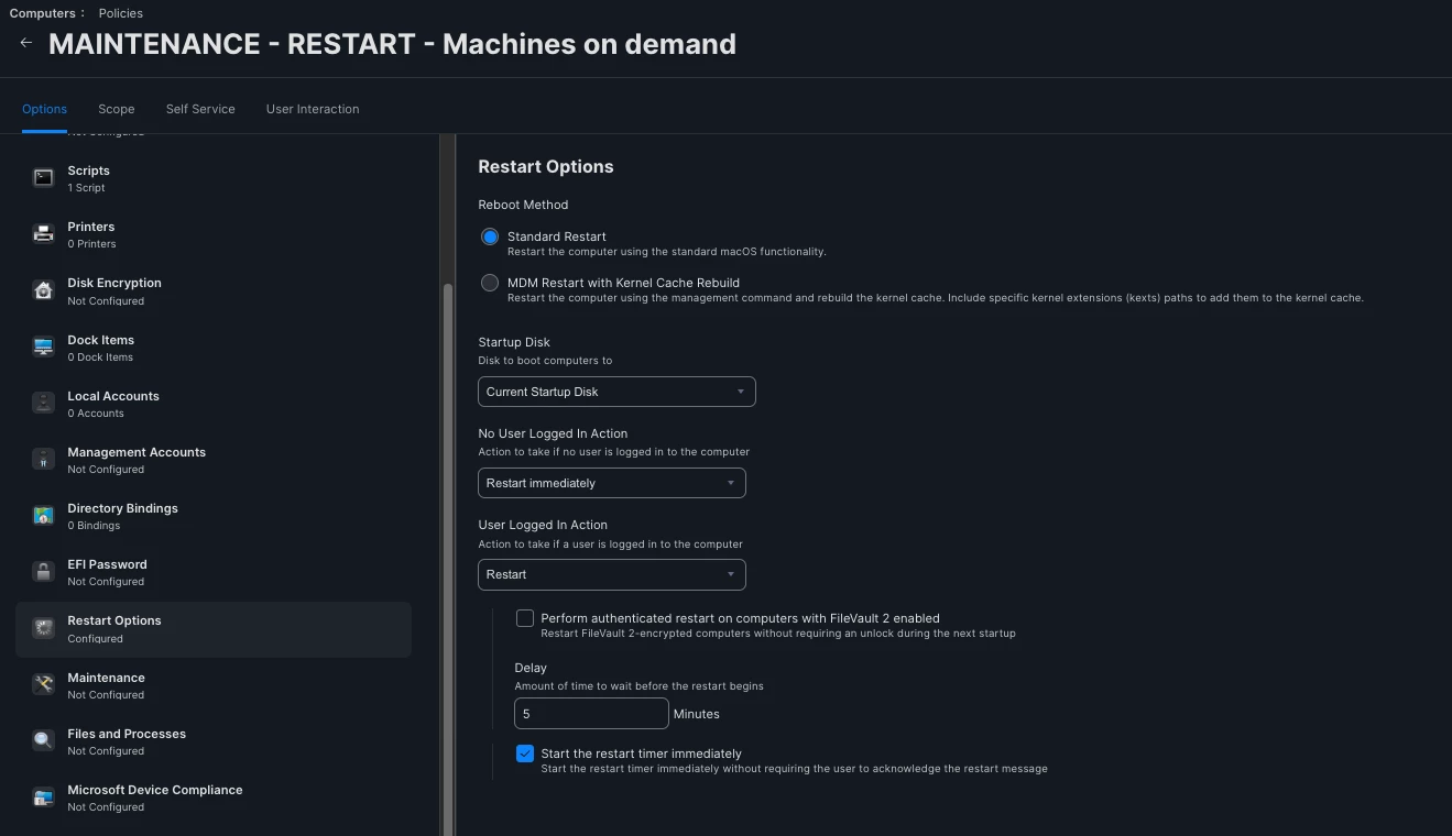

snowfox
  • Jan 26, 2025 12:27 AM UTC
You can setup a policy on jamf (look for 'restart options') to restart the machines automatically on a fixed schedule.
You can set it to restart immediately if no one is logged in or it will start a 5 minute countdown timer immediately and display a warning message to the currently logged in user that the machine is about to restart in 5 minutes.
Performing a restart is the only thing that is going to clear all of the currently logged in user sessions.
Of course you can also set it to restart immediately even if someone is still logged in.  If you are running it after the students have gone for the day.  Use the 'Client-Side Limitations' section under 'General' to pick what days and time to run the policy at.   Setting the time is a bit backwards.  You have to choose when NOT to run the policy in order to run it in the hours that you want ie. NOT between 9am - 5pm.

matthias.beck
  • Jan 28, 2025 9:26 AM UTC
Rebooting just seems to be the only working way to "get rid" of the accounts in the login window as well as completely force logout all logged in users.
