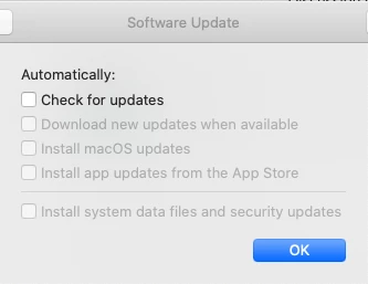

We like to control the software update process so we have everything unchecked in Software Update
Not sure if that has something to do with Xprotect being unable to update even when running softwareupdate --background-critical from the Terminal.

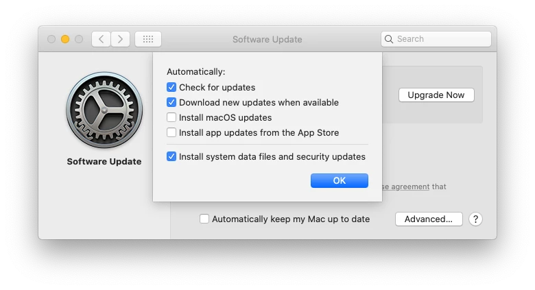

@mvu thanks for the feedback it pushed me towards an answer. In the end the final piece was
softwareupdate --background --include-config
in combination with the following Software Update PreferencePane configuration
This Software Update PreferencePane configuration is displayed after running the following (assuming nothing was selected before):
/usr/bin/defaults write /Library/Preferences/com.apple.SoftwareUpdate.plist AutomaticCheckEnabled -bool true
/usr/bin/defaults write /Library/Preferences/com.apple.SoftwareUpdate.plist AutomaticDownload -bool true
/usr/bin/defaults write /Library/Preferences/com.apple.SoftwareUpdate.plist ConfigDataInstall -bool true
Basically if I tried to run
without the above configuration for Software Update then the XProtect definitions would simply not update. Once I at least re-enabled the Mac's ability to check and download updates then running softwareupdate --background --include-config would finally grab the latest Xprotect data.

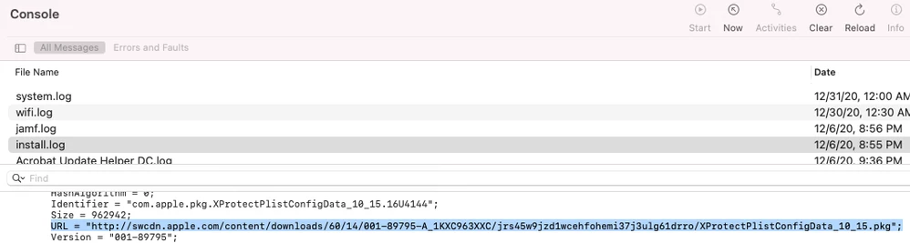

Yes, you can find the URL in the Console. You can also use Terminal and the softwareupdate -d command. I explain how I did this with Safari that in the link below. Someone mentioned the app SUS Inspector as well, which saves some work on digging for the URL.
Safari DL
