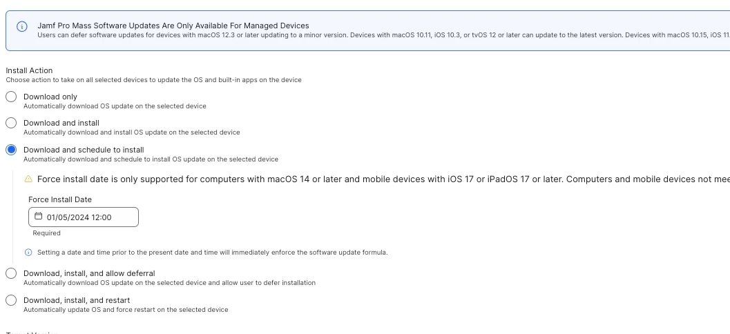

Is it just me or is this forced update feature not working for you too? Noth
Is it just my system or is this not working for you too? Updates do not get forced and we are all on Sonoma.
Best answer by sdagley
WARNING! - PI116287 "Scheduled Software Updates (DDM) using Specific Versions Does Not Work"
Apparently I was incredibly lucky that using a DDM Scheduled Update specifying version 14.2.1 actually worked because there is a bug in the current implementation that generates malformed DDM commands. Use the "Latest version based on device eligibility" or "Latest minor version" options to schedule an update instead.
This bug is present as of Jamf Pro 11.2.0, and reportedly will not be fixed until after Jamf Pro 11.3.0 is released.

I also haven't had success. My example is with my Mac Studio lab here. I was trying to get them to go from Ventura to Sonoma. I set it up to run about two weeks ago and not one machine out of 35 has updated. As far as I can tell there is no window into the process to see what's gone wrong or if it's actually trying to do anything.
I fully accept I might be missing something obvious here, but I don't know what to do about.
sdagley
  • Jan 5, 2024 9:48 PM UTC
@mrrobertbuss Have you previously deployed a Scheduled Software Update request with a deadline further out? It appears that you need to cancel any pending Scheduled Software Updates before a new one will be recognized. You can do that by turning off the beta Software Update mechanism which will cancel all in-flight updates. You can then turn it back on and schedule your new update.
I'd also suggest you implement the two EAs from my https://community.jamf.com/t5/jamf-pro/extension-attributes-to-report-on-ddm-scheduled-macos-updates/td-p/307484 post which will report the version and deadline for pending updates.

@AJPinto In my testing of DDM Scheduled Updates a Mac will restart at the scheduled time to complete the update even if there are applications open with un-saved documents. Have you found an application that can't be terminated that repeatedly prevents installation?
While I'm not exactly happy it's taken Apple this long to address the gaping hole in managing macOS updates that Big Sur introduced I am pleased with the introduction of DDM Scheduled Updates in Sonoma. Are there some rough edges at the moment with both the Jamf Pro and macOS parts for configuring and completing DDM scheduled updates? Yes, but for my environment it's working much better for ensuring Sonoma updates by a deadline than Nudge did for Monterey and Ventura. I'm optimistic that both Jamf and Apple will aggressively improve things over their next few releases, and we'll finally be able to cross "Provide reliable management of macOS updates" off the Mac Admins Wish List.

Set up the deferral to kick in 1.9.24 at 8:00 am
  • Jan 10, 2024 7:06 PM UTC
Nothing happened. Consensus is this works for some but not for others.

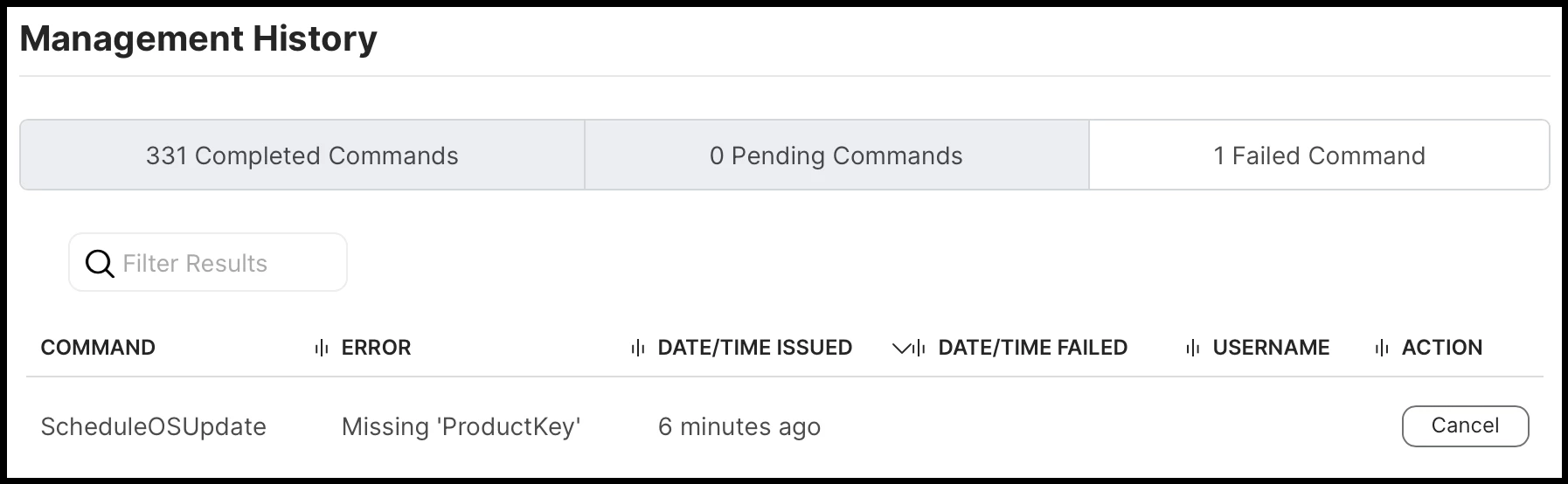

Just adding my experience, and apologizing for not fully reading all the previous posts ;^)
I've experimented with trying to perform the following two items using Software Updates, unsuccessfully:
  • Install macOS 11.7.10 on a Mac Pro 2013, running macOS Big Sur 11.7.9
  • Install macOS 12.7.2 on a Mac Pro 2013, running macOS Big Sur 11.7.10
For both tests I get the following result in Jamf Management...
sdagley
  • Jan 11, 2024 10:06 PM UTC
@janthenat For x86 Macs that old you can use erase-install (ignore the name, it can be used to upgrade Macs as well). See the wiki page for info on using from Jamf Pro: https://github.com/grahampugh/erase-install/wiki/6.-Use-in-Jamf-Pro
  • Jan 17, 2024 7:31 PM UTC
@sdagley Yes indeed, and I'm already doing this. But, there is a new thing and I must play with it ;^)

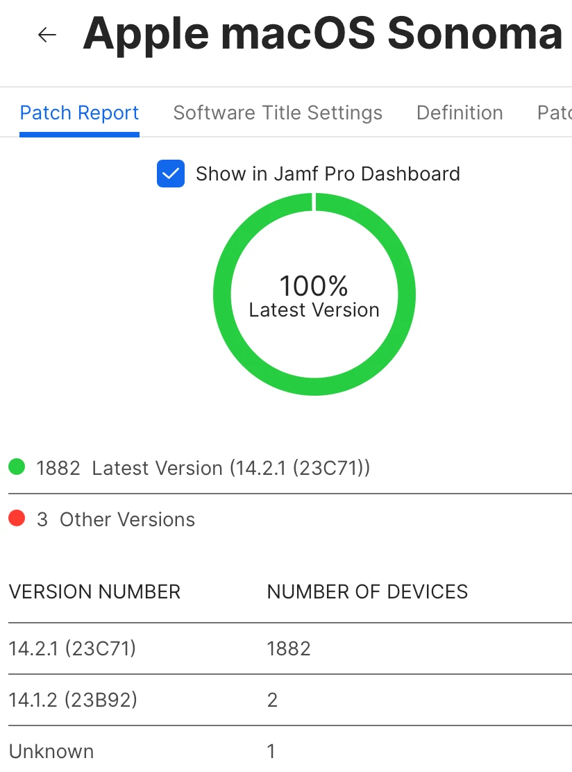

sdagley
  • Jan 19, 2024 8:28 PM UTC
To follow up on my comment that I'm optimistic DDM Scheduled Updates will truly be useful here are the current macOS Sonoma stats for my org:
macOS Sonoma 14.2.1 is being rolled out as our base macOS install so the majority of devices listed are upgrades from macOS Ventura, but for all that were already on Sonoma a DDM Scheduled Update was used to ensure the update to 14.2.1. Of the 3 Macs not yet on 14.2.1 one hasn't been online since the scheduled deadline, one hasn't been logged back into since the deadline, and the 3rd (showing as Unknown) is running the macOS 14.3 Release Candidate build.

I just noticed that some of my test Macs reported AvailableOSUpdates - Scheduled, ScheduleOSUpdateScan, AvailableOSUpdates, ScheduleOSUpdate and OSUpdateStatus - Scheduled,  but did not report "DeclarativeManagement" in their Jamf  Management History logs.
Does this mean that DDM protocol wasn't used for the OS updates? These particular Macs are M1 Macs running Sonoma 14.4.x. and should be capable of DDM. My JSS is 11.5.1 (Cloud). Im confused here.
The success rate of all these Macs (when NOT using a schedule) is 100% - even on Macs that are asleep, idle, etc. I have tested ~10 Sonoma Macs (Intel and ARM) and the only Macs that have failed have been the jobs with scheduled commands. Any commands I have sent that are "Update to Latest minor version" + "Download Install and Restart" (forced) are working great thus far.
