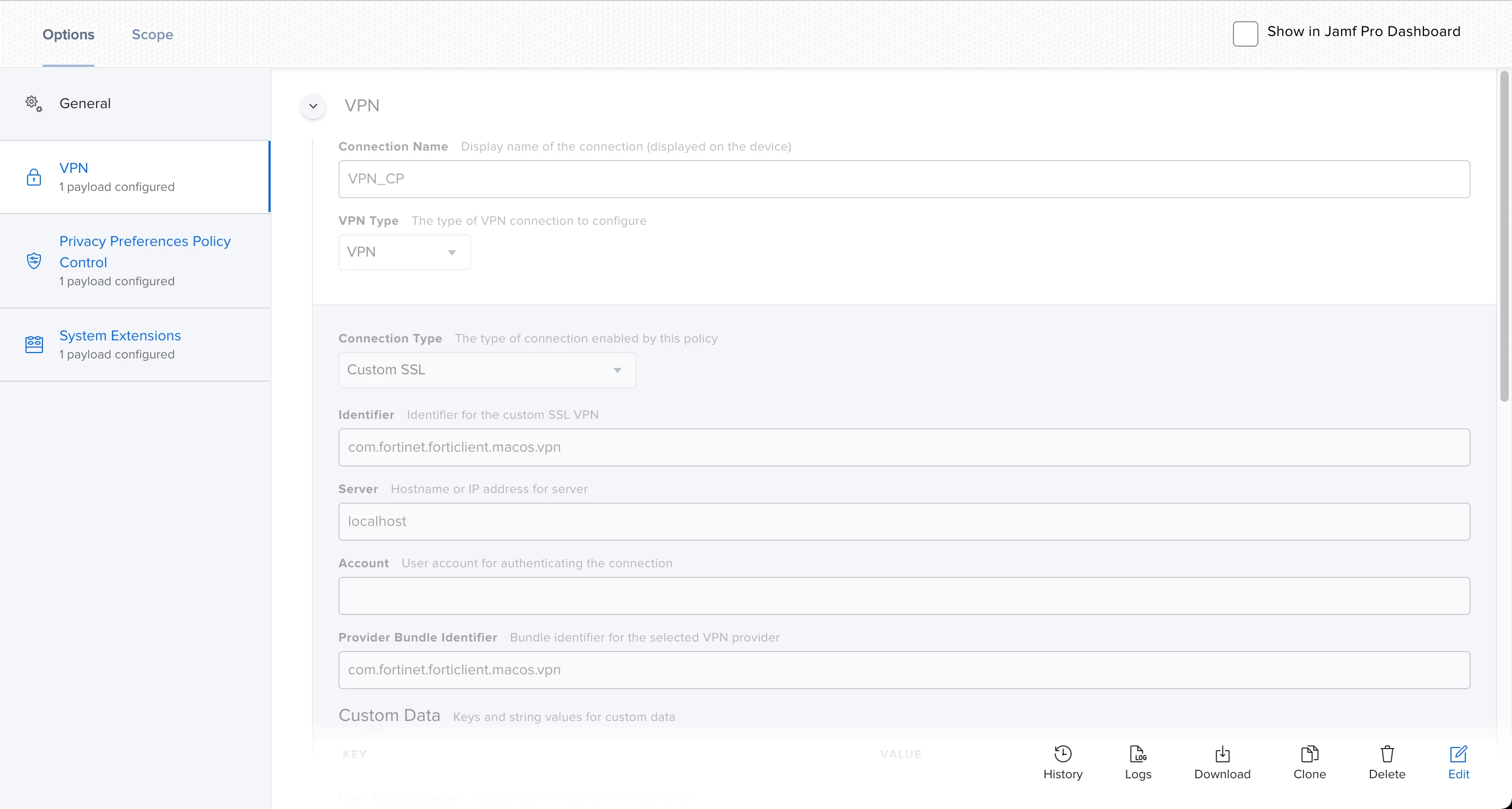

Heya, sorry for the late reply, I finally figured this out.
To avoid the VPN popup configuration, we set a dummy VPN configuration that will be used by Forticlient on runtime :
Nothing else is checked, make sure that the Identifier and Provider Bundle Identifier are set to "com.fortinet.forticlient.macos.vpn" and the name isn't "VPN".
Adding this configuration profile before installing Forticlient will suppress the warning, Forticlient will rename the VPN_CP network to "VPN" and use it.

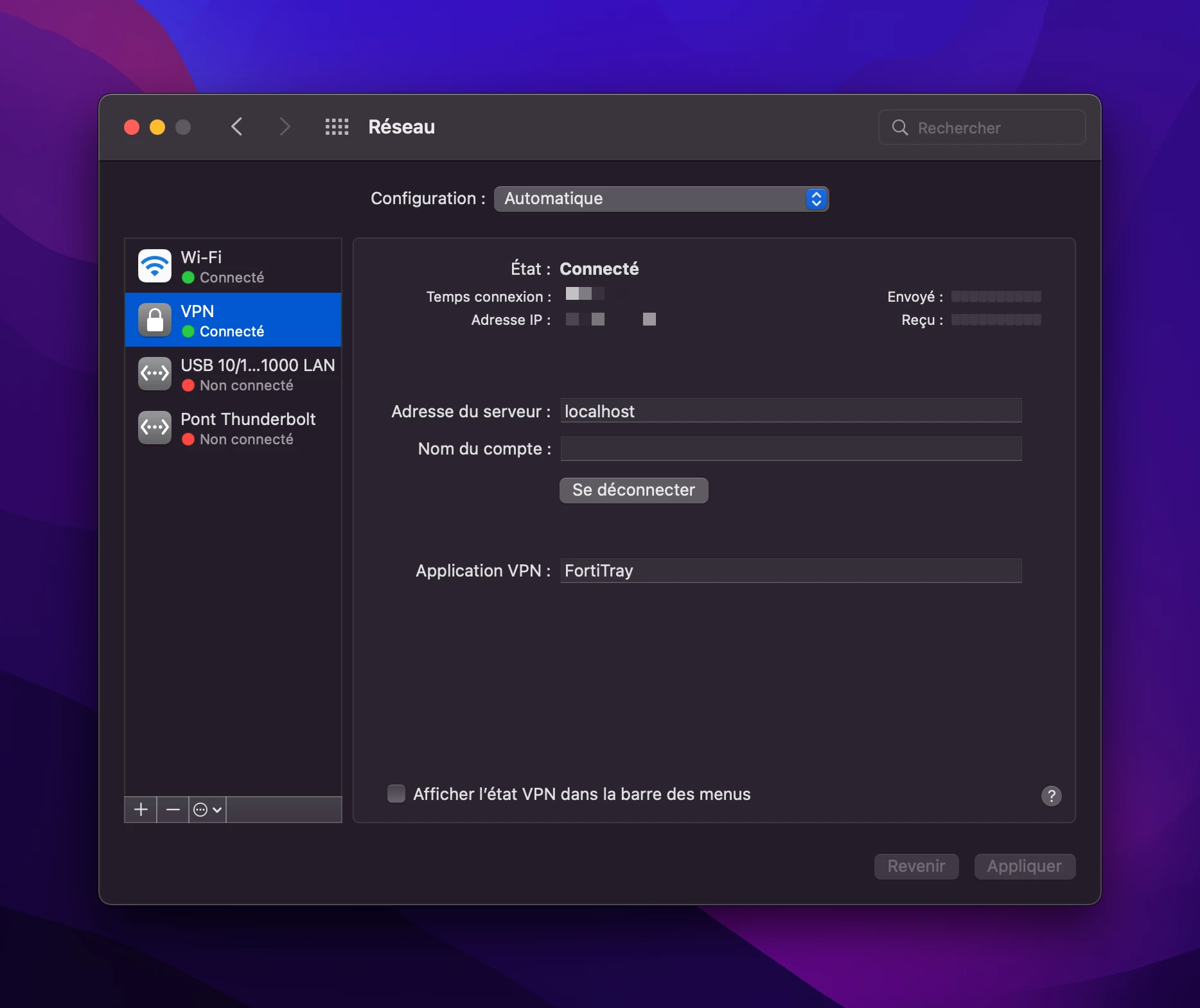

The problem is that FortiClient creates an Network interface called "VPN" with VPN-App: FortiTray

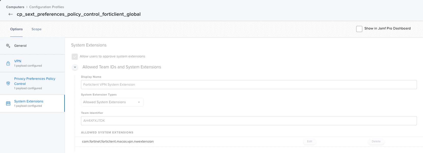

Hello @F_Hadi (and sorry @Jacek_ADC for the late reply),
Here is my System extension configuration pane for this Configuration Profile.

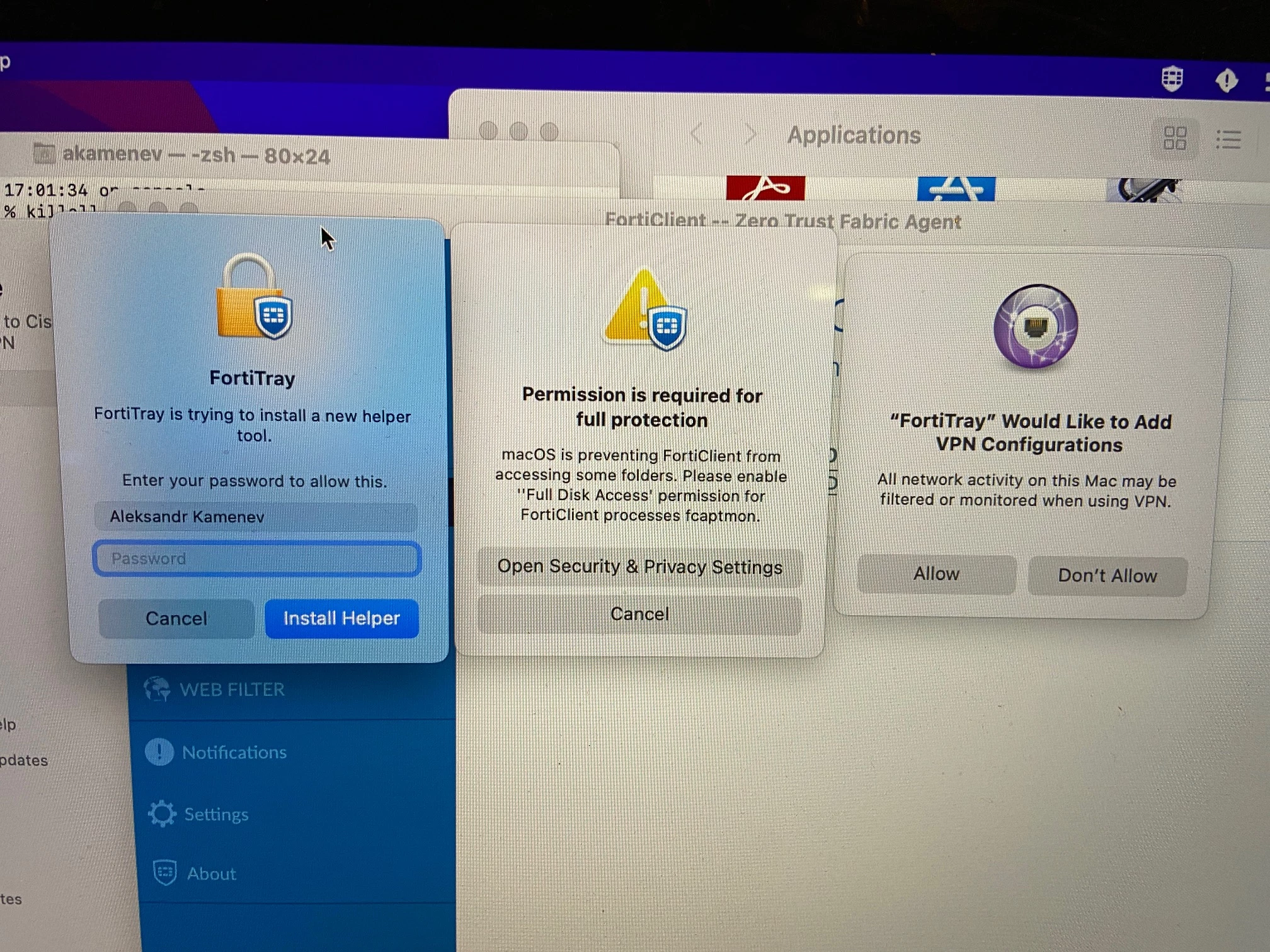

Do you mind also sharing the PPPC config screen? I feel like I have most things configured as they should be, but I am still getting a pop-up screen for:
"FortiTray is trying to install a new helper tool.
Enter your password to allow this."
I can't figure out what the helper tool is so I can add it to the PPPC, or maybe I need to allow a Kernel Extension, I am not sure...
Thanks in advance!
Got the same issue, in total I have 3 pop ups:
1) FortiTray is trying to install a new helper tool
2) FortiTray WOuld Like to Add VPN Configurations (dummy VPN profile is not working for this)
3) Permission is required for full protection > "Full Disk Access" permission for FortiClient processes fcaptmon (sometimes it's fctservctl2, sometimes it's fmon2), I have added all 3 via Configuration Profile > Privacy Preferences Policy Control, yet it still requires to manually accept these...
FortiNet is not very helpful and don't really have any documentation for this... if anybody figures it out, please share.

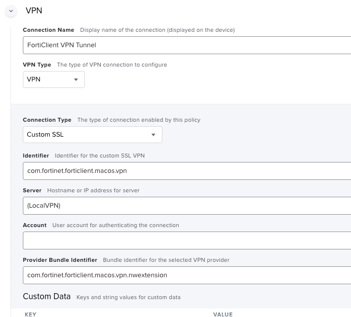

so i managed to solve the add VPN config file pop-up with the below:
com.fortinet.forticlient.macos.vpn.nwextension
identifier "com.fortinet.forticlient.macos.vpn.nwextension" and anchor apple generic and certificate 1[field.1.2.840.113635.100.6.2.6] /* exists */ and certificate leaf[field.1.2.840.113635.100.6.1.13] /* exists */ and certificate leaf[subject.OU] = AH4XFXJ7DK
and then weirdly enough...i have no idea why this works at all... if I add the package to the self-service portal and a user installs it from there none of the extension pop-ups or helper install appear and it installs without issue!
hope the above helps a bit
