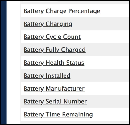

Hi. I suggest going into your JSS under Computer Management > Management Framework > Extension Attributes. Choose "New From Template" and scroll down to the System Information section. There are 9 template EAs you can add for all kinds of battery monitoring. Examples:
  • Battery Charge Percentage
  • Battery Charging
  • Battery Cycle Count
  • Battery Fully Charged
  • Battery Health Status
  • Battery Installed
  • Battery Manufacturer
  • Battery Serial Number
  • Battery Time Remaining
I'm sure one of those, or several, will help out. The one that I think you're looking for is the "Battery Health Status"
