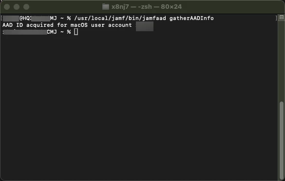

Using the command below will tell you who the device is "registered" to in AAD. If there is a user, you can assume registration is complete. The downside of this command is you may see a dialog box come up for a moment as it runs due to how Microsoft has the GUI elements configured for the comp portal. You could write this into an Extension Attribute to tell if a device is registered or not. Either way, I hope this is a good starting point for you.
/usr/local/jamf/bin/jamfaad gatherAADInfo
