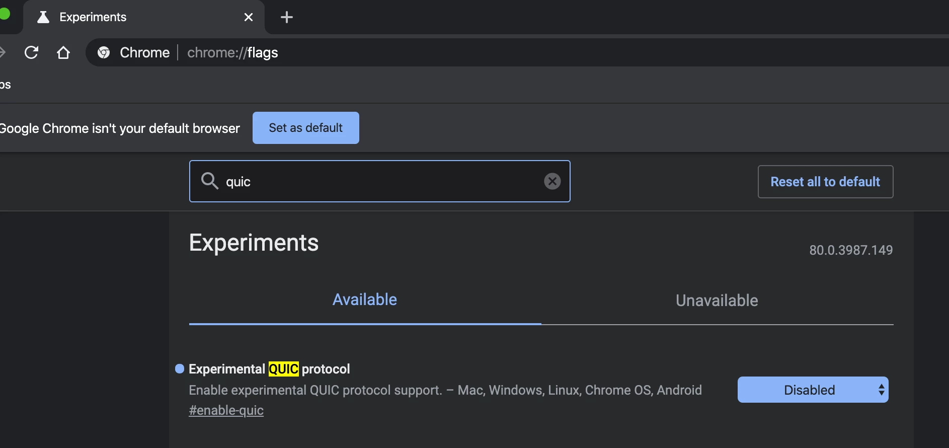

Good Afternoon All,
We are using the Google Chrome Master Preferences file for deployment but has anyone had any luck disabling QUIC via this method or mdm profile?
chrome://flags/ Experimental QUIC protocol

  • Mar 1, 2021 3:28 PM UTC
Hello,
I've tried to disable this through the configuration profile but it's not working for neither options. If you set the value to true or false, it will show as Default.
Have you find any good solution for this?
  • Sep 27, 2021 8:28 AM UTC
Did anyone found a solution to this?
Setting the value to true or false, also still shows as Default in chrome://flags#enable-quic

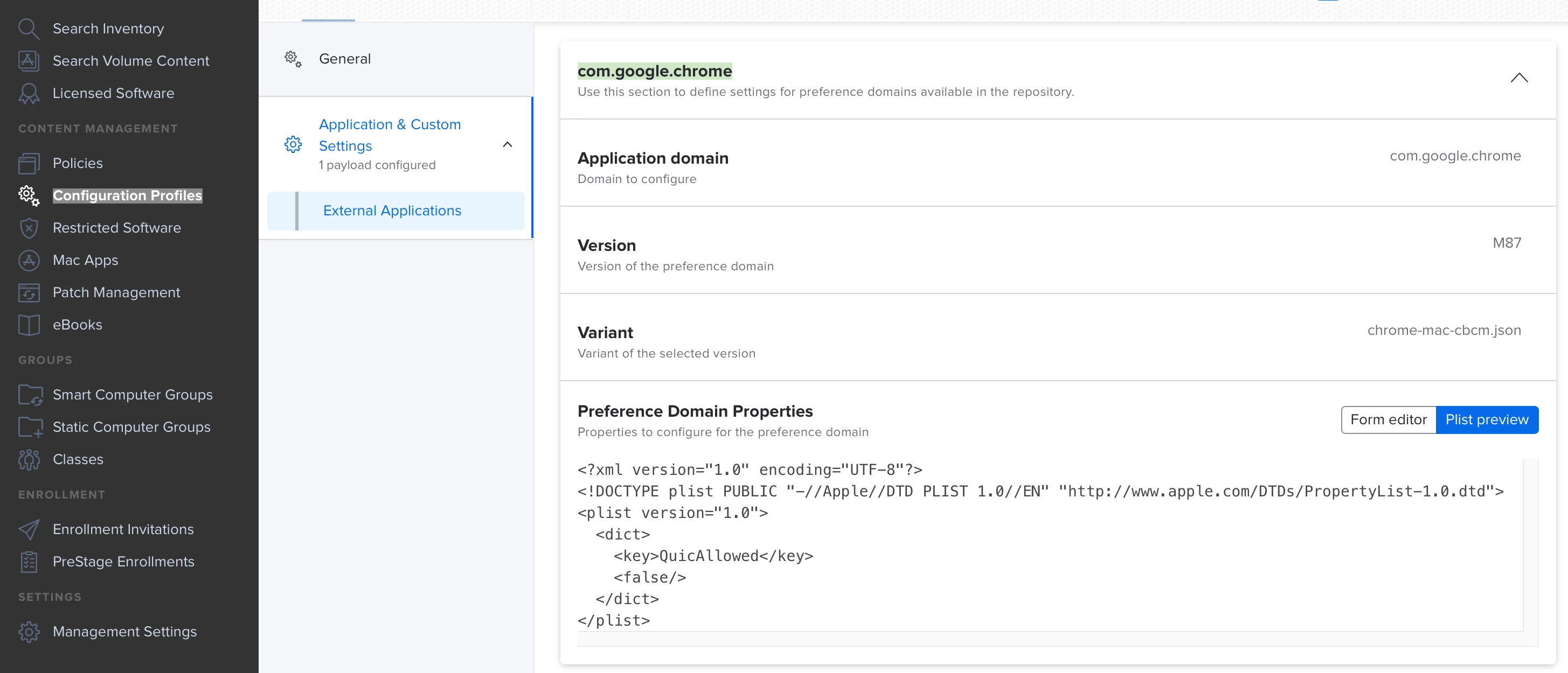

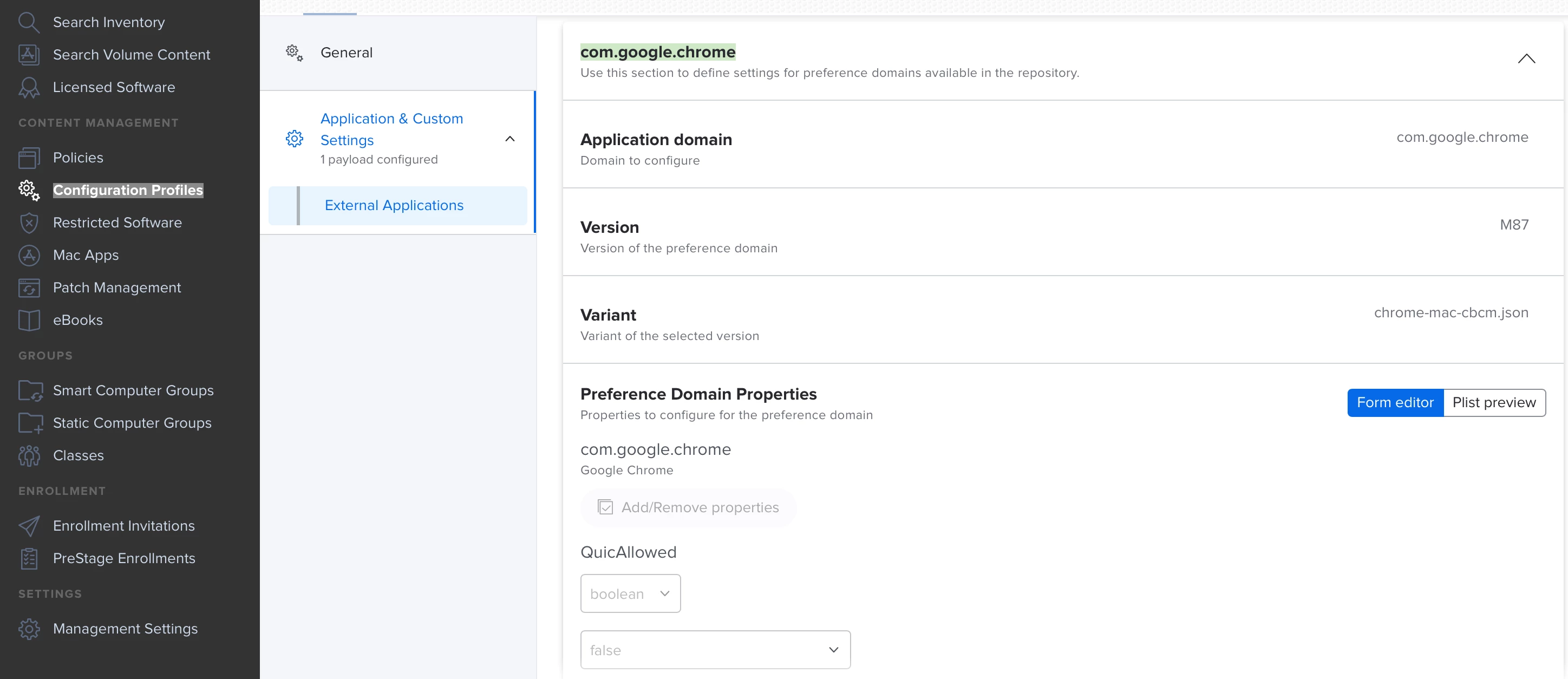

  • May 17, 2022 5:47 PM UTC
@mvu  do you happen to have a screenshot of how the policy is setup in Jamf? I cannot seem to figure it out. Thanks in advance.
mvu
  • May 17, 2022 6:07 PM UTC
@mowtnmn
  • May 17, 2022 6:33 PM UTC
@mowtnmn
Awesome! it worked. Thank you so much.

If you are a Google Workspace shop, you could first push a config profile that forces sign into the browser, making people sign in with their corp creds. After they sign in, Chrome would get 'Cloud' policies from Google Admin, which has a setting to disable QUIC:
Also, whether you set this via config profile or through the admin console, it looks as though it is being enforced, even though when go to chrome://flags and 'Experimental QUIC protocol' it may still say 'Default'.
