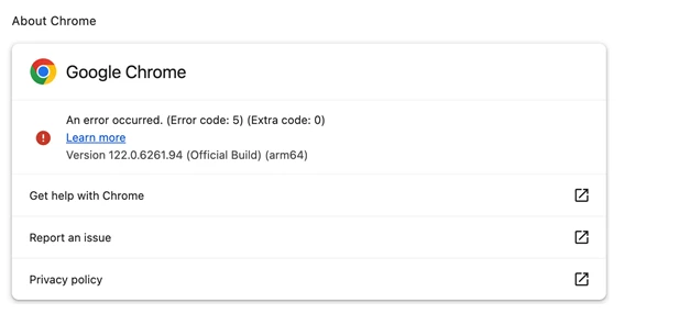

I have a problem with a few users (SVP's) who are getting the error message when checking to see if chrome is updated. They go to about chrome and the error shows below.  We have uninstalled chrome multiple times, I've tried looking up this error message no info found on it, I've put in support tickets unfortunately nothing has worked, I've manually pushed out chrome via a policy and the error still appears I'm now doing the Mac apps the device is up to date but this error message still appears, even when the user was 5 versions behind last year this message appeared.  HELP!!

I ask because we were deploying Chrome via Mac Apps (including the provided config profiles) and were seeing the same thing. We then set the deployment status to off and had a user quit the application and relaunch. The error was no longer present.

This issue has been happening since the upgrade to Sonoma, I stopped the mac apps deployment all together and still received that error message. I was manually pushing out google every week and that was just too tiresome so I tried the mac apps again, but you can choose automatic or manual, manual seems to work for me.  Just need to get this error message to go away.

Seeing the same thing on our end. Turning off mac apps deployment immediately got rid of the error 5 on chrome and edge.

Turning off the deployment in Mac Apps. A lot of us are trying patching with Mac Apps to keep users up to date, but it's not playing nice.

According to Jamf (I've created a tech case about this error) this behaviour is "normal" if Mac Apps is used to distribute and update Chrome as the internal update mechanism of Chrome is replaced by the update mechanism of Mac Apps/Jamf App Catalog.

I saw that same thing. Not sure why it's considered normal behavior, but it seems like Chrome isn't broken, just unable to update on it's own now.
If you look at the App Installer Metadata under the Google Chrome Mac app it says:
"Built-in auto-updates disabled" Yes
so it's normal behavior because the MDM is controlling the update cadence and versioning, and not end-users
