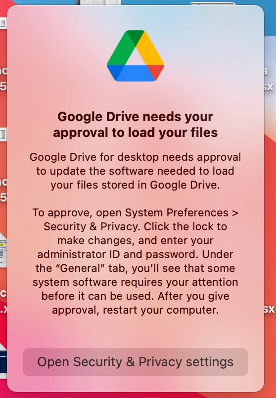

I have been scanning far and wide for a solution that fits just this particular group but I have not found it. I have been mislead with solutions on different processors and different software versions. So before help is given (thank you in advance) please note that I am looking for ONLY solutions that work for Intel based machines that is running Big Sur.
Issue:
Does anyone have a solution for this?

@AntMac My current tester is a Big Sur Intel computer running 11.6.1.(I reformatted and DEPd) Did you login to Google Drive For Desktop when you were testing? my pop-up still comes up and asks me to click 'allow' and then restart that computer.
I followed your clear instructions:
Identifier:
com.google.drivefs
Bundle ID:
identifier "com.google.drivefs" and anchor apple generic and certificate 1[field.1.2.840.113635.100.6.2.6] /* exists */ and certificate leaf[field.1.2.840.113635.100.6.1.13] /* exists */ and certificate leaf[subject.OU] = EQHXZ8M8AV
App or Service:
SystemPolicyDownloadsFolder Allow SystemPolicySysAdminFiles Allow SystemPolicyNetworkVolumes Allow SystemPolicyDocumentsFolder Allow SystemPolicyDesktopFolder Allow SystemPolicyAllFiles Allow FileProviderPresence Allow SystemPolicyRemovableVolumes Allow
  • Nov 15, 2021 5:41 PM UTC
MY response was just marked as spam, @AntMac Did you login to Google Drive Desktop after the imaging process? I still get the pop-up with after logging in.

I was able to log into Google Drive Desktop no problems. Device was originally built with 11.5 and upgraded to 11.6 then 11.6.1. Google drive was not installed until I got to 11.6.1. Config profile was loaded after install of app but before launch.
Wondering if maybe something is happening for you at application install? I did install the application manually not from JAMF Policy. Install performed on standard user account with Admin credential supplied to complete installation. Are you manually installing , using a composer created pkg or some other method?  If using a composer made pkg,  was it captured on a lower OS version? Do you have anything showing in System Information>Software> Disabled Software?
