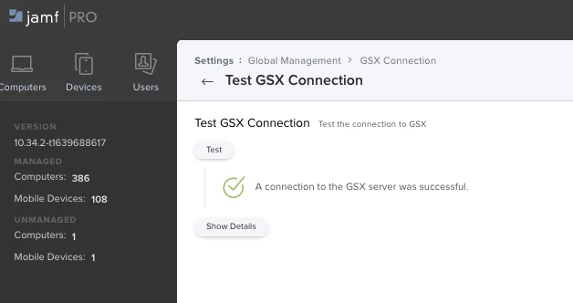

We've just completed our annual Apple GSX Certificate renewal.
We got the new cert, converted it to a .p12, imported into Jamf, clicked 'Test', and got the 'A connection to the GSX Server was successful' result.

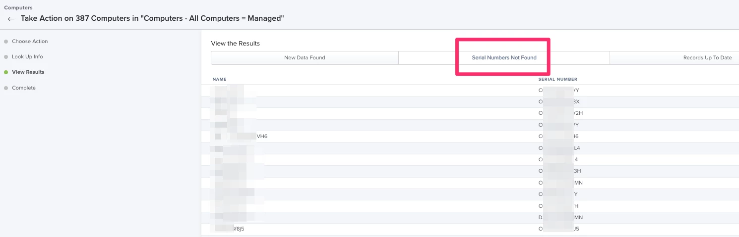

When we run the GSX Lookup on all devices, though, 100% of our inventory returns as "Serial Numbers Not Found"
This worked 2hrs ago on the old cert, so it seems to be a break between the cert and our GSX account.
I'm trying to work this with Apple, but getting to anyone with GSX knowledge is pretty difficult.

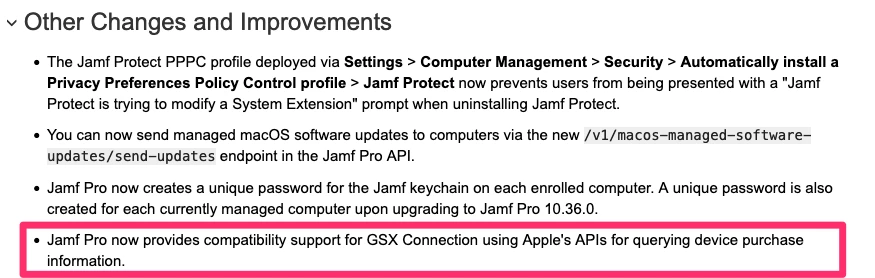

Best answer by jkf
@alexloew, I finally heard back from Jamf Support after 5 days: this is related to a recent GSX API change.
Per my Jamf Support contact:
 - Upgrading to 10.34.6 or newer will fix the issue.
- This was announced from Jamf in the 10.36 release notes here  , but nowhere else (image of relevant section follows). I suggested, and she acknowledged, that as a known issue this could be better documented.
Scheduling our upgrade now, but I'll assume this fixes it, and will update this post if that's not the case.
