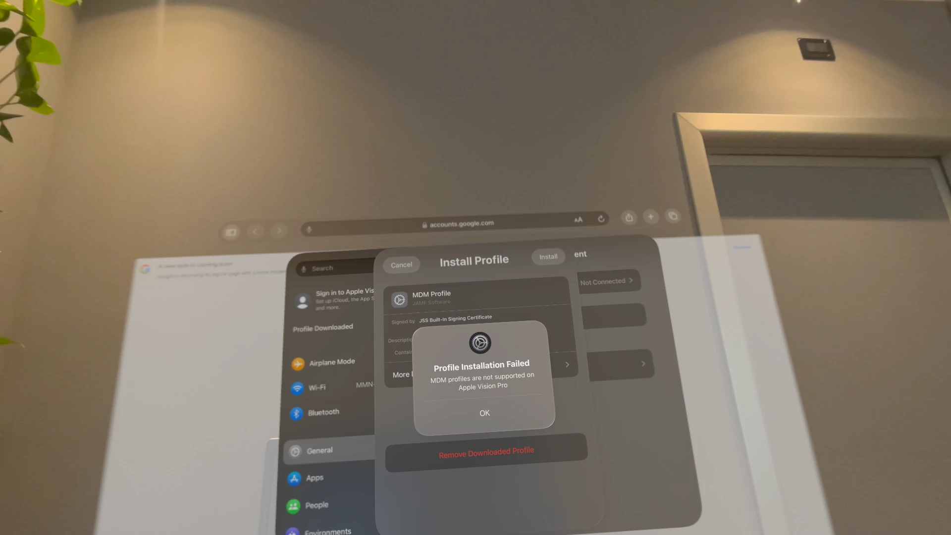

  • Feb 19, 2024 8:49 AM UTC
As expected, enrollment by standard URL https://jamfprourl/enroll doesn't work.
I'm preparing for test Account-Driven User Enrollment
n_lecchi
  • Feb 20, 2024 9:56 AM UTC
I tried Account-Driven User Enrollment, but with Jamf Pro 11.2.1 it doesn't still work.
n_lecchi
  • Feb 21, 2024 11:49 AM UTC
Same issue with Jamf Pro 11.3
On Vision Pro: Sign In Failed Did not receive an enrollment profile from your MDM server.
On iPad:  it works fine

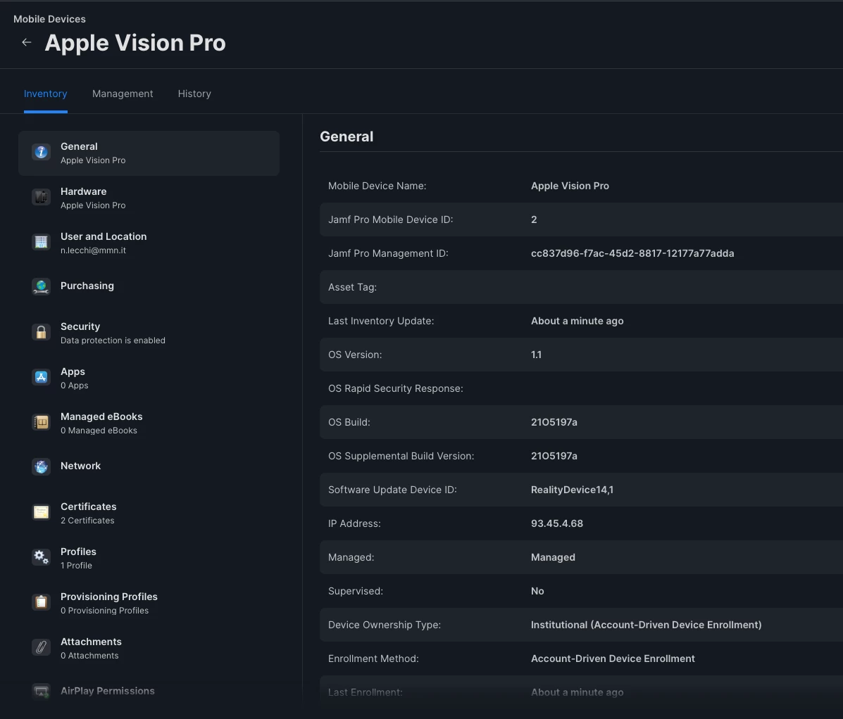

n_lecchi
  • Feb 27, 2024 2:08 PM UTC
With Jamf Pro 11.4 you can support Apple Vision Pro!

Hi ,
Is this showing up under Computers or Devices
  • Jun 20, 2024 8:24 PM UTC
Hi ,
Mobile devices in his screenshot you can see in the upper right hand corner its under mobile!
