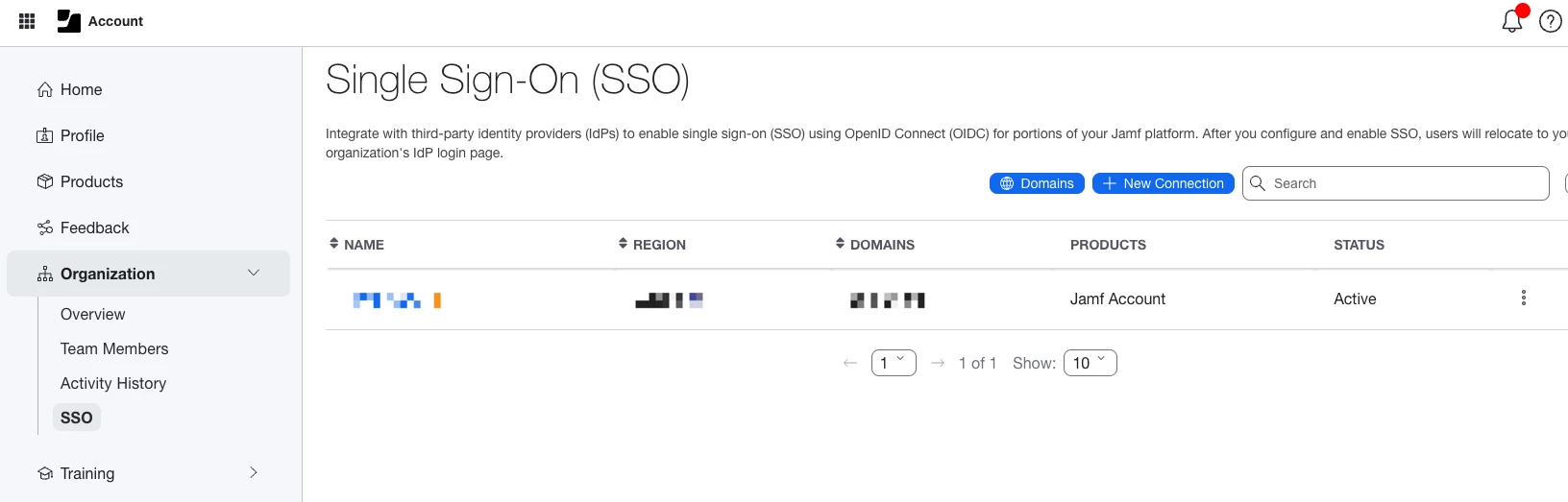

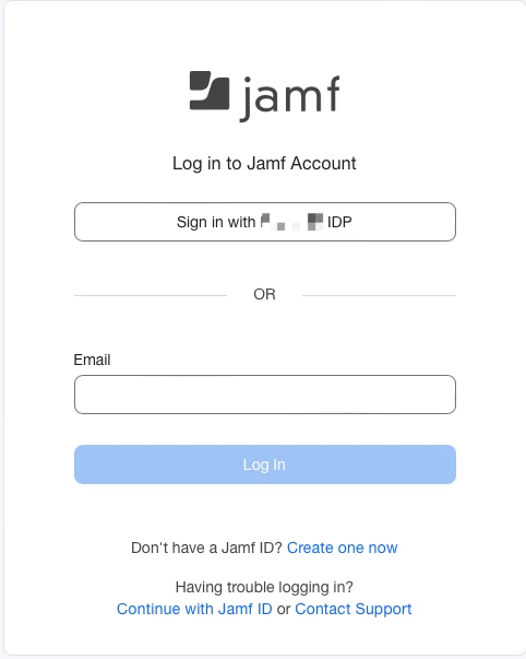

Hi,
we implemented it successfully.
In Jamf Account it looks like the following:

  • Jul 4, 2024 1:04 PM UTC
Hi,
And when logging in to Jamf Account it looks like the following:

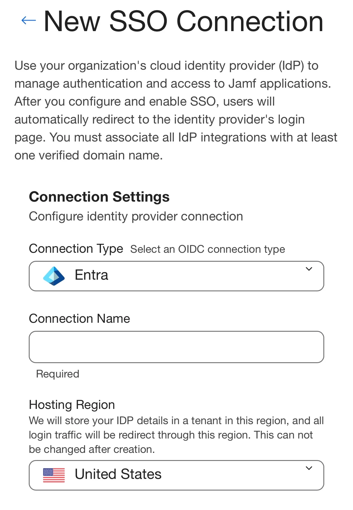

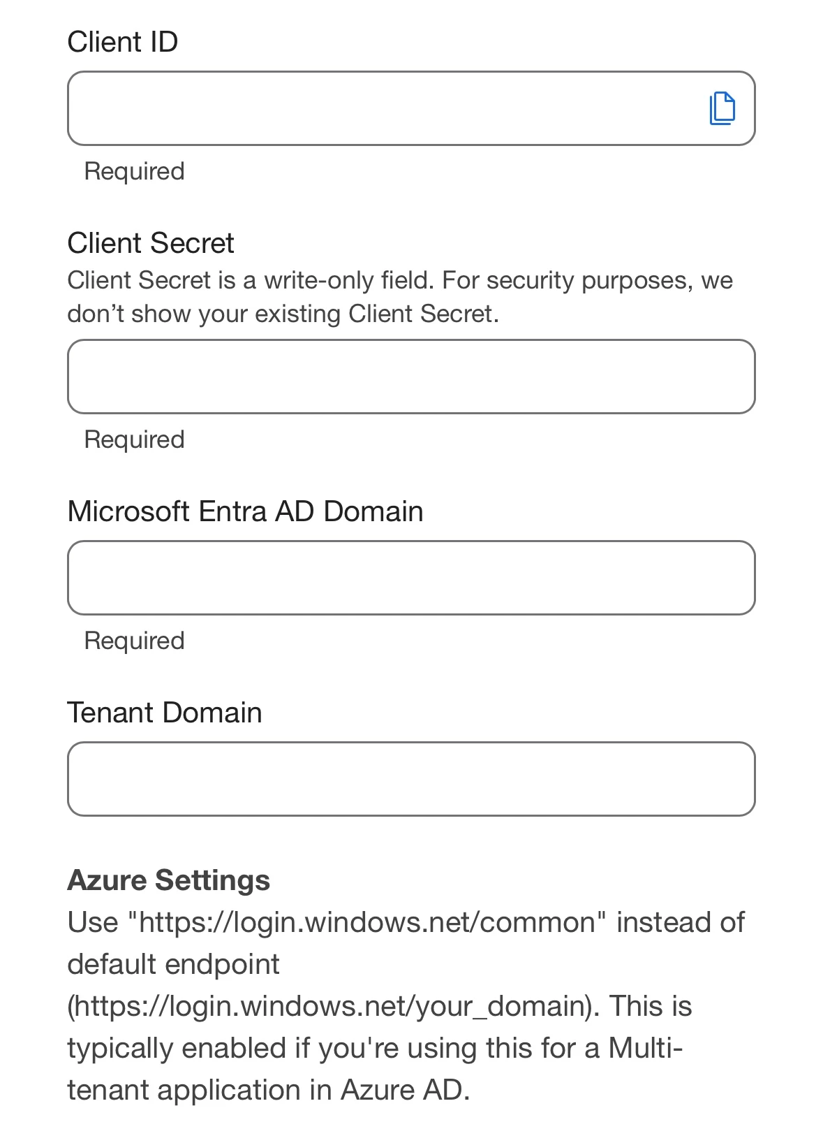

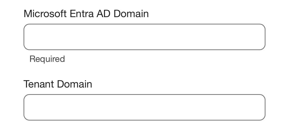

I see. I'll test it as you said. I attached additional pictures, 1. Microsoft Entra AD Domain, 2. Should I leave it blank or enter a value for Tenant Domain?
