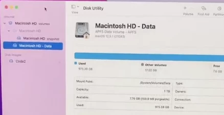

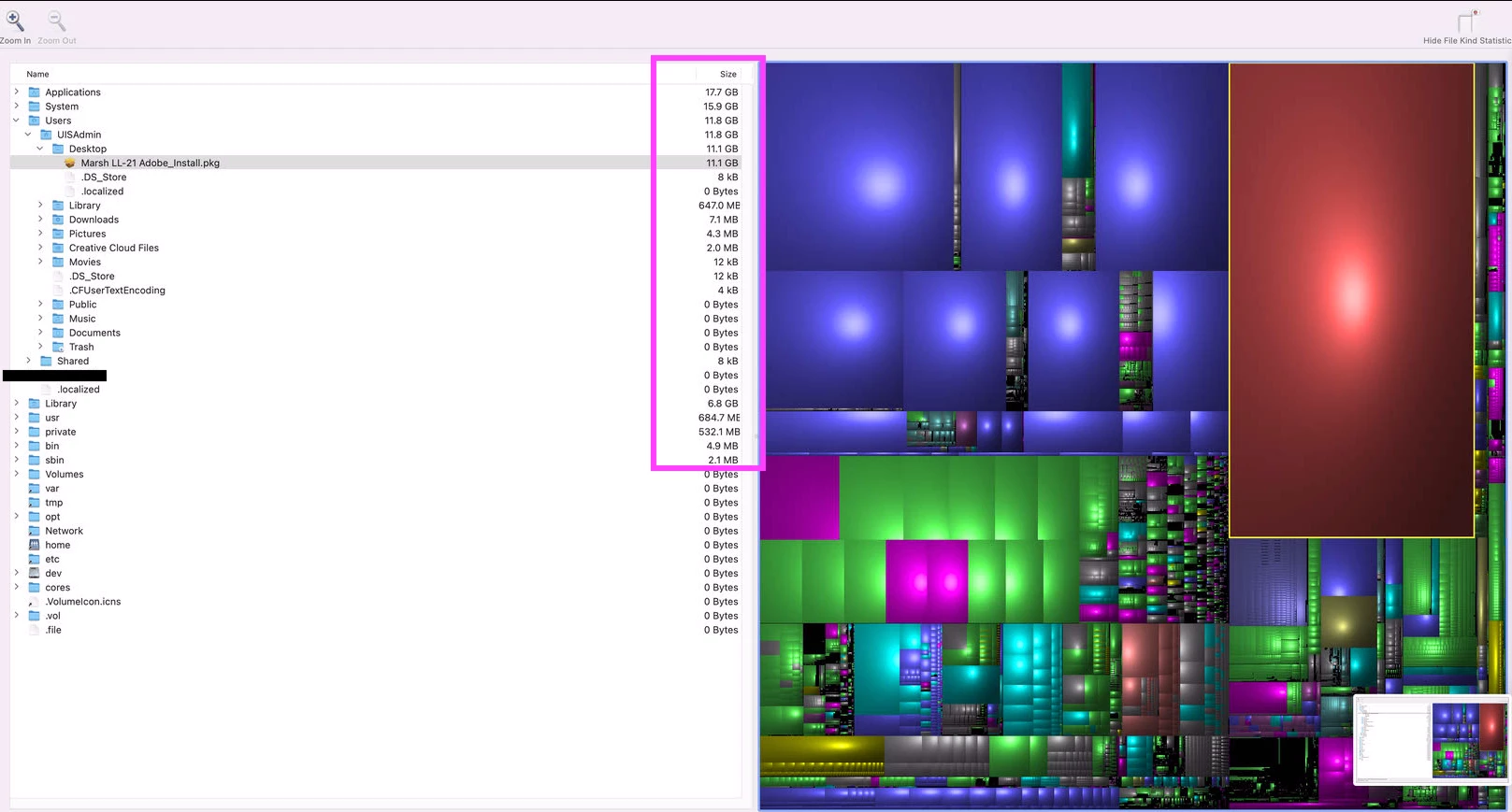

Sorry, I should have included photos in my original post to be more clear (sorry, one was snaped with my phone so it's a bit blurry).
The blurry pic is of Disk utility and it shows that 975Gb are being used in Mad HD-Data (this was zero before I reimaged it).
The other pic is of Disk Inventory X that shows what is being used--it shows only 80 GBs are actually on the machine...disk utility is telling a different story.
@Fox Any chance you've got something being duplicated a _lot_? With APFS a file that's duplicated won't see a the cop(y/ies) take up any space until they're modified, but Disk Utility might not see it that way. Looking at the graphic you posted from Disk Inventory X I'd expect it to show any duplicated files though.
