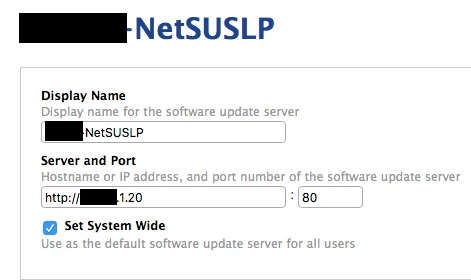

  • May 11, 2017
@mreaso Here's the configuration for my SUS under the Computer Management section of the JSS Settings in case that gives you an idea what's wrong on yours. Note that you don't put the catalog URL into the SUS configuration, just the server address and port. Do NOT leave a trailing / on the server address as the JSS will generate a non-functional combination of the server address and port number if you do.
