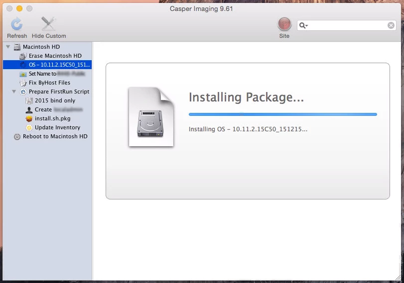

While this is imaging, I have another question: At what point does the dmg created with AutoDMG re-parition the hard drive to lay down the Recovery HD? The question popped into my head while I was looking at what Casper Imaging is actually doing:
  • December 15, 2015

@Kaminski that screen shot is showing Casper Imaging 9.61. I'm not sure that Mac OS 10.11.2 is going to work with that older version of Casper Imaging. I'm using Casper Imaging 9.81 on a 10.10.5 NBI laying down Mac OS 10.11.2 and it is working properly for me. I'm able to get into the Recovery Partition without issues. You might want to check with your TAM regarding compatibility with that version of Mac OS. Also, if you are NetBooting and running Casper Imaging from an NBI, the version of the Mac OS on the NBI can make a difference as to whether you will be able to successfully image.

Hey all. Thanks again for anyone that chimed in. I just wanted to post an update.
I went to 9.82 today and updated the Casper version on your NetBoot ti 9.82 as well. Afterwards I imaged a computer and the Recovery Partition was present. So upgrading the JSS to 9.82 and upgrading the Casper version on NetBoot did the trick.
Thanks again.
