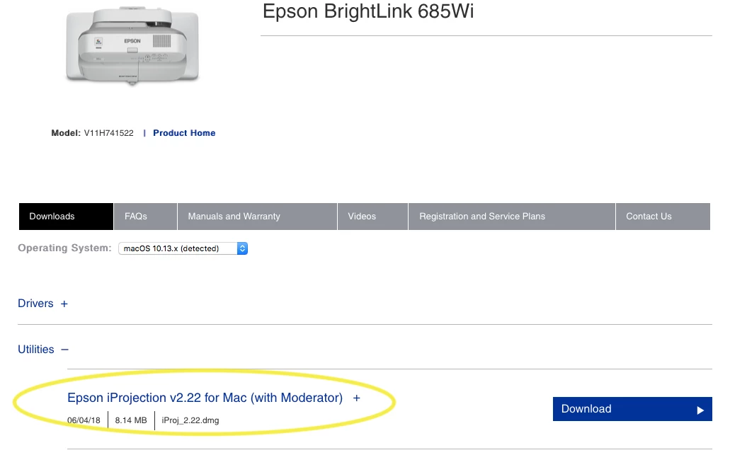

We have a school in our district that has Epson interactive projectors, which uses Epson iProjection software/driver. I have the driver installer working, however, I can't get the iProjection pkg to work.
I originally just pulled the pkg file from the dmg, which did not work after I placed it in Self Service - it just errors out with this from the policy log
Installation failed. The installer reported: installer: Package name is Epson iProjection Ver.2.22 installer: Installing at base path / installer: The install failed (The Installer encountered an error that caused the installation to fail. Contact the software manufacturer for assistance.)
I know that this pkg installer has selectable options - could that be causing it to fail? If so, how can I pre-select options? With a script? With composer? How? I did do a snapshot pkg, but for whatever reason that failed as well. This campus tech is extremely busy with the new building, so trying to do what I can to assist him and didn't realize I'd have so much trouble out of deploying this pkg.
Where to get Pkg is here...picture below of which selection to choose on the site.Epson Software Download Link
