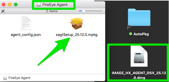

Hello,
I need help with scripting an installation. Forgive me for my lack of skills in the area.
I was given an agent to install. The package and config. file is within the .dmg file. When I try to extract the package to push (ARD or Casper) it fails. The negative package is just a preflight and postflight script.
How would you install this leveraging Jamf Pro? Could I get help with scripting this?
My thought was to:
• Copy the .dmg file to a tmp folder
• Open the .dmg
• Install the package within the .dmg
• eject the FireEye Agent installer
• delete .dmg file

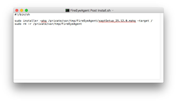

Why not copy the pkg and the config file into a new folder in /tmp/, then drag that folder into Composer's sidebar to make a source and finally add a postinstall script that calls the installer from that location in /tmp/? It would run the install and, I would think, see the config file in the same directory and use it. If I had to guess, the installer package script is likely looking at the running path and looking in that same directory for the config file to use.

@mm2270 I think you're right about the installer package script looking at the running path. I'll give this a shot. Would you use the script above as the postinstall?
!/bin/sh
sudo installer -pkg /path/to/package.pkg -target /
mm2270
  • September 27, 2017
Yes, but drop the sudo. When the package is run by the jamf binary it's running as root, so no sudo is required. Just replace the /path/to/package/package.pkg with something like /private/tmp/FireEyeAgent/xagtSetup_25.12.0.mpkg or whatever the folder name is that you choose to place it in.
So when the custom pkg gets run, it drops the payload into /private/tmp/FireEyeAgent/ and that will have the installer + the config file in it. Then your postinstall script would run the above installer command line. Hopefully that will make it install properly and recognize the config file at run time.

Boom. I learned something today. I was able to package it, copy the files over, install the agent and remove the folder.
Thanks @mm2270 and everyone who chimed in. I know you said drop the sudo, but I'm used to leaving it in.

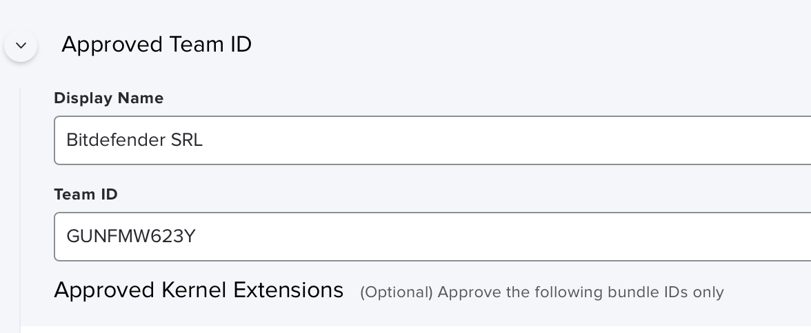

Also, for some reason FireEye is asking for Kext approval from "Bitdender" on Macs 10.13 and up. Looks like you'll need to approve that or have Jamf send a Config profile.
Team ID: GUNFMW623Y|com.Bitdefender.iokit.av|1|Bitdefender SRL|1

Did you get any script working where you are also adding Kext approval for the for the Bitdefender part? I am currently trying to get it working with xagtSetup_32.30.0 on a macOS version 10.15.5.
In case you figured it out would you be willing to share it here?
Thank you very much!

@ddeth I pushed a configuration profile with Approved Kernel Extension ...

So, we're skipping that part by re-packaging the contents inside the DMG. This way, we skip having to mount any DMG.
You'll need to re-package two pieces: the agent config file and xagt setup package, which goes into the tmp folder. If you go back to my 8/21/2018 post above, you'll see the insides of my package. After that, you run a postscript which you can bake into the package using Composer, or use Jamf to run it after.
