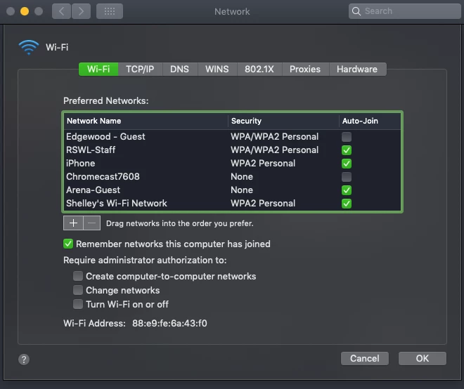

mm2270
  • September 16, 2019
The options in the screenshot above can be set using the airport command line utility.
sudo /System/Library/PrivateFrameworks/Apple80211.framework/Versions/A/Resources/airport prefs RequireAdminIBSS=YES RequireAdminNetworkChange=YES
If you push the above out from a Jamf policy, just drop the sudo since it's not needed.
Note that the RequireAdminIBSS option prevents them from creating an ad-hoc network on their Mac. That'll be a useful option to enable. The RequireAdminNetworkChange option is obvious.
Also note that all of this requires that the users are not local admins or don't have local admin credentials. If they have either, they'll be able to override these options.
Another option you could play with, using the same utility is the RememberRecentNetworks. If that Guest network is not configured for their Macs, then setting the above to NO would mean even after they connect, it would prevent their Mac from remembering the connection. So next time it wakes up, it should not auto reconnect to Guest. The only problem is this would also stop their system from remembering other networks, like their home one if they take the Macs with them. That could be a problem, so you'll have to decide if you want to do that or not.
