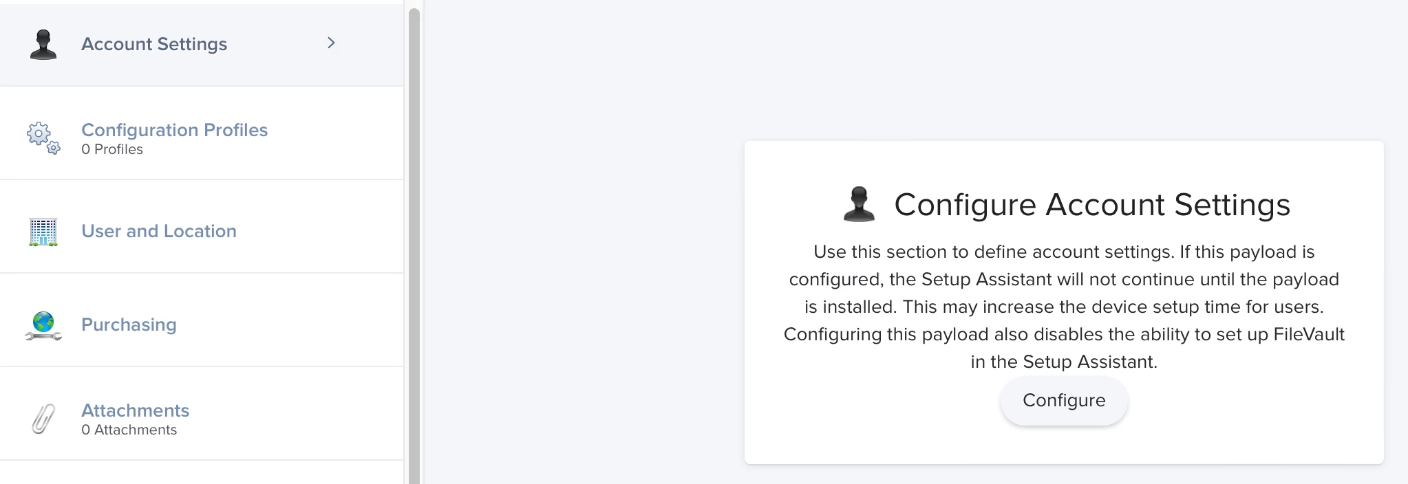

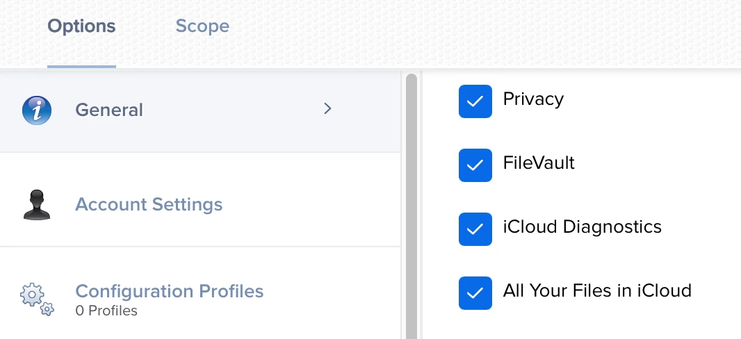

I'm trying to hide FileVault option from being offered in setup assistant during pre-stage, and when I go to customize what steps I want to show, it's greyed out and I cannot skip it. Currently testing on a Mojave machine, but we also are deploying Ventura machines. Looking at Jamf and Apple documentation it seems I should be able to block this, but I can't figure out why its not allowing me to.
Best answer by Bol
Do you configure the 'Account Settings' payload, if so that is by design.
Bol
  • June 23, 2023
So it's a little back to front in whats written (will disable in Setup Assistant) where items you want disabled are ticked. Jamf is actually disabling the check box as empty when I guess it should be greyed out with a tick, if that makes sense.
Yes, I do have that configured, but I see that message there explains why I can't tick the box. The only thing I have set up is pre-filling the user info from the SSO sign-in. I don't quite understand why that specifically would prevent FileVault from being disabled.
Bol
  • June 23, 2023
I believe (might be wrong) unless user creation is completely handed off to setup assistant during enrolment, then filefault needs to be enabled upon login of that user.
