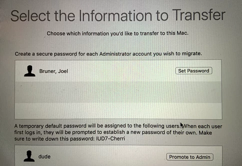

We have mobile AD accounts on our FileVault encrypted Macs running High Sierra and when using Migration Assistant during workstation refreshes we get a prompt that states "A password must be established for each Admin account that you wish to migrate." It then asks us to enter a password for each user that we are transferring. You can enter any password in this field - although I don't recommend that! If you have the relevant user type their password in everything is fine, but if you enter anything else, it sets the user's password in the FileVault reboot to whatever you typed in, but then that is out of sync with their login password so then the machine drops them at the login window to enter their current network credentials.

I have a similar issue... not sure why Apple decided to break Migration Assistant... we've got AD mobile user accounts and Migration Assistant used to be able to handle these without issue. Now it seems that Migration Assistant want to give a temporary password for the mobile accounts but then we are unable to change the temporary password back to their AD password. We use the Users and Group preferences and it says that the temporary password is invalid.

I'm seeing a similar issue with the Migration Assistant (closer to BPHelpDesk's issue), but we are not using FileVault. For us, even if the user enters their existing password when prompted during the migration, it will not accept that password when they attempt to login when the migration completes.

Wow. Yeah, I just did this on a 10.14.3 Mac, using a TimeMachine backup of a mobile account, it's totally reproducible.
It's like they aren't detecting if the account is Mobile or not and just doing the same thing as it was a local account.

OK - but let's say you've migrated a Mobile Account, the password is mangled, the temporary password is not working and you just need this @$!* to work right now!

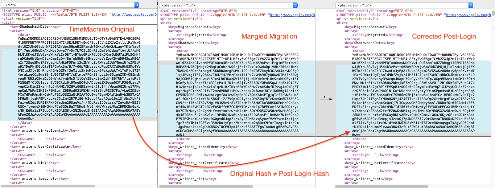

Copy the user record from the source to the target
1. Open Terminal
2. Make a backup copy of the mangled user record for posterity, copy in the new one, then copy and convert to ASCII for analysis:
#fill these in with correct values
userToMigrate="user"
sourceVolume="/Volume/Macintosh HD 1"
#back it up to look at later
cp /var/db/dslocal/nodes/Default/users/${userToMigrate}.plist /Users/Shared/${userToMigrate}-migrated.plist
#copy the working user record from the source Mac to the current Mac
cp "${sourceVolume}"/var/db/dslocal/nodes/Default/users/${userToMigrate}.plist /var/db/dslocal/nodes/Default/users/${userToMigrate}.plist
#if you copy the plists and convert to ASCII you can better see the differences:
cp "${sourceVolume}"/var/db/dslocal/nodes/Default/users/${userToMigrate}.plist /Users/Shared/${userToMigrate}-original.plist
plutil -convert xml1 /Users/Shared/${userToMigrate}-migrated.plist
plutil -convert xml1 /Users/Shared/${userToMigrate}-original.plist
The user should be able to login at the login window now... if not reboot, but Directory Services should pick up the change right away
For extra credit fire up FileMerge and behold the mangling...
Note: Since the hash even changes once corrected post-login (yet is is still the same password) I just wonder if Apple started using a new one way hashing methods and wanted to ensure all account passwords are updated with this method?
There had to be some motivation to introduce this temp password thing, but apparently not enough oversight to test workflows that use Mobile accounts!

When the Mobile Users is restored if you are offline/off-domain when you login it will use the temp password (and ask you to reset your Keychain password to that temp password), once you connect to the domain if you go back to the the login window it should accept you AD password if properly bound. I am still not sure why the temp password was not working nor the AD password when I was on the domain in earlier tests but I can't recreate it anymore.
In the latest test I restored an AD user while on-domain, taking a temp password
At login I unplugged the network adapter and the temp password was used
Rebooted and FV POA also took the temp password
On 2nd reboot, plugged in, FV POA took temp password, but stopped at login window wanting the AD password, it was accepted
3rd reboot, the temp password was still being used by FileVault
4th reboot, giving it a chance to Do the Right Thing™ it doesn't, still the temp password

It seems the better 'fail-safe' method to ensuring the password is the same with no shenanigans is to simply click the Promote to Admin button, then you may specify the password to be used and ensure it is the same as the AD password.
