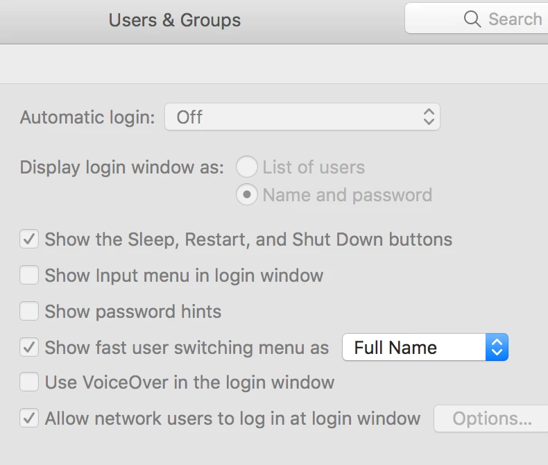

Something we notice whenever something is wonky with the cached mobile account, the option "Allow network users to log in at login window" is missing:
