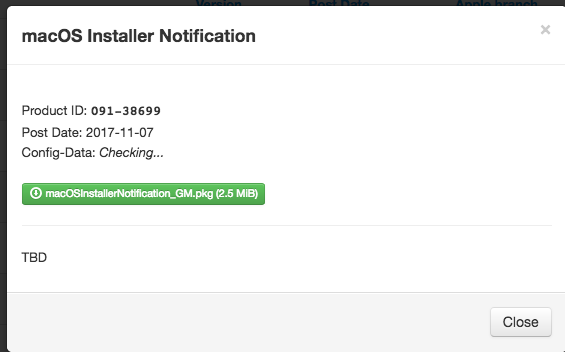

  • Nov 14, 2017 2:43 AM UTC
remove this update from last week:

  • Nov 14, 2017 1:41 PM UTC
@gskibum Yes . Apple pushed that update on Nov 7th. And the notification started. If your machines are set to autoupdate, they received this update. I provided the ID in case you wanted to roll it back or remove it from your SUS

jmahlman
  • Nov 14, 2017 1:59 PM UTC
@Nix4Life I think you may be confusing them with your wording.
If you have an internal software update server (above is a screenshot of resposado/margarita) you can remove that update from it. However I can tell you from experience that it doesn't work all of the time for some reason.

jmahlman
  • Nov 14, 2017 4:28 PM UTC
@gskibum Sorry for the confusion here; the "update" we were referring to is actually a config that gets added to software update servers. It's something that usually gets installed on machines even if autoupdates are disabled (it's the last checkbox I think)
If you have all of those checkboxes off, then you may have to consider a more drastic option: block something on a firewall (maybe the apple update servers) but this will stop all apple updates from working.
So, the best method is to not list it on your internal update server. If you don't have one, you have to block the server.

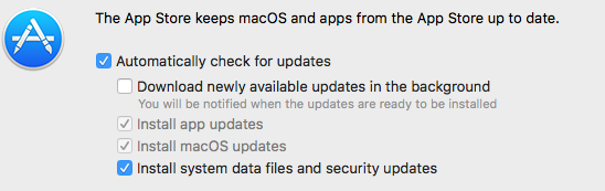

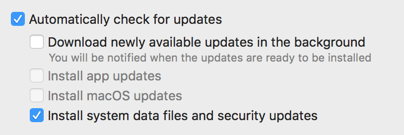

  • Nov 17, 2017 2:01 PM UTC
I found that all our Macs have downloaded the High Sierra installer without permission from anyone. I used ARD to delete it from /Applications/ on every one of them. A few days later I found that it was re-downloaded on all the computers again. This is really getting obnoxious that Apple is "trying to make things easy" when in fact they are making it way more complicated for those of us in corporate environments. My next attempt to stop this is to just create a blank file called "Install macOS High Sierra.app" and lock the file down so it can't be replaced with the real deal.

To prevent the automatic download of the HS installer, I am going to follow the suggestions posted here by @rtrouton https://derflounder.wordpress.com/2016/10/03/managing-the-automatic-download-of-the-macos-sierra-installer-to-compatible-macs/
I've changed our version of the script to set the App Store prefs as follows:

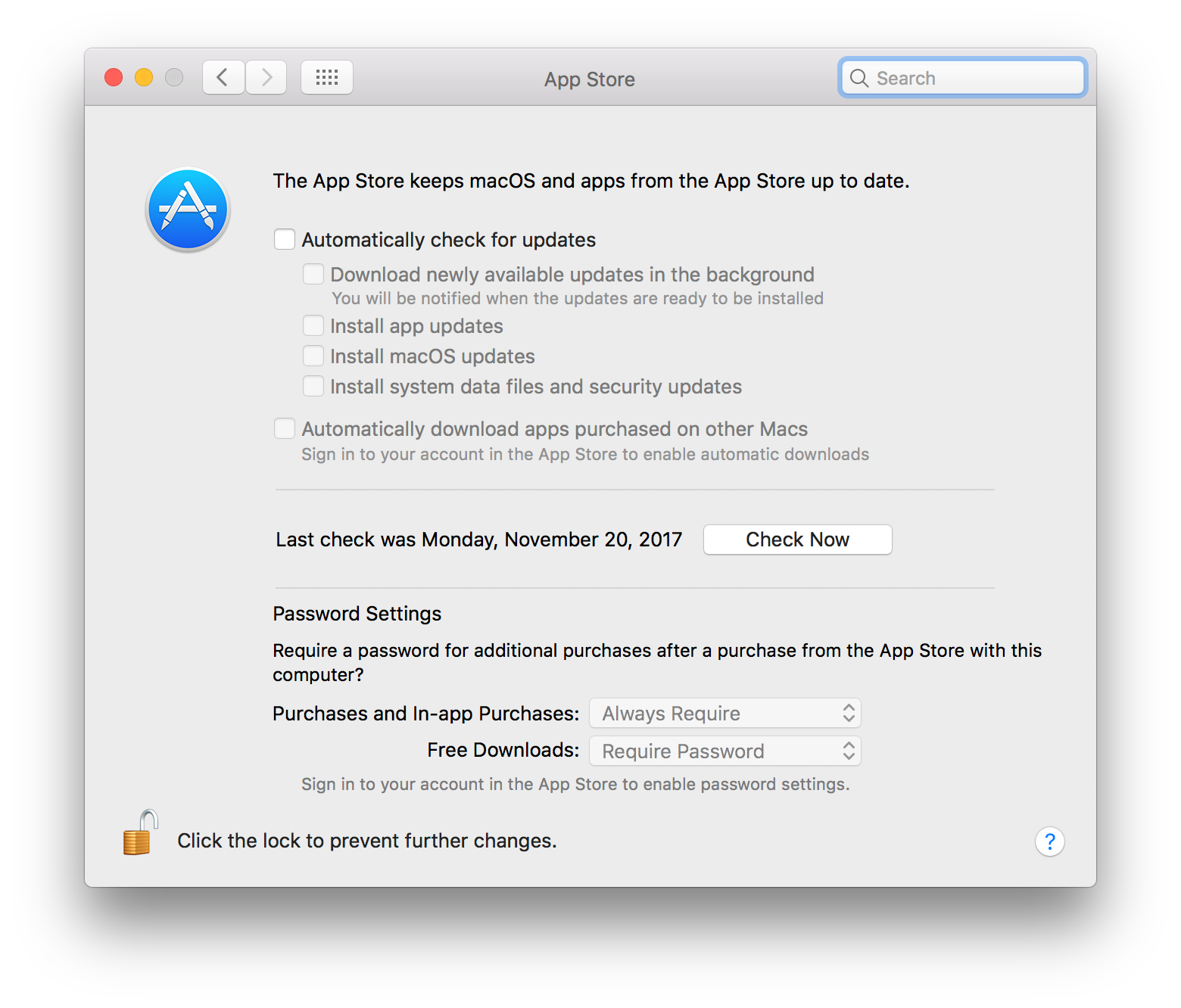

gskibum
  • Nov 20, 2017 2:07 PM UTC
Since I push the "softwareupdate --schedule off" command daily, this is what the App Store pref pane looks like. But Apple is still pushing the High Sierra installer onto many of these boxes.
But I suspect the download is being triggered either by my daily "softwareupdate -da" command or my daily XProtect-Gatekeeper update script I run.
