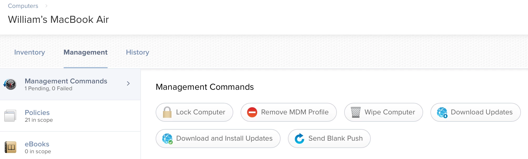

When your MDM profile doesn't allow removal, you can go into your Jamf Pro server, locate the computer record, click the Management tab and click the Remove MDM Profile button there.
This only removes the MDM profile. It doesn't remove Jamf Pro management.
You can restore the MDM profile by running sudo jamf mdm in Terminal on the Mac, but on updated High Sierra Macs, you or the user will need to Approve the MDM profile. This also means any admin user on the Mac can remove it now. Standard users can't remove the MDM profile whether installed via DEP or this method.
