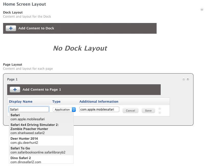

I'm trying to configure a home screen layout on JSS 9.9 and iOS 9.3.1, but don't know what to put in those fields for the configuration profile. Has anyone had any luck with this? We also have existing webclips we would like to configure to home screens.
24 replies
  • April 7, 2016
If you type in the app name, it should populate its bundle ID.

two apps with similar names can be hard to find through the search. It's important to pay attention to the 'additional information'. And hope there are 4 or less 'conflicts'; otherwise the app you're looking for may not be displayed in the results.

Some of the bundle IDs do not come up in search. Here is a list of Apple ones:
