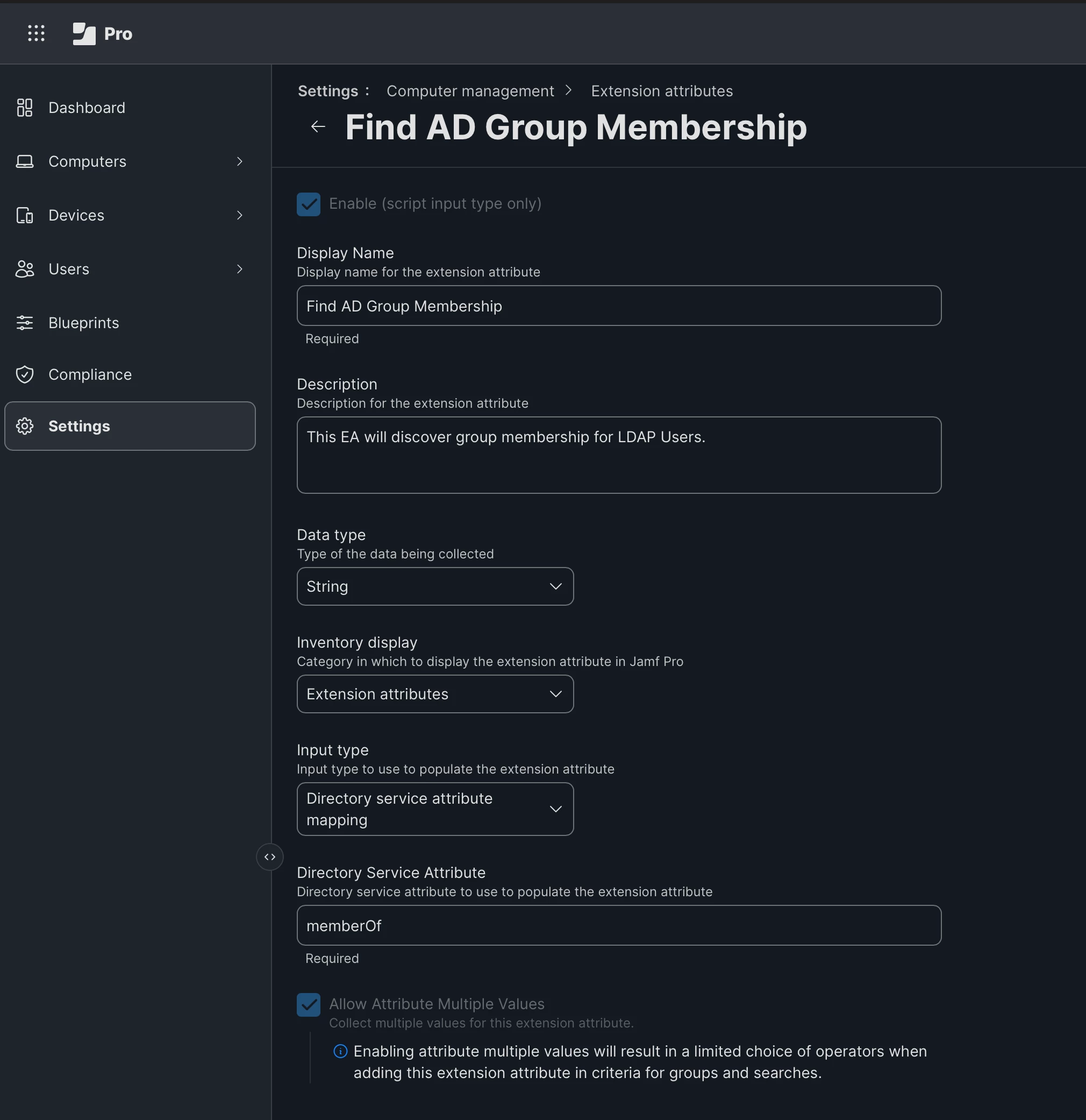

  • Oct 14, 2025 5:24 PM UTC
Not sure you need the custom EA for this anymore.  It got added into Jamf’s built in stuff a few versions back.  In our environment, we’re just using Directory Service Attribute Mapping of memberOf.displayName to list out all the assigned user’s groups in Azure.
MemnochTheRed
​@McAwesome
 Awesome. Will you direct me to more details of setting this up?
MemnochTheRed
​@McAwesome  Nm. I found it.
Create an Extension Attribute in Jamf Pro:
  • In Jamf Pro, navigate to Settings > Computer Management > Extension Attributes.
  • Click New.
  • Configure the extension attribute with the following:
    • Display Name: Provide a descriptive name (e.g., "Azure AD Group Membership").
    • Data Type: Set this to String or Text as it will store group display names.
    • Input Type: Choose Directory Service Attribute Mapping.
    • LDAP Attribute: Enter memberOf.displayName. This tells Jamf to retrieve the display names of the groups the user is a member of from Entra ID.
    • Allow multiple
whiterabbit
  • Oct 15, 2025 8:00 PM UTC
  • Click New.
The documentation (Jamf’s and Microsoft’s) and the AI assistant are ALL wrong (or incomplete).  You guys are right, memberOf is just an object id or something and not the name, the name requires the displayName property.  This may have just made Jamf Pro usable by itself.  Much thanks!

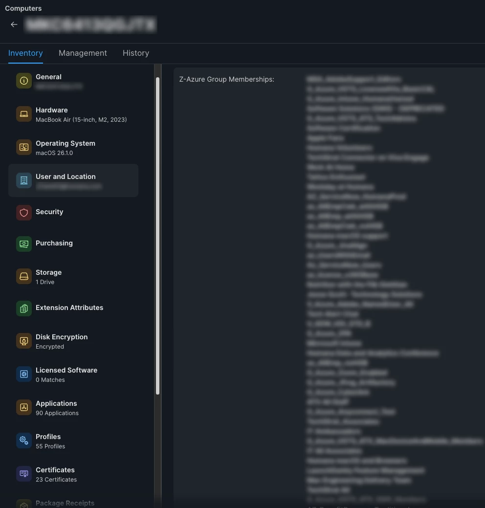

  • Dec 10, 2025 11:59 AM UTC
Great option since jamf 11.18.0 and is there any way that we can get only user is part of the specific group via extension attribute looks getting all the group is unnecessary
mvu
  • Dec 10, 2025 1:43 PM UTC
What we have for computers and devices. Then we create smart groups off it.
MemnochTheRed
No. But I organized our set to be displayed under ‘User and Location’ and named it ‘Z-Azure Group Memberships’ so that it would be at the very bottom.
