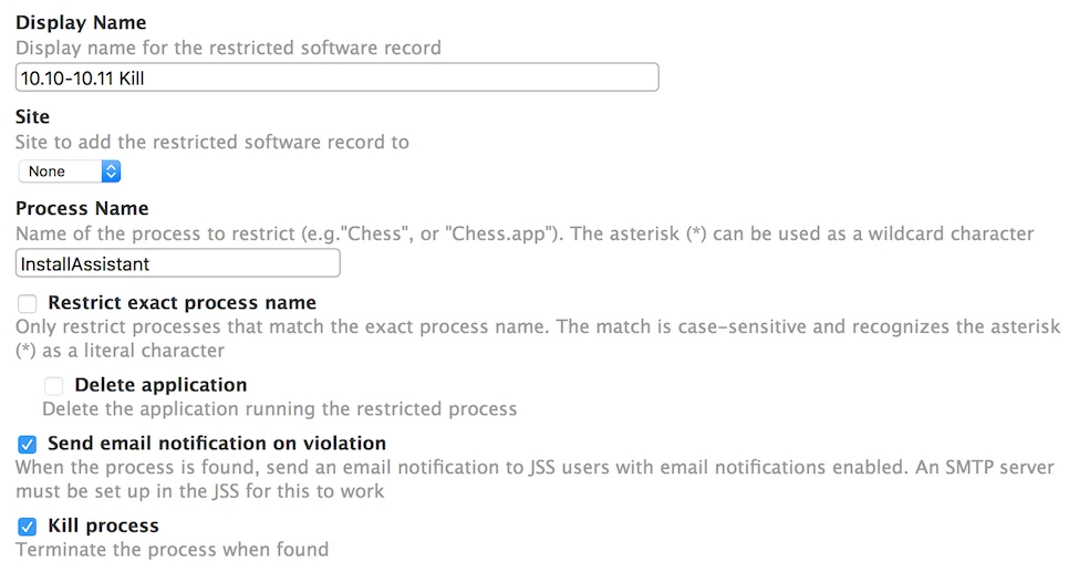

We do it for 10.10 and 10.11 using the following:
Restrict process name: "InstallAssistant"
Looks like this:

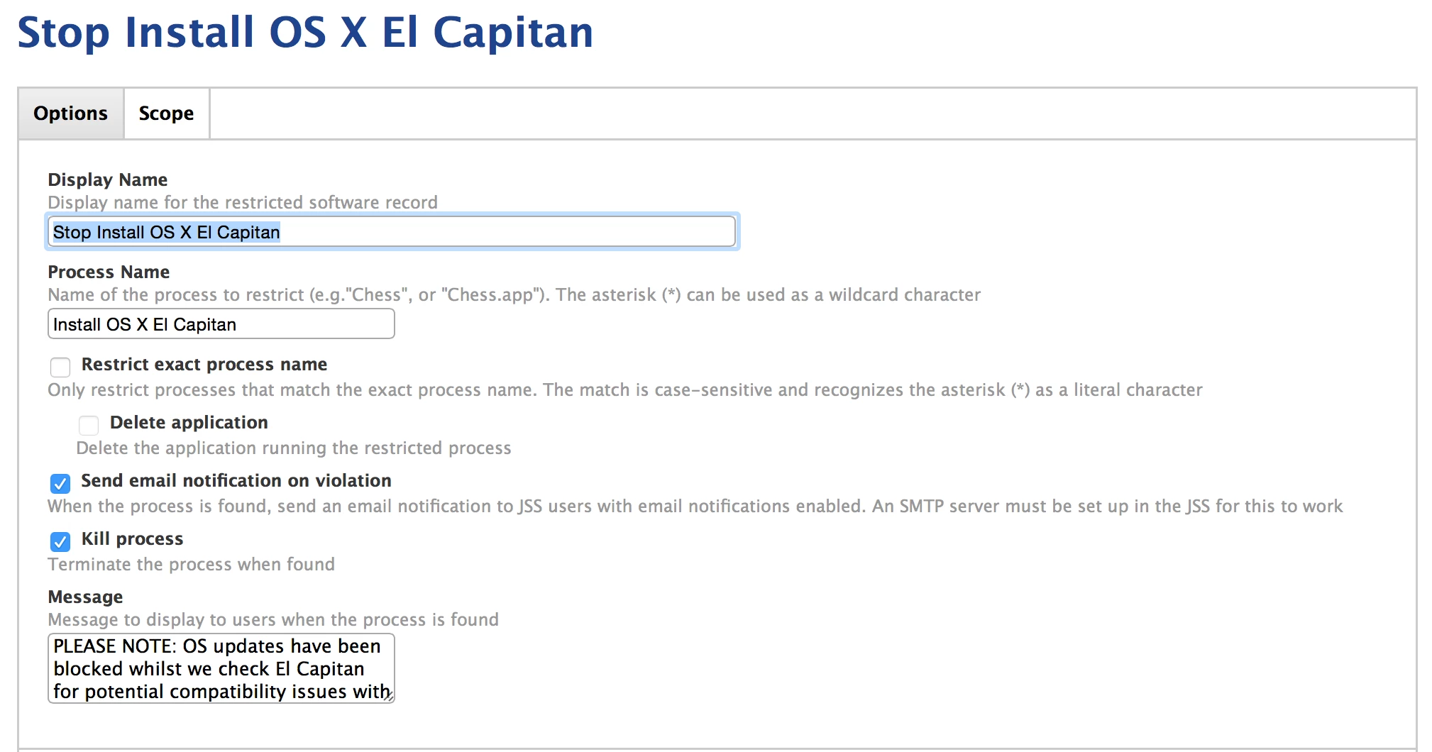

bentoms
Forum|alt.badge.img+35
  • September 14, 2015
This is what we're using for 10.11
