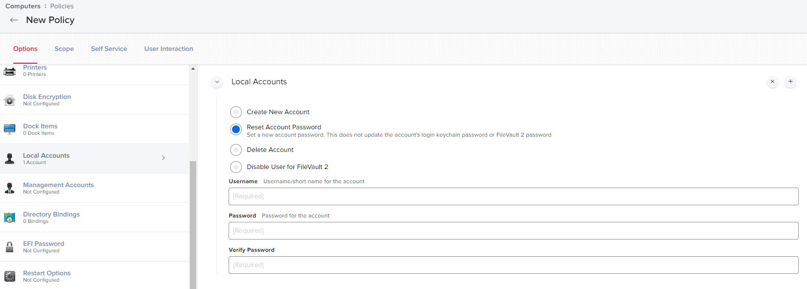

Hi, we are very new to JAMF pro having recently updated from JAMF now.  We've just had to share our local admin password with a remote user and would like to now have this changed.
Can this be changed manually without any need for scripting if so how? Thanks in advance
Best answer by Danolman
Create a new policy and select the Local Accounts item. You can select the Reset Account Password item and enter the account name and new password!

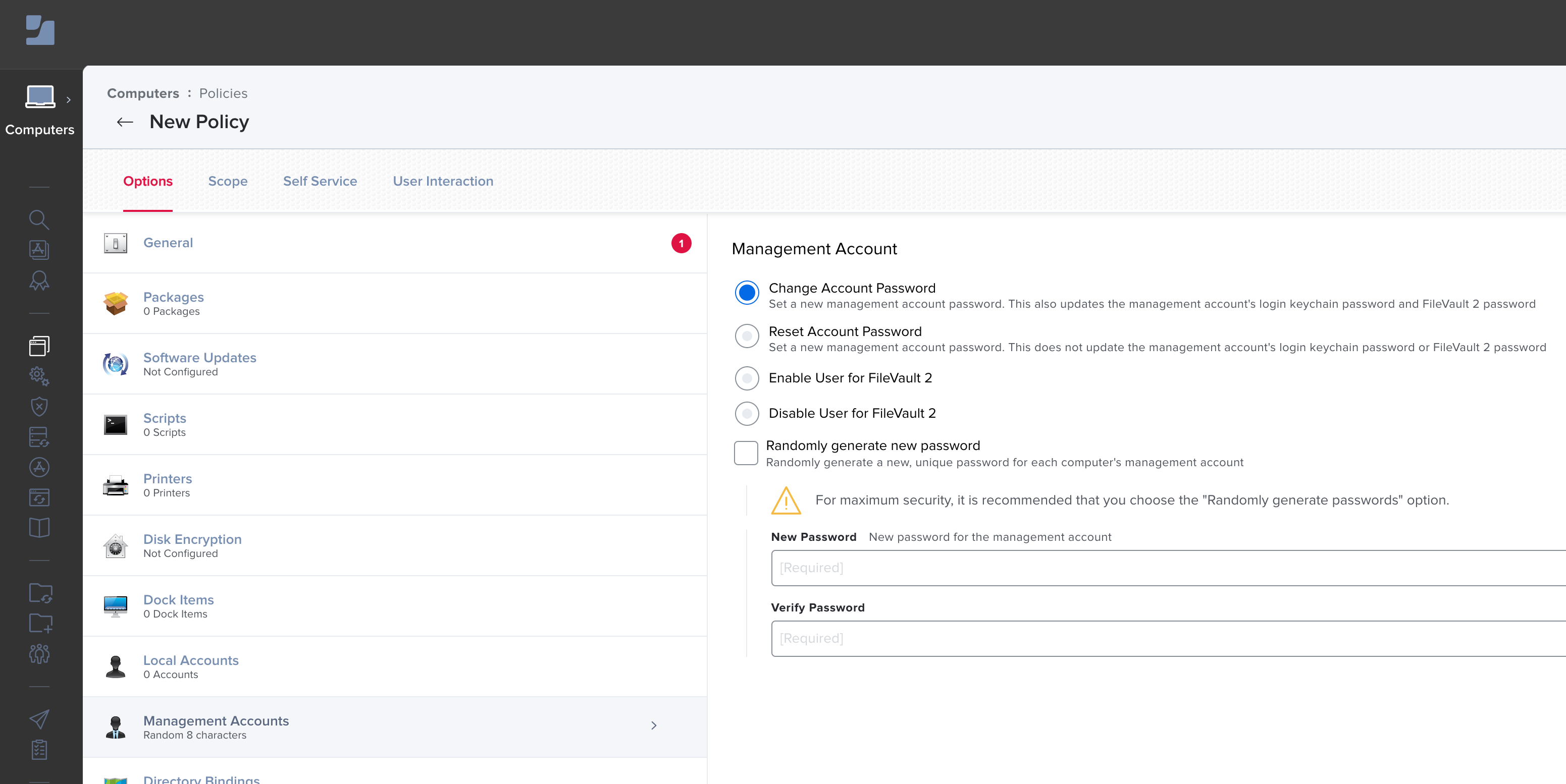

If the local admin account you are referring to is the Jamf Management Account, you will have to use the Management Account option and select Change Account Password. Otherwise use @Danolman's solution.

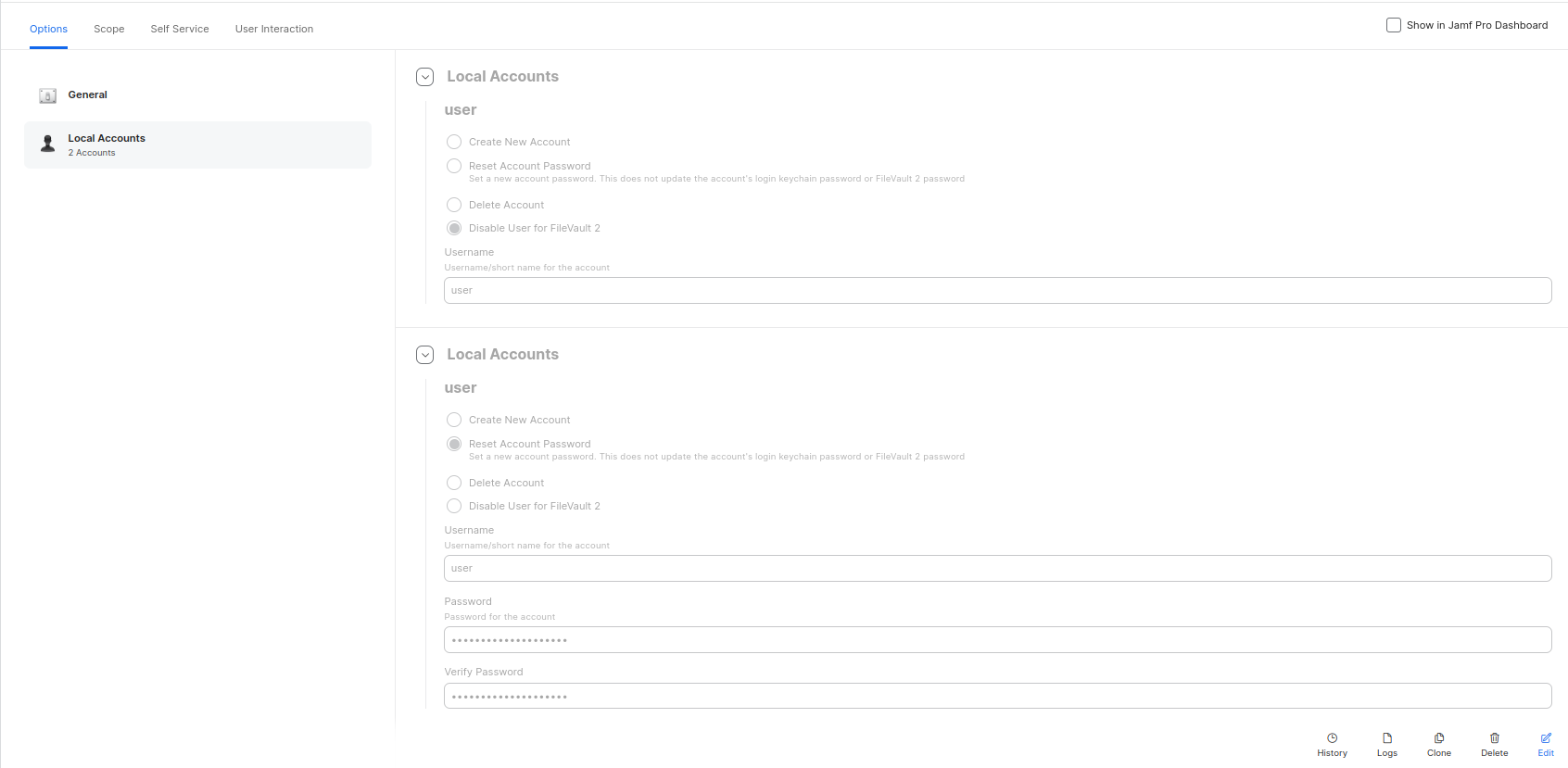

  • May 21, 2024
It didn't work for me until I added the Disable User for FileVault 2 action before the Reset Account Password. But now I'm worried about what this led to, what are the consequences of me turning off FileVault for the user
