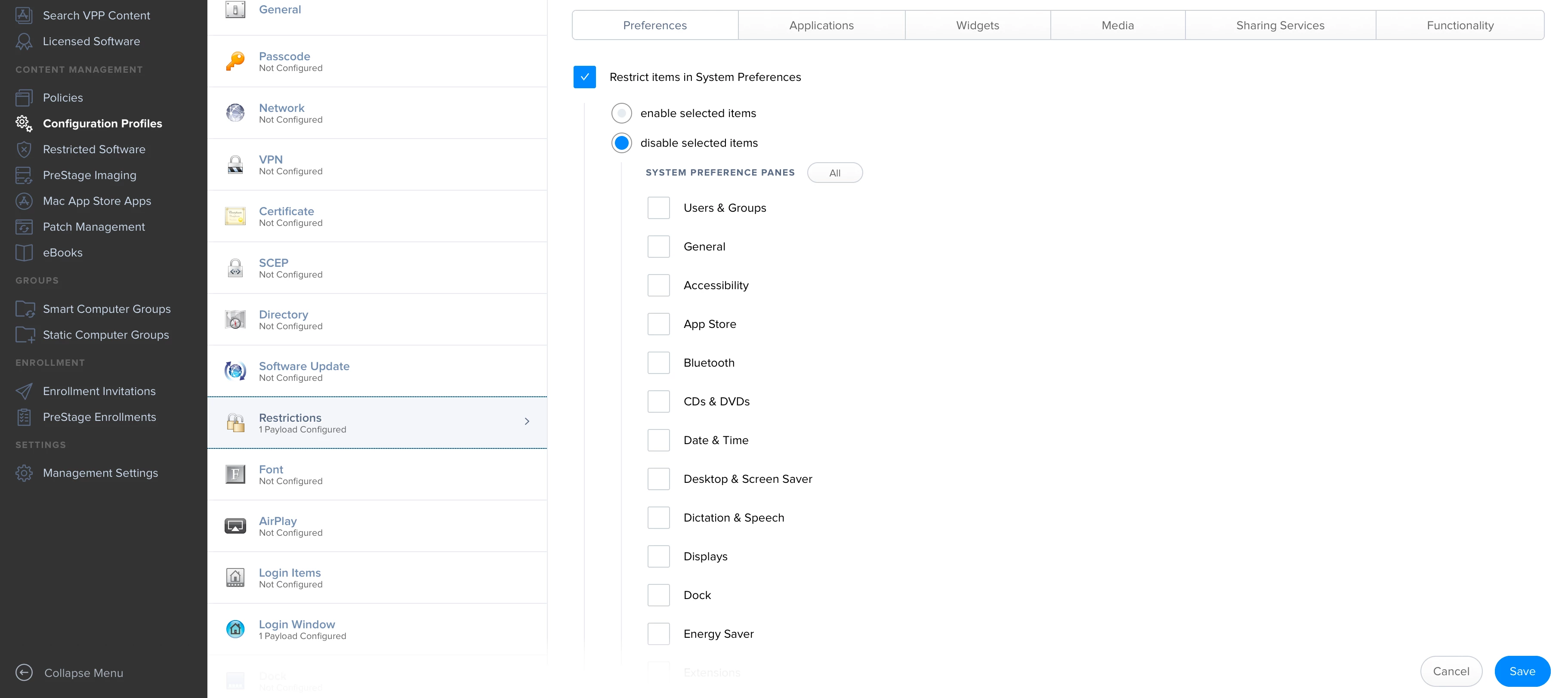

Create a Configuration Profile, go to the 'restrictions' payload, then check Desktop and Screensaver Box
  • November 19, 2018

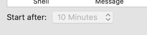

This is what it looks like on my Mac after being set.
Good luck.
Thanks for the reply. So, essentially you have to stay within the confines of the GUI. So, there is not an option to exceed 1 the hour that is in there.
