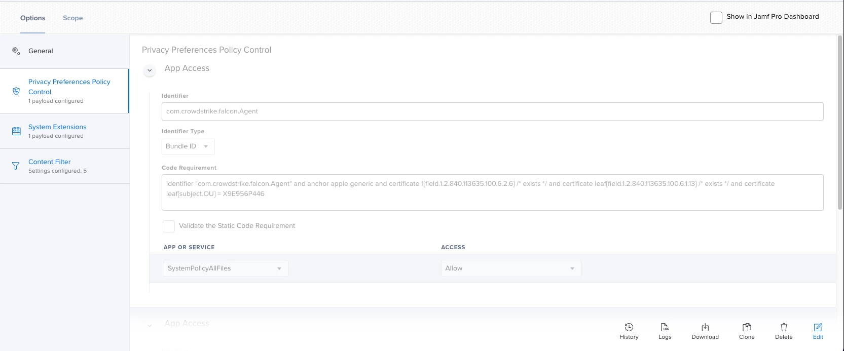

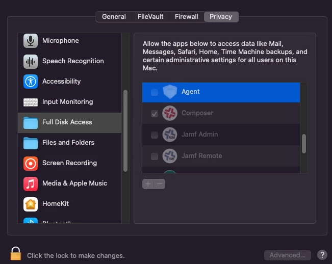

We currently are trying to setup Crowdstrike Falcon to deploy to all of our end users. We are running into an issue with the Configuration profile we setup for falcon (guide provided by CS) where it's not providing FDA access to the Agent. It places the Agent in the FDA area in System Prefs -> Security & Privacy -> Privacy -> Full Disk Access but it leaves it unchecked.
Does anyone know a solution to getting this checked with JAMF?
Here is a screenshot of what  I'm referring to:

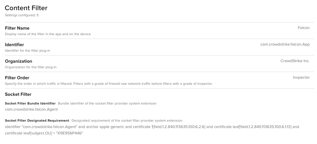

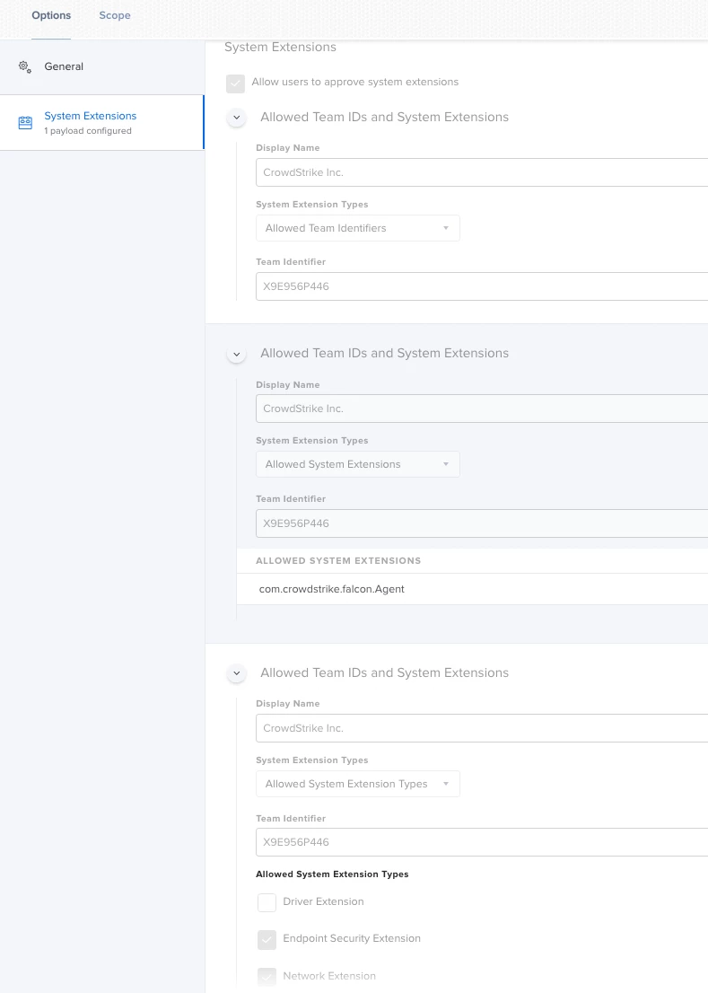

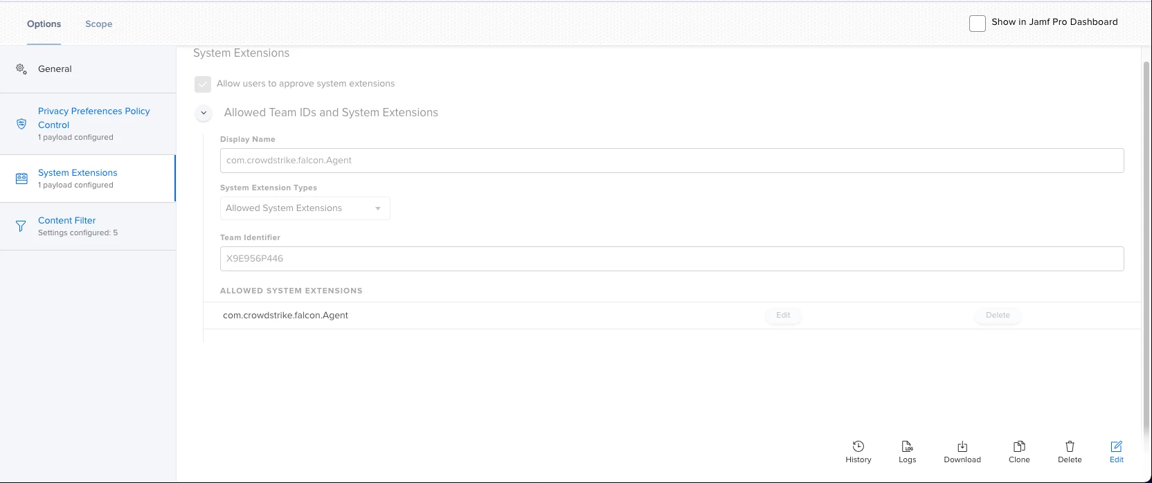

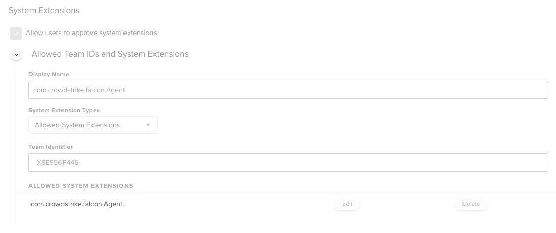

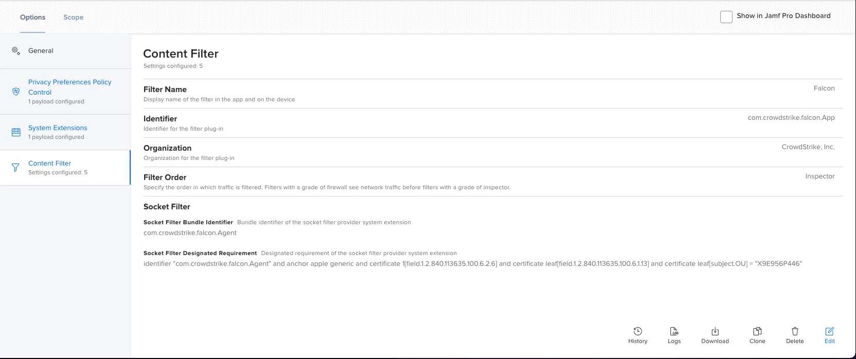

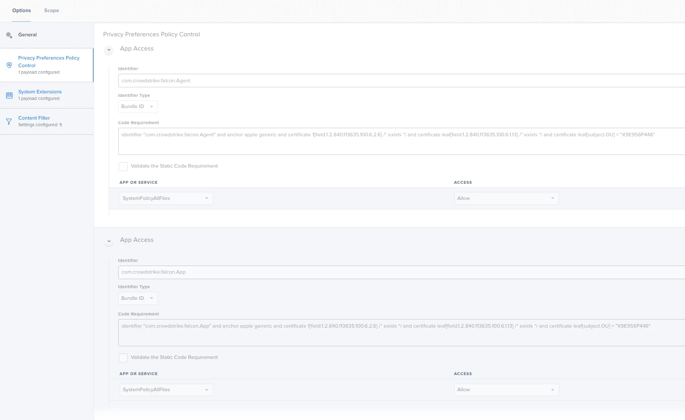

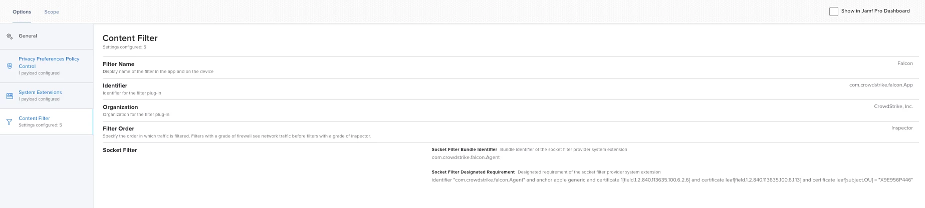

Please find screenshots of our current config profile for Falcon in JAMF below:

When pushing a profile to provide FDA, it will not always put the check box there, but understand that FDA has been provided.
MPL
  • February 11, 2022
We aren't receiving alerts in our CS console for sample detections. We receive these alerts when the Checkbox is ticked for the CS Falcon agent. When unticked, those alerts do not work.

Another nice-to-have in your config profile is allowing notifications for com.crowdstrike.falcon.UserAgent.
  • February 14, 2022

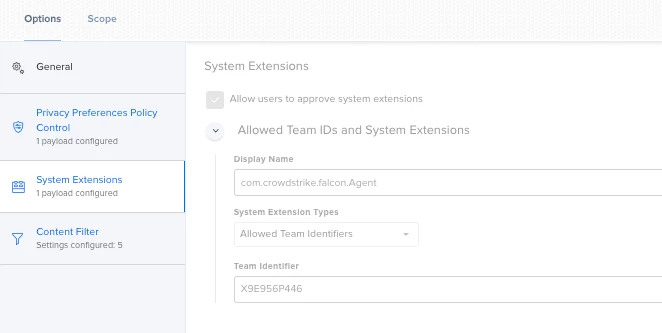

Hi, you're missing a couple of System Extension settings from Crowdstrike guide.
Forum|alt.badge.img+15
  • February 14, 2022
The guide has been updated. The only System Extension approval needed is your middle one.
Content filter settings are also required.
  • February 14, 2022

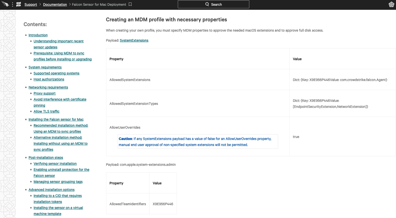

  • February 14, 2022
Unfortunately, their documentation doesn't all align at the moment.
I would go with this which was just updated last week.

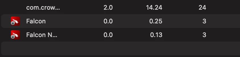

  • March 11, 2022
Hi all.
Just got off of a long call with CrowdStrike and you will never see the "Agent" box checked in the "Security and Privacy" and that has to do with the MDM and Apple's Full Disk Access security, however that doesn't mean that the Agent and the CS Sensor still does not have Full Disk Access to your machine.   If you find where you are still not getting events reporting in, here is the fix: 1) Re-run the profile to all your machines 2)Flush all your Crowdstrike install policy logs to your machines.  This will not re-install the Sensor on your machines but will force two things to happen.  It will force the System Extension to reactivate on the machine and the Sensor to reactivate on the machine.   You should see this in Activity monitor if it is done correctly.  Then run
bash crowdstrike_test_low
on a test machine.
This should give you a sample detection on your CS console to look at.

  • July 11, 2022
I am still having issues with getting Agent and Falcon.app in Privacy to be ticked for FDA. I also want to confirm what everyone is saying here. Are you all saying that FDA is allowed for both Agent and Falcon.app even though it is not showing in Privacy for FDA. I am looking at the Zero Trust Assessment in CrowdStrike and I am getting an alert that it does not detect FDA for CrowdStrike. I checked and saw my PPPC matches what has been suggested by CS, JAMF, and the screenshots here. Is anyone still having problems?
husnudagidir
  • July 19, 2022
I'm still having problems. The full disk access box is not checked. In the full disk access section, it is said that full disk access is required for both "Agent" and "Falcon". When I send the configuration file to the clients, only the object named "Agent" comes. However, the full disk access box is not checked. I haven't seen anyone able to fix this problem. The object named "Falcon" never comes to the full disk access section. Is there anyone who can solve this problem? I've looked at both the Crowdstrike and Jamf forums but haven't found a solution. Some here are saying that Falcon actually has the FDA, even if the full disk access box is unchecked. How could this be? This explanation makes no sense to me.
scottb
  • July 19, 2022
There are a number of apps that are correctly managed and don't show it in the GUI.
If you have it setup properly, I'd not worry about it.  It's been stated in most places I'm frequenting that this is how it is and it is as well in my environment...no issues that we've found.
IF this isn't to your liking, open a case with Falcon and have them work with you.
