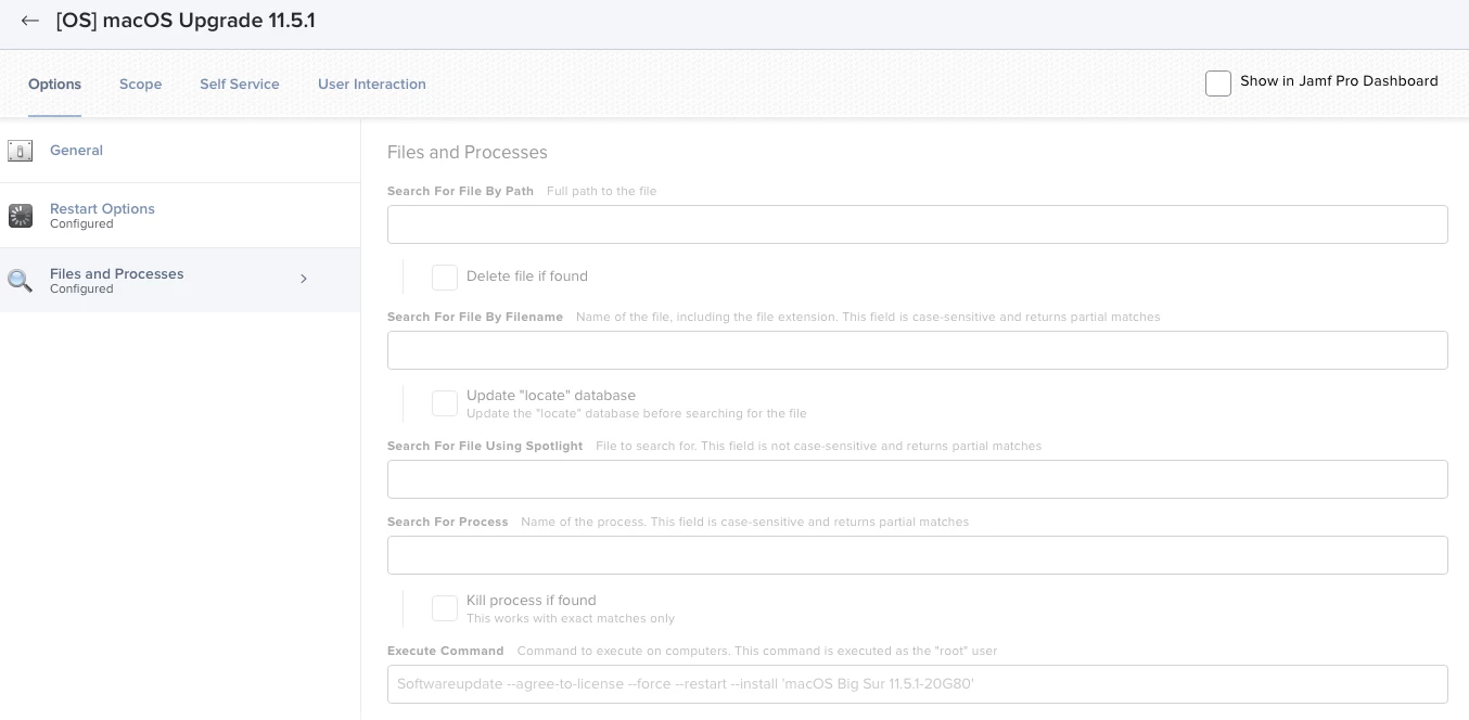

We use Files and Processes and use Self Service as most people are remote
Softwareupdate --agree-to-license --force --restart --install 'macOS Big Sur 11.5.1-20G80'
I considered using this approach but I don't want to reinstall macOS for a minor OS update 11.4>11.5.1 etc. I am starting to test Nudge out and so far it works. For major OS upgrades, I will deploy the OS Upgrades through Self Service.
This did not work for me.
Error message says no such update.
What I ended up doing is a config profile, then a script that prompts the user to Update Now or Delay.. If they choose to "Update Now", it opens the Sys Preferences>Software Update pane and allows them to hit the Update button.. If they choose to Delay, 5 minutes prior to the delay time limit has reached, a 5 minute countdown dialog box runs and opens Sys Preferences>Software Update pane so they can update..
Simple, yet resolves the headache
This would be easy for our org but none of our users have Admin permissions to their computers.

I created a Policy using Self Service
I use Files and Processes (Softwareupdate --agree-to-license --force --restart --install 'macOS Big Sur 11.5.2-20G95') and Restart option.
You can get the software name from Software --list
I haven't had an issue.
Process downloads and installs
This is not working for my test device. It fails with the "No update found" even though the Big Sur update is primed and ready to download in "About Mac>Software Update"
Tried both 11.5.2 and 11.5.1 versions.
