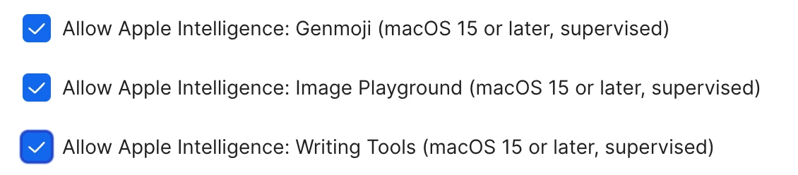

The three ones for macOS are already integrated in the Payload "Restrictions". I guess the other ones will follow soon.

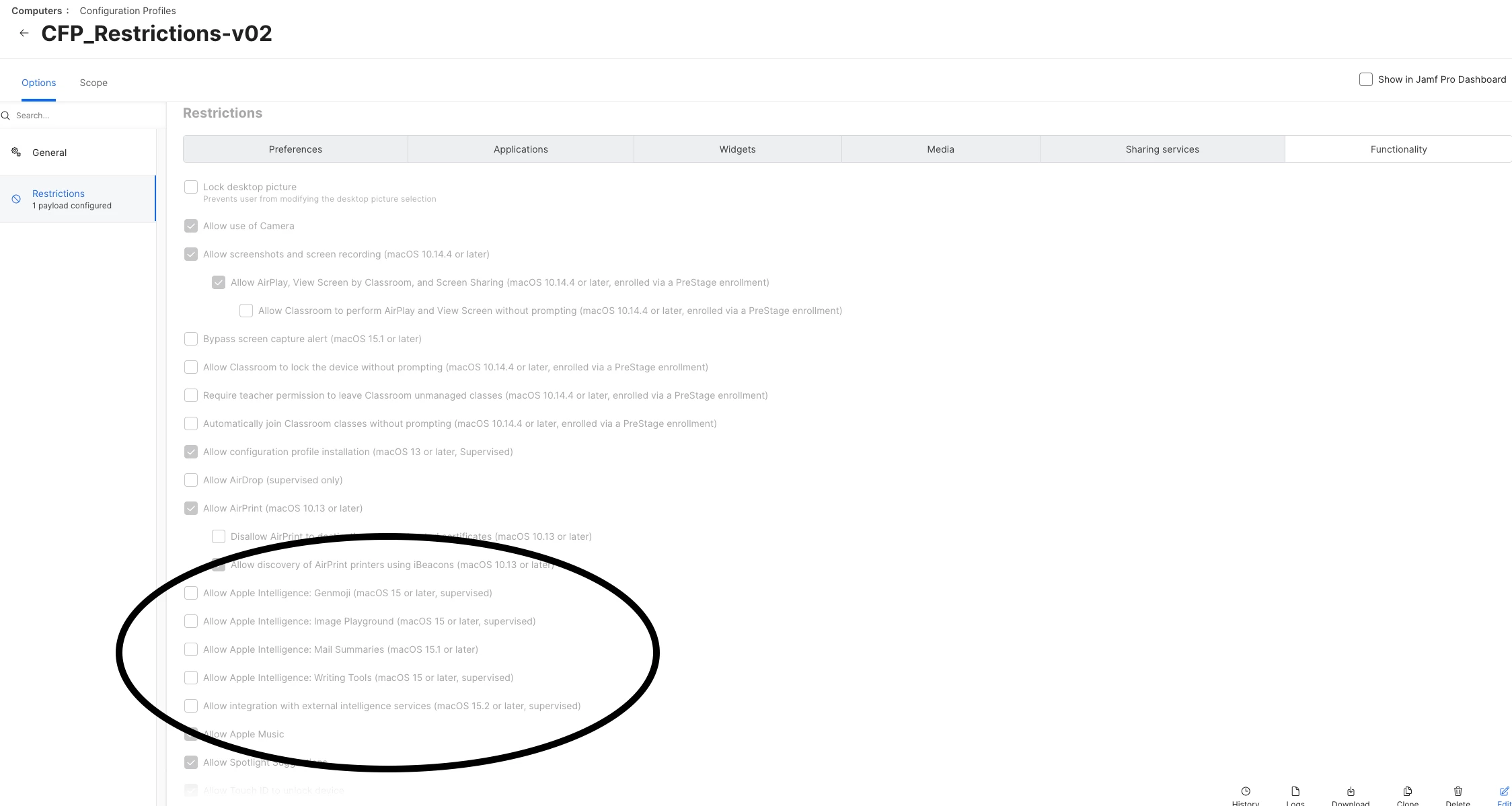

I installed 15.2 Beta 4 on my work mac. I have been instructed on disabling AI on all of our macs. How do i get this configured into Jamf Pro? I found the settings above but it does not disable or remove it from Settings.
  • Dec 12, 2024 9:56 AM UTC
You can deploy a custom payload for com.company.application domain, it should disable all available Apple
Intelligence features:
<?xml version="1.0" encoding="UTF-8"?> <!DOCTYPE plist PUBLIC "-//Apple//DTD PLIST 1.0//EN" "http://www.apple.com/DTDs/PropertyList-1.0.dtd"> <plist version="1.0"> <dict> <key>allowExternalIntelligenceIntegrations</key> <false/> <key>allowExternalIntelligenceIntegrationsSignIn</key> <false/> <key>allowMailSummary</key> <false/> <key>allowGenmoji</key> <false/> <key>allowImagePlayground</key> <false/> <key>allowImageWand</key> <false/> <key>allowWritingTools</key> <false/> </dict> </plist>
azercher

What do I put in for this:
com.company.application?
  • Dec 13, 2024 4:51 PM UTC
com.apple.applicationaccess worked in our testing.

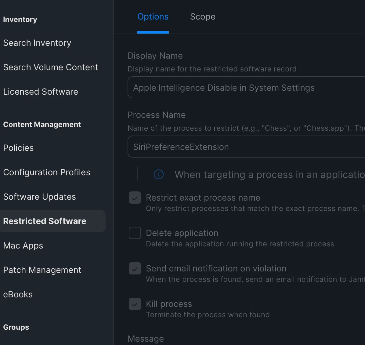

I tried using the above plist and com.apple.applicationaccess, but my test machines still have access. They are scoped correctly so I don't know what's going on. I tried the other method of setting restrictions and unchecking the features, but that didn't work either.
shrisivakumaran
Can we disable Apple Intelligence after it enabled? we have few user where the EA shows Apple Intelligence:Enabled (no Apple Account), how to disable from Jamf?
 Already I set configuration profile to disable Apple Intelligence on all mac.
azercher
  • Dec 18, 2024 1:05 PM UTC
I am having the same problem with my test MacBook pro.
I suspect that once Jamf Pro 11.12 comes out, we will have more advanced options to disable AI. We need to disable AI due to HIPPA compliancy.
mvu
  • Dec 18, 2024 1:14 PM UTC
Where do you still have access? In System Settings?
Do you it configured in Restricted Software?

ianatkinson
  • Jan 13, 2025 9:01 AM UTC
Hi,
Does anyone have a working setup for completely disabling the AI for a lab environment? I've tried the plist from @Rokas above but it doesn't seem to work for us. Students are being presented with the Apple AI setup dialogue on every login (they have no roaming libraries), we basically just want to turn the whole lot off for now.
Ian
BL-ay
  • Jan 13, 2025 9:36 AM UTC
Hi,
Ian
Rokas' plist should work, but all Apple intelligence features are automatically enabled by default in the Restriction Configuration profiles as soon as they are available. You must also uncheck the boxes, otherwise it will be reactivated. Did you check on it?
I don't like the way, Jamf design the restriction profile.
Make sure that only one restriction profile is assigned to a Mac.
Unfortunately, several restriction profiles don't build on each other, but it is rather a gamble which restrictions will work in the end.

And make sure you also have it restricted in jamf GUI profiles as now they introduced it, so my custom profile is not mandatory to use.
  • Jan 17, 2025 4:17 PM UTC
Ah .. I'm not sure I do have a restrictions profile I didn't realise I needed that on top! If I remember right that's the one that sets up pages and pages of settings so I think I've always avoided it, looks like it's time to go through it thank you
I would love to know if you have had success with this. I'm in a similar situation: setting up a new Sequoia lab and the AI popup (and "Welcome to Mac" screen) at every login is not ideal.
Actually I may have figured this out while typing this reply: If you don't have success with the restrictions profile, check your Prestage Enrollment for the lab Macs. Make sure the Intelligence box is checked (so the setup pane is skipped) under Setup Assistant Options.
