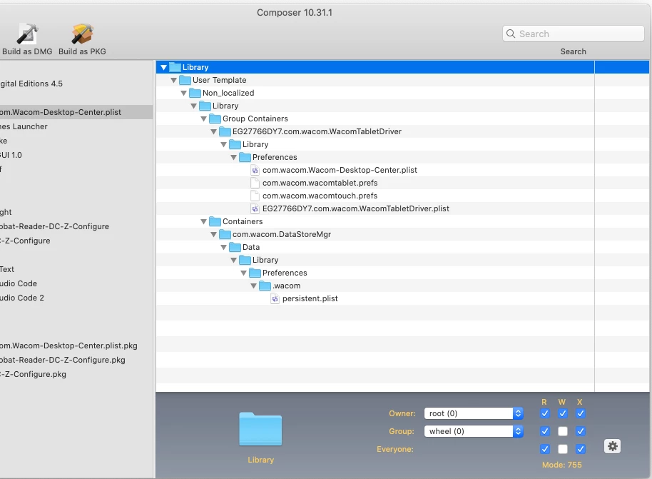

This is working for me.
Steps:
Install the Wacom Tablet Driver PKG. (Additional - Use the Jamf PPPC Utility to add the tablet driver to the Input Monitoring section by selecting - 'Allow standard users to approve access'. This will get rid of the driver security error prompt every 15 seconds or so.)
Configure Wacom Desktop Center how you want it to be i.e. Untick AutoStart and click OK on the Customer Experience button without the opt-in button ticked (default setting).
Open Finder and navigate to /Library/User Template/Non_localized/ and drag the Library folder listed there over to Composer, as in above screenshot.
Now navigate to the 2 file locations above in your User Profile hidden 'Library' folder (GO Menu / Hold ALT or Option Key to show hidden Library folder).
The .wacom folder wont appear unless you press SHIFT + Command + . in Finder to show hidden system files.
Drag the five files listed above over to the main Composer window (make sure the folder paths are the same as above.) You'll have to move the 'Group Containers' and 'Containers' folders from your User Profile 'Library' folder path to the Default User Template 'Library' folder path. Then delete the remaining parent folders listed from your User Profile.
(Clear as mud I know. Look at the screenshot above and make sure your folder paths are the same as mine.)
Once all that's done, you need to adjust the file and folder permissions before building the package.
Select the Library folder at the top
Folders - Root : Wheel : 755
Files - : Root : Wheel : 644
Cog Icon (Bottom right)
Apply Permissions to Library and All Enclosed Items
This will set everything to 755, for folders and files.
Apply Owner and Group to Library and All Enclosed Items.
This will set everything to Root : Wheel, for folders and files.
Be sure to change the file permissions afterwards to 644
Click Build as PKG (Choose save location.)
Steps:
If you want to turn off Wacom Desktop Center notifications - the bundle ID is com.wacom.Wacom-Desktop-Center

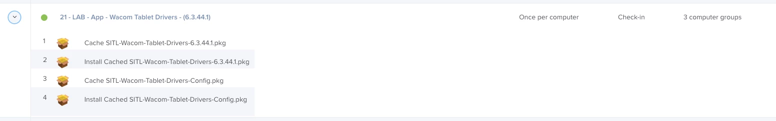

Thank you for this write-up. Took quite a while to get it exactly like yours, but I finally did it.
How did you deploy the preferences.pkg with the driver.pkg? Preferences needs to run after the driver gets installed I would imagine. I don't need to fill user templates or anything for the preferences? (Think that's only for .dmg's).
I ran the preferences.pkg on my machine that has Wacom drivers installed to test. I checked auto-start in the desktop center, then closed the app. Ran the preferences.pkg after, then launched the desktop center again and auto start was still checked.
