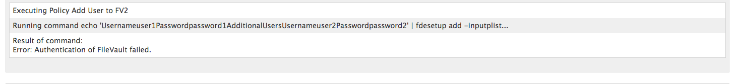

  • May 18, 2017
Under 10.12.5: Anyone seeing Running command echo "<plist><dict><key>Username</key><string>want2beadded</string><key>Password</key><string>secretpw</string></dict></plist>" | fdesetup add -inputplist...
Result of command:
Error: No users were specified. Use -usertoadd to specify a user.
Thank you
  • 122 replies
  • May 18, 2017
Sorry! My bad: Somehow forgot the second part of the command...
Hi, I'm trying to run this on 10.12.6 but it keeps stating it needs root access. Is there an updated version of this script? What would I need to change if it is a version issue?
any help appreciated, cheers.
the command is corrected, use this:
echo "<plist><dict><key>Username</key><string>user1</string><key>Password</key><string>password1</string><key>AdditionalUsers</key><array><dict><key>Username</key><string>user2</string><key>Password</key><string>password2</string></dict></array></dict></plist>" | fdesetup enable -inputplist
