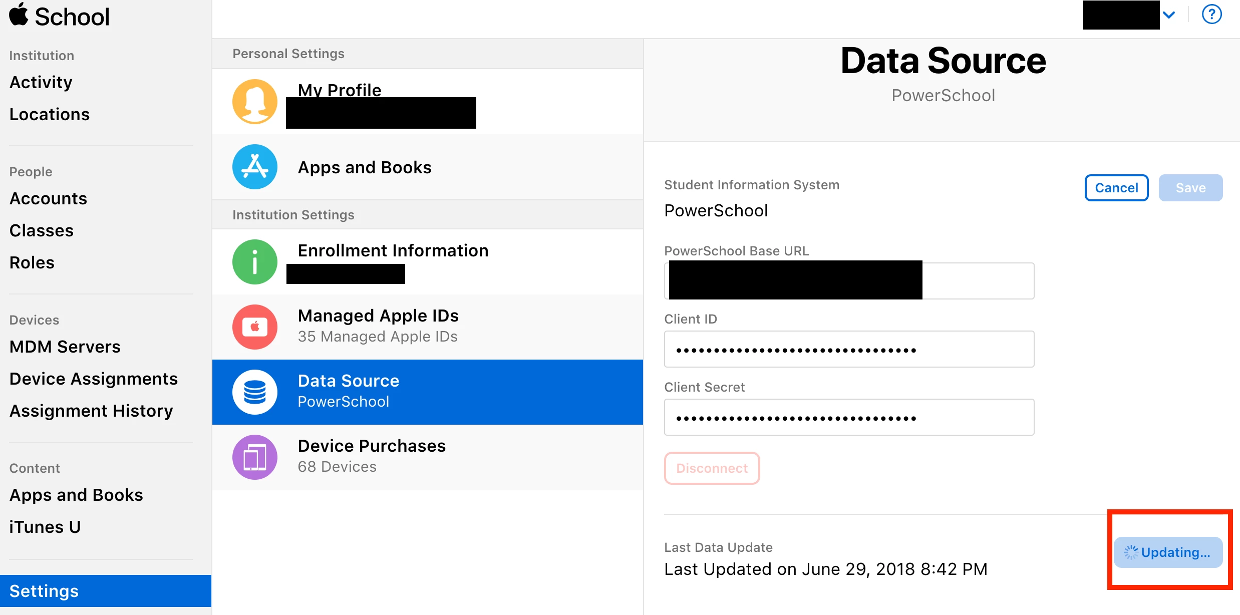

Kelly_Conrad
I'm helping an organization connect PowerSchool to Apple School Manager, however, said organization is in a remote area with extremely spotty internet. I started the sync to PowerSchool, however, our internet was dropped when I started and now it seems to be stuck in an "updating" loop, even though I disabled the Apple School Manager plugin on PowerSchool.
I am not able to disconnect within Apple School Manager as it keeps constantly updating, and I can't disconnect when it does that. I am hoping to get an idea within the next 24 hours as I am leaving the area soon and wanted to get this sorted out while I'm there.
Has anyone encountered this before?
Thanks Jamf Nation :)

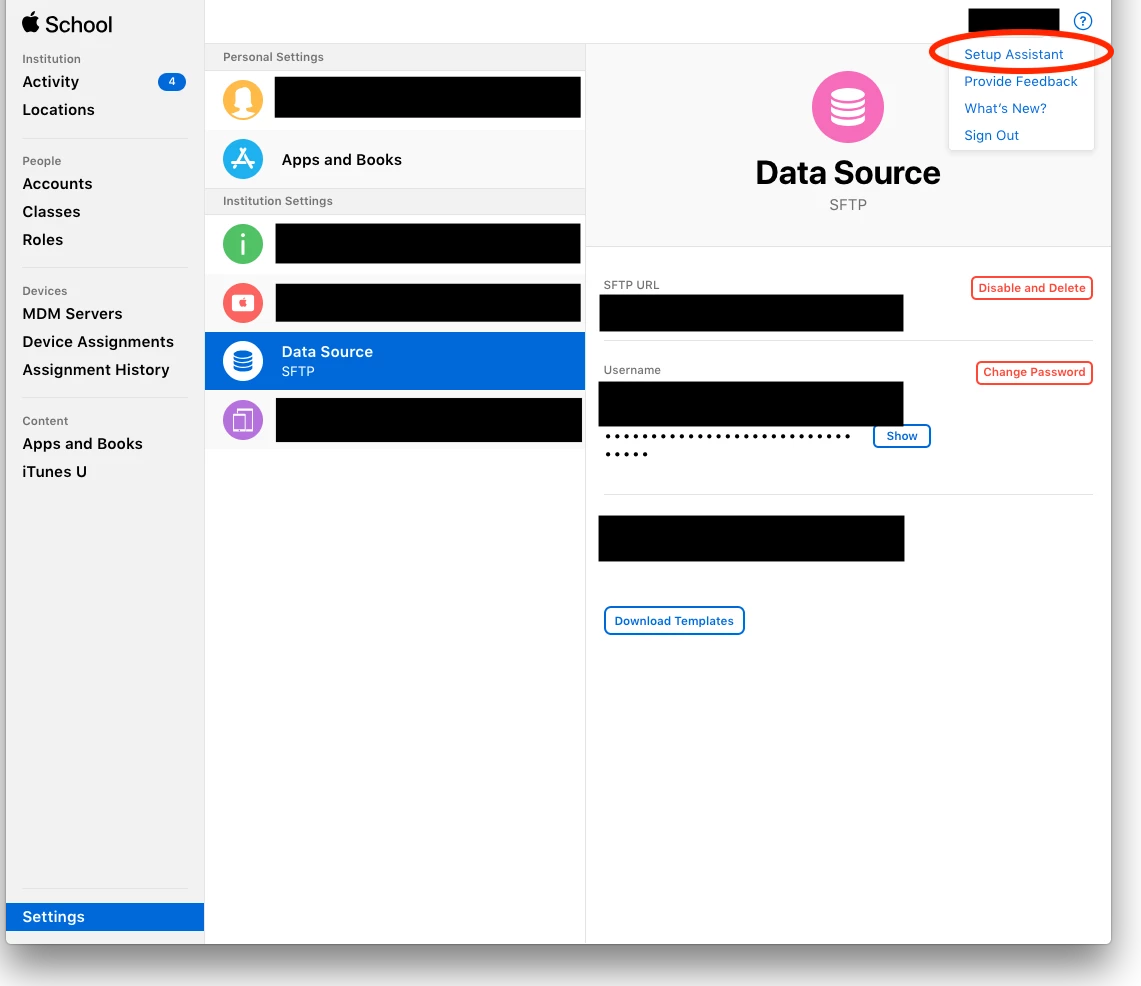

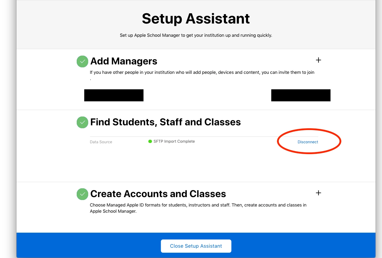

Hi Kelly, Not sure if this works for SIS as a data source. However, did you try going back to Setup Assistant in ASM and disconnecting the data source straight from there?

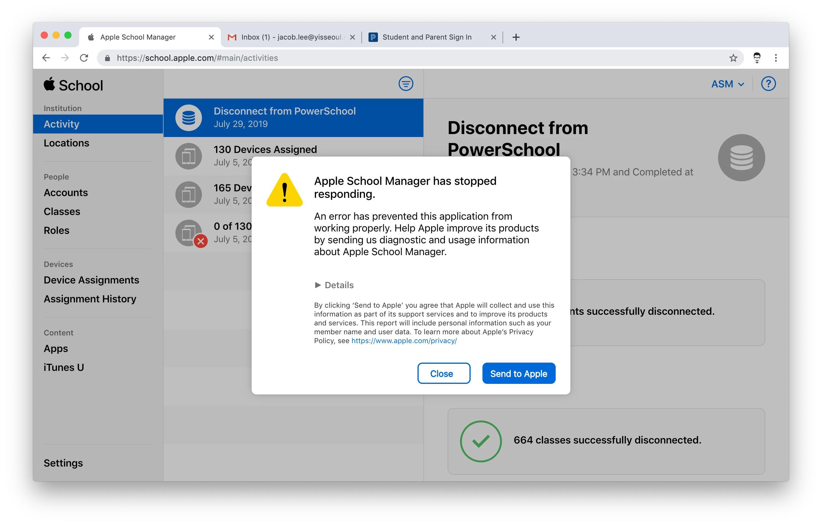

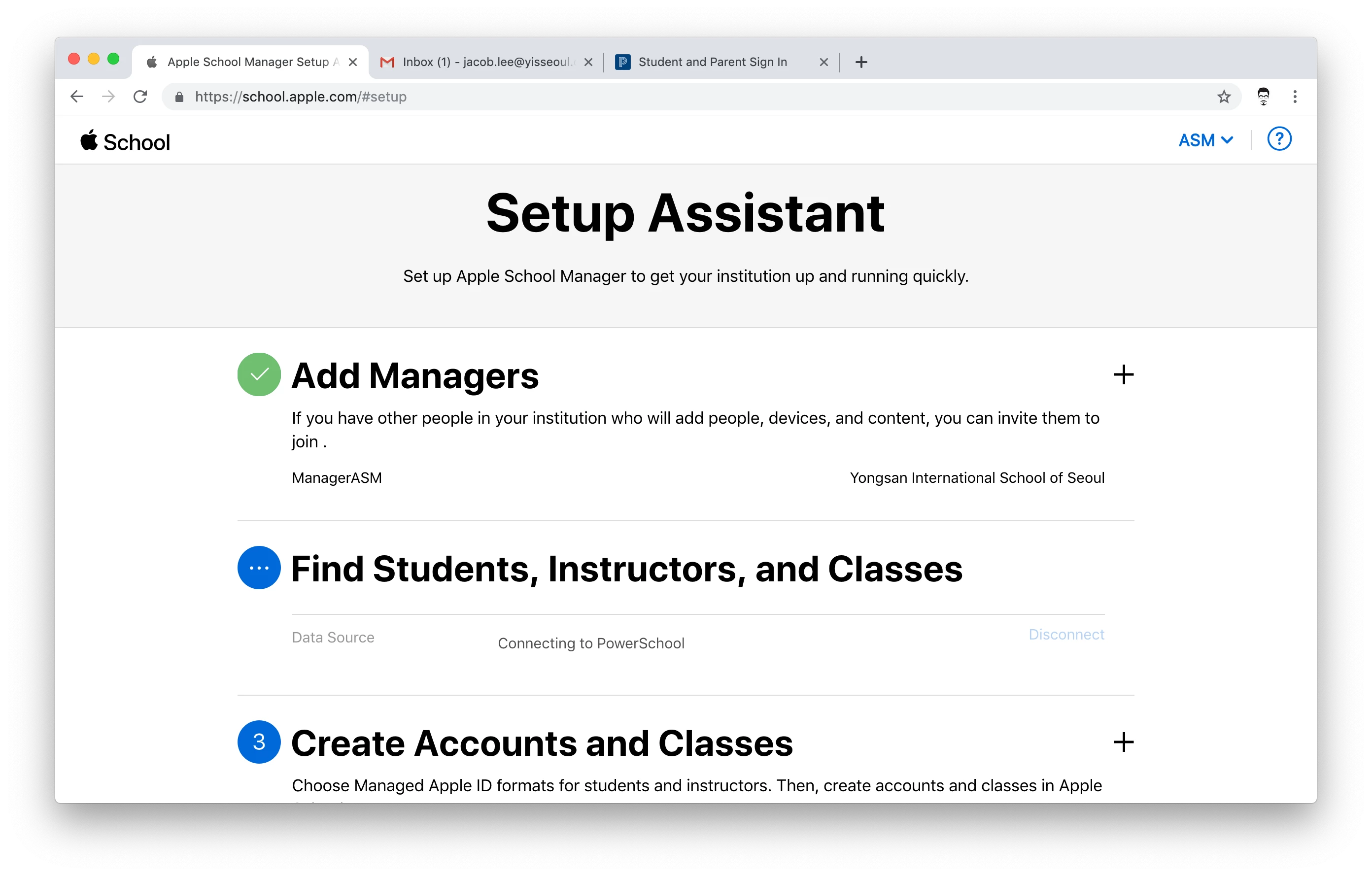

  • July 30, 2019
Hi there,
We are struggling to re-connect SIS(PowerSchool) in ASM. We have lately realized that PowerSchool may pause syncing while summer break but thought it probably starts syncing once it's disconnected AND reconnected. That was the mistake..
Disconnection was successfully done but re-connection won't work at all. It continued to fail with a message (that I didn't screenshot),
Check the PowerSchool URL is accurate or is working fine. And then try once again.
Now it is stuck in Connecting to PowerSchool and shows the message Apple School Manager has stopped responding.
Are we missing something? All we need is to reconnect the SIS info into ASM to import user and class info to MDM.
