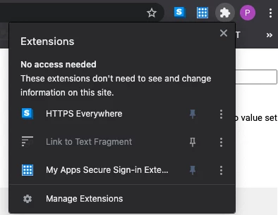

I have seen various people struggling with this, some claiming it's not possible and Chromium documentation on this particular policy isn't straight forward so here we go...
Based on Google Chrome documentation for the policy "ExtensionSettings".
The following assumes you've already got the application you'll be pinning installed either via other Chrome policies (E.g. ExtensionInstallForcelist) or manually installed.
See the below image what the end result looks like - Pinned chrome extensions (HTTPS Everywhere + MyApps) which can't be unpinned by end-users.

  • Mar 3, 2021 6:46 PM UTC
Troubleshooting: Head to chrome://policy/ to view the Chrome policy logs and review any error messages.
