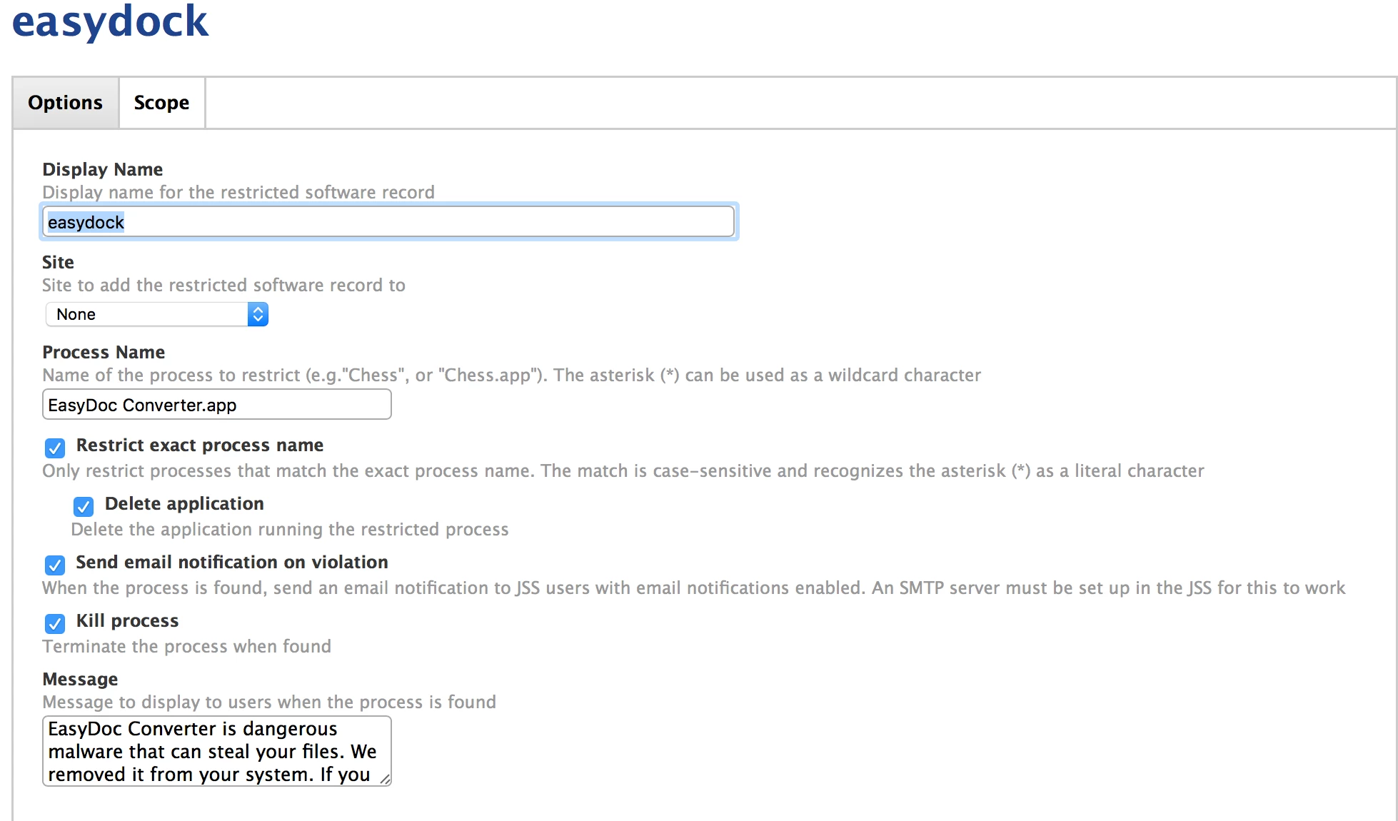

Does anyone know what I need to put in restricted softwares to prevent the 2 new macOS malwares from running?
OSX.Backdoor.Eleanor
OSX.Keydnap
7 replies
Forum|alt.badge.img+15
  • July 13, 2016
Below is a screen shot of the restriction I put in

Are we 100% sure that the process is EasyDoc Converter.app?
I wasn't able to find the app to test myself : )

For something like this, if you plan on using Restricted Software, I recommend trying to get the actual executable name and not the app bundle name, and putting that into Restricted Software. Using the app bundle name is not very reliable, because the malware writer or even a person could easily rename it before running it, and your Restricted Software process will miss it since its looking for the bundle name.
