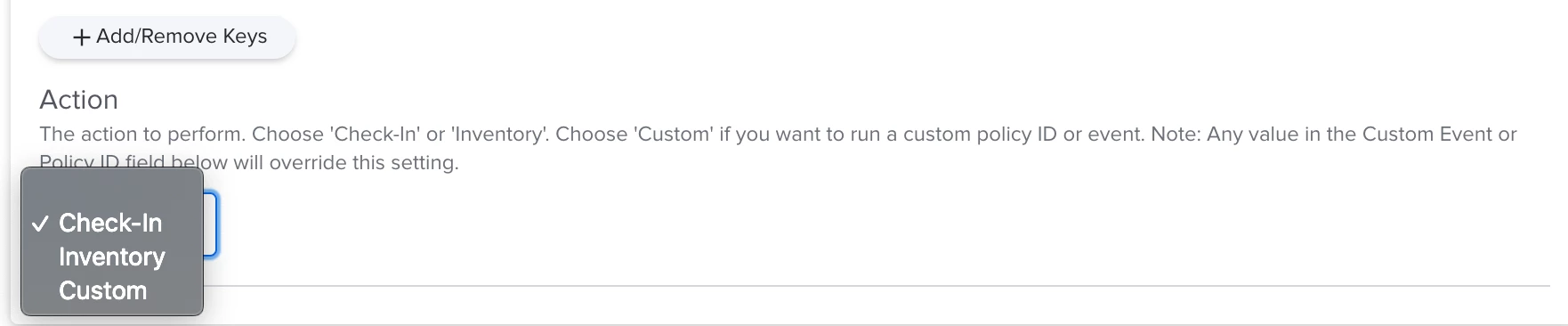

Yeah for sure. I would never have it just run anything passed to the LaunchDaemon. As you said, unsafe. The Config Profile has canned options in it so you can only choose from a few preset items, like Check-in, Inventory & Custom. The script itself is only programmed to look for specific responses in the profile plist to respond to.
Here is what part of the Profile looks like:

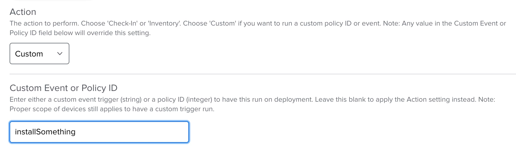

If I choose Custom from the drop down, there is another option below to enter a policy ID or custom event trigger.
Of course, the script itself would be vulnerable to being overwritten with malicious code I suppose, but if any software/malware can overwrite the script, which I place in an admin level location, then it can do other things on the Mac as admin/root as well, so that would be the least of my concerns.
