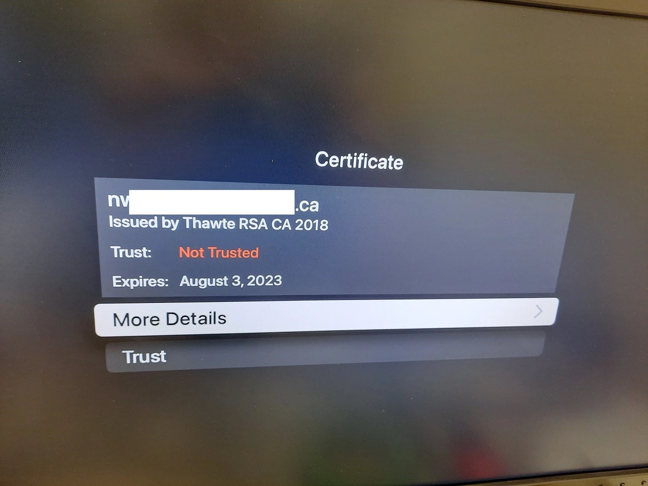

  • January 18, 2023
So i am having the same problem. I can push the certificate (and root cert, and intermediate cert) and they are on my device (in this case an appletv). But still the user is prompted to "trust" the certificate when i am connecting to wireless. How the heck do i make it trusted? there is no setting i can see in the certificate area of config profiles.
Im going to do some more research. These are valid 3rd party certificates from THAWTE. Digicert is the global root. Of course these should be trusted out of the box, but at least if i pushed all the certs one would think that it would work and not prompt for trusting every time!!!!
It also re prompts you again to trust if you forget network and re add it. So its really not remembering the trust you told it to do in any sense.
