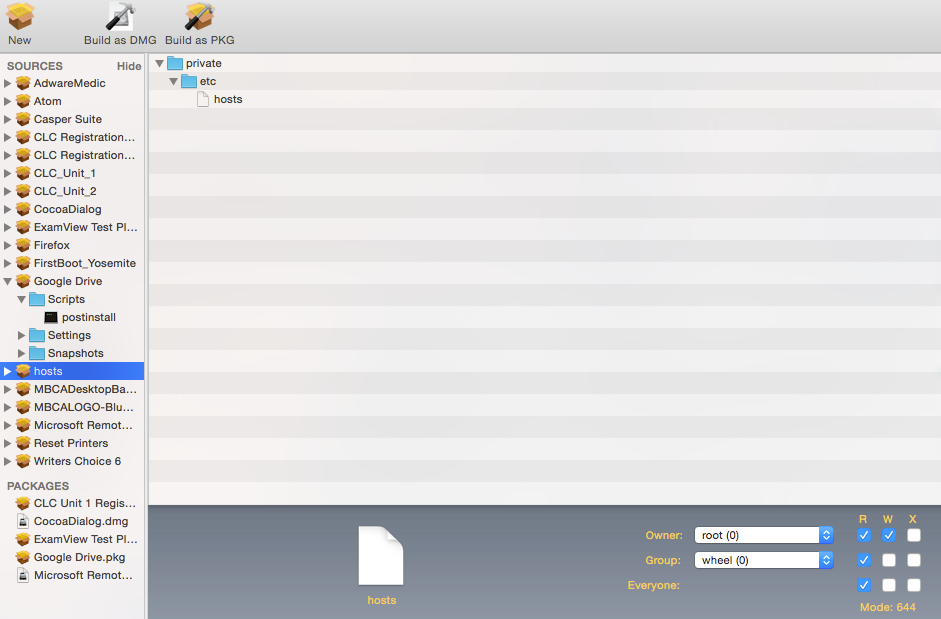

I've done it with Composer, but quickly turned to scripting like davidacland says. The problem with using Composer is you have to redeploy the Hosts every time you make a change, which can get cumbersome, particularly if different users require different hosts configurations. Much easier to manage by adding a line here or there with a script. Still, below is a screenshot of my Composer with hosts. Create your hosts file in vim and copy over to Composer like any other file.
