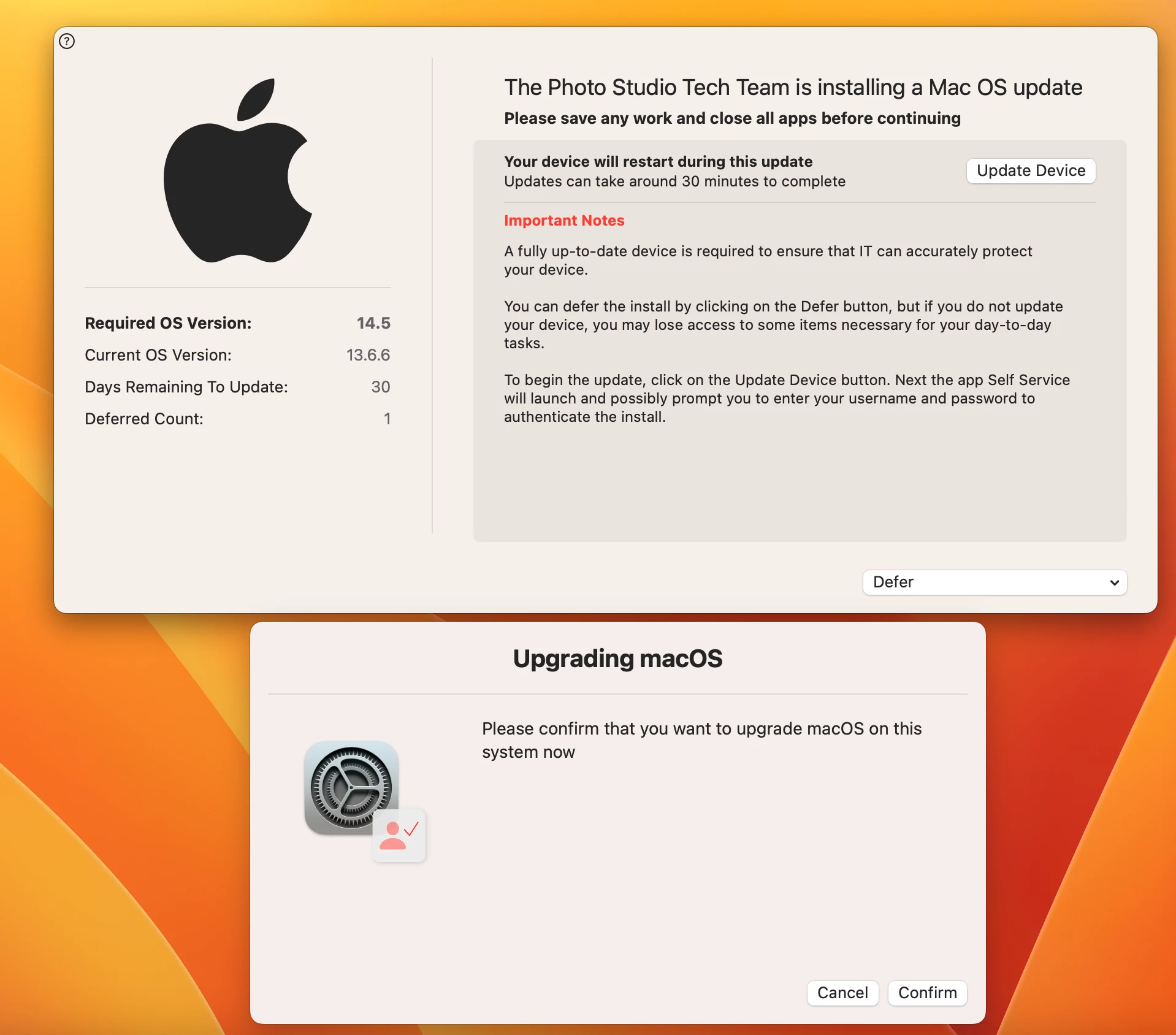

The erase-install script creates its own display alert windows. I appreciate the alerts to download the installer and ask for credentials, but the last window starts to compete with the classic Nudge window. I think this will cause some confusion with my users.
