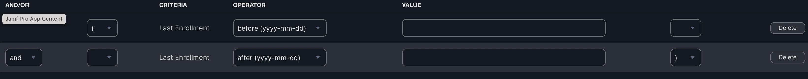

Best answer by _gsm
Can you refine the criteria to exclude the additional unwanted states from the Smart Group? (“State is not X” and “state is not Y”)?
This is for last enrollment but for example.
4 replies
  • Sep 17, 2026 12:30 PM UTC
