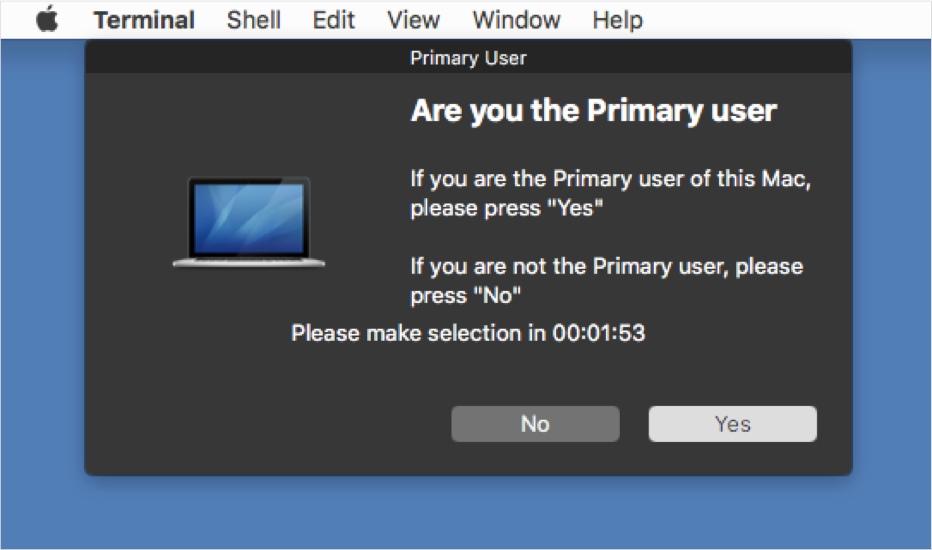

Value 2 - Primary User
The Primary User is identified as being the most frequent logged in user in a 14 login scope.
So if User 1 has logged in 4 times and User 2 has logged in 10 times. User 2 becomes the Primary User.
There are some exceptions to this. root, admin, _mbsetupuser and our local support account, among others, is never set as the Primary User.
For this value I use the Username field in the computer record in Jamf Pro.
All the usernames are stored in a SQLite db at /Library/Receipts/ASSETusers.db
Script - Auto - Assetmgm - 01 - Primary User

This will update the Username field in the Jamf Pro. Jamf Pro will then make sure to get the user information from AD. This is then synced with Asset mgm.
If you have internal accounts you wish to ignore add them to the array in the tableCreate() function.

responsibleUserOrNot() {
# Query the user if they are the primary user of the Mac
# Variables to build HUD notification
_JH_ARGS_=(
    -windowType hud
    -title "Responsible User"
    -heading "RESPONSIBLE USER"
    -icon "$_MODELICON_"
    -windowPosition ul
    -alignHeading left
    -button1 "Yes"
    -button2 "No"
    -defaultButton 1
    -cancelButton 2
    -timeout 120
    -countdown
    -lockHUD
    -description
_INTERNALMESSAGE_="Are you responsible this Mac, please press "Yes"
You will be registered in Assyst as being the owner of this Mac.
If you are not responsible for this Mac, please press "No""
_EXTERNALMESSAGE_="Is ""$_MANAGER_"" responsible this Mac, please press "Yes"
# Identify which message to display
if [[ "$_USERSTAT_" == INTERNAL ]];
then
    _MESSAGE_="$_INTERNALMESSAGE_"
else
    _MESSAGE_="$_EXTERNALMESSAGE_"
# Prompt user
"$_JAMFHELPER_" "${_JH_ARGS_[@]}" "$_MESSAGE_" > /dev/null
# If they select "No" they will be added to the Ignore table of the ASSETuser.db not be queried again
if [[ "$?" == "2" ]];
then
    $_ECHO_ "$(timestamp): $_LOGGEDINUSER_" "added to ignore List... Exiting"
    $_SQLITE_ $_DB_ "INSERT INTO '$_IGNORETABLE_' (user) VALUES ('$_LOGGEDINUSER_');"
    exit $?

The criteria to be prompted is, you are the Primary User of the Mac and have logged in at least 3 times.
If they ansver Yes and are internal employees they get added in the ASSETUser.db and the EA in Jamf Pro is updated. Then synced with Asset mgm.
If they answer Yes and are external consultant/Freelancer, they get added in the ASSETUser.db. It then does a AD lookup to identify the manager responsible. They then get adde to the EA in Jamf pro.
If they answer No. they get added to the ignore table and are not prompted again. unless they afterwards have 10 consecutive logins. Then they get registered as Owner anyway.
