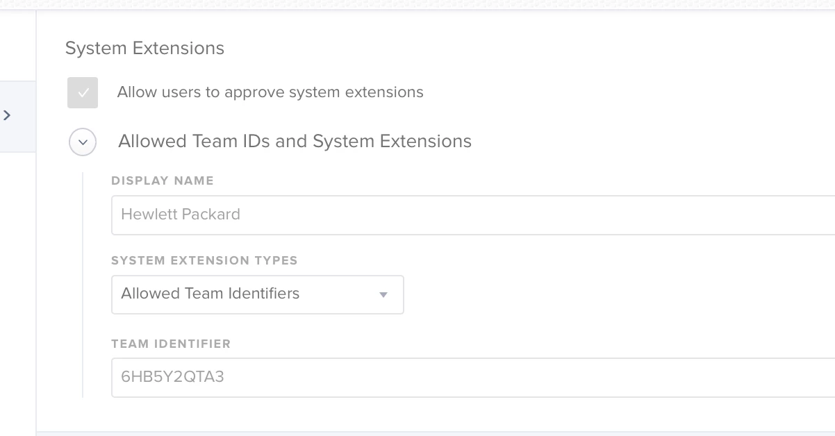

Hi,
I am working on new laptop deployment with DEP, Catalina, trying to reduce clicks and suppress all confusing popups :)
I have a Config Profile with third party extensions and team IDs including the only one I have found for HP.
I also have the box checked to allow users to approve System Extensions in that profile.
I have hp-printer-essentials-S-5_14_6 installing at enrollment and it is asking for approval and a regular user cannot approve. The Kext config profile is installed. The other interesting thing is that there are HP drivers installed so it looks like it installed despite the need for approval button...

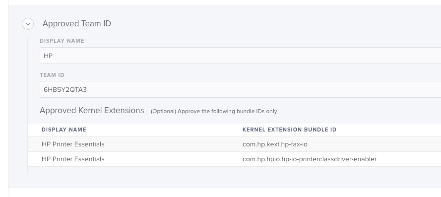

Does your Approved Kernel Extensions look like this?
  • December 20, 2019
@cbrewer
I did not include optional bundle IDs. D
o you think that would fix this?
Forum|alt.badge.img+15
  • December 20, 2019
According to documentation, no, you shouldn't need Bundle ID's. But I prefer only allowing what you must.
  • December 20, 2019
So then adding Bundle IDs would be more limiting, and unlikely to fix this issue (though a good idea :)
  • December 20, 2019
I'm installing that same package via policy without issue but typically when it's installed no user is currently logged in.
  • December 2, 2020
Only found this page after figuring out myself but landed on the same solution as @cbrewer.
Shouldn't have any issues with the latest "Essential Drivers" from HP Easy Admin and the Approved Kernel Extensions:
com.hp.kext.hp-fax-io
com.hp.hpio.hp-io-printerclassdriver-enabler
Team ID: 6HB5Y2QTA3

Looks like you are talking about 2 things here: Kernel Extensions and System Extensions here.
